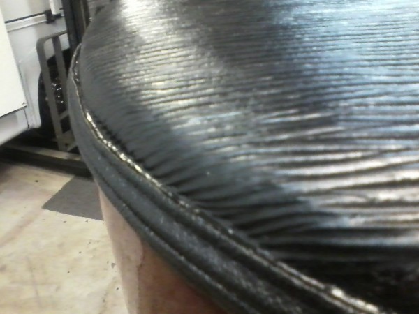

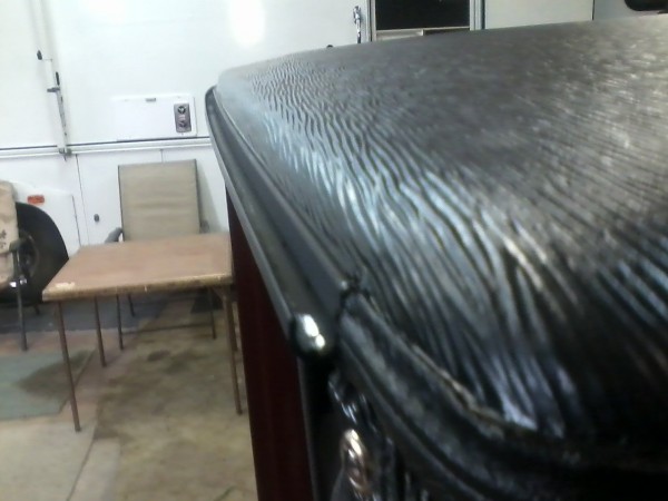

On the tops I've done I don't use any sealer under the top wood. I do however use a polyurethane sealer under the cobra grain. Loctite roof and flashing sealer works perfect and blends right in with the cobra grain. I also use the Loctite under the rain gutters and the hidem trim. It cleans up nicely with mineral spirits so you can get a tight seal all the way around the top.

While that top installation looks great, most of the evidence points to fold over welting being used, not hide-em. Minor detail, but thought you might like to know.
