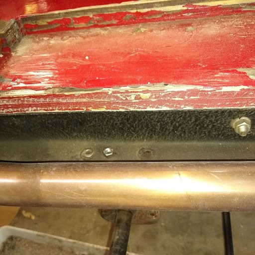

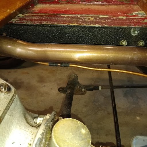

Took my car for a ride. Oil, water, and gas are good. Pulled up to the garage to put it away. She quit on me. I tried to crank her and she was in gear. Makes no sense, right? No matter where the brake lever is, she is in gear. Pushed her into the garage and now I have to start tearing her apart. Good thing I have another car, so I can still enjoy the summer.
Now I have a project for the winter. Any thoughts?

Adam Doleshal hit it on the head. He said do not make it difficult. Diagnose the problem. He told me to check the outside linkage. Maybe if I had removed the floor boards first and then gone on the forum I would have seen how simple the fix was.
I was thinking I was going to have to pull the engine and work on the transmission.
Two bolts loosened up and there went my control. Adam also reminded me to go over the whole car every
year and check all the nuts and bolts. Maybe I would have seen this earlier.
Thanks again for your help.

If the bolts holding the control shaft mounts are long enough, you can use lock washers but also double nut them and tighten them good with 2 wrenches.
