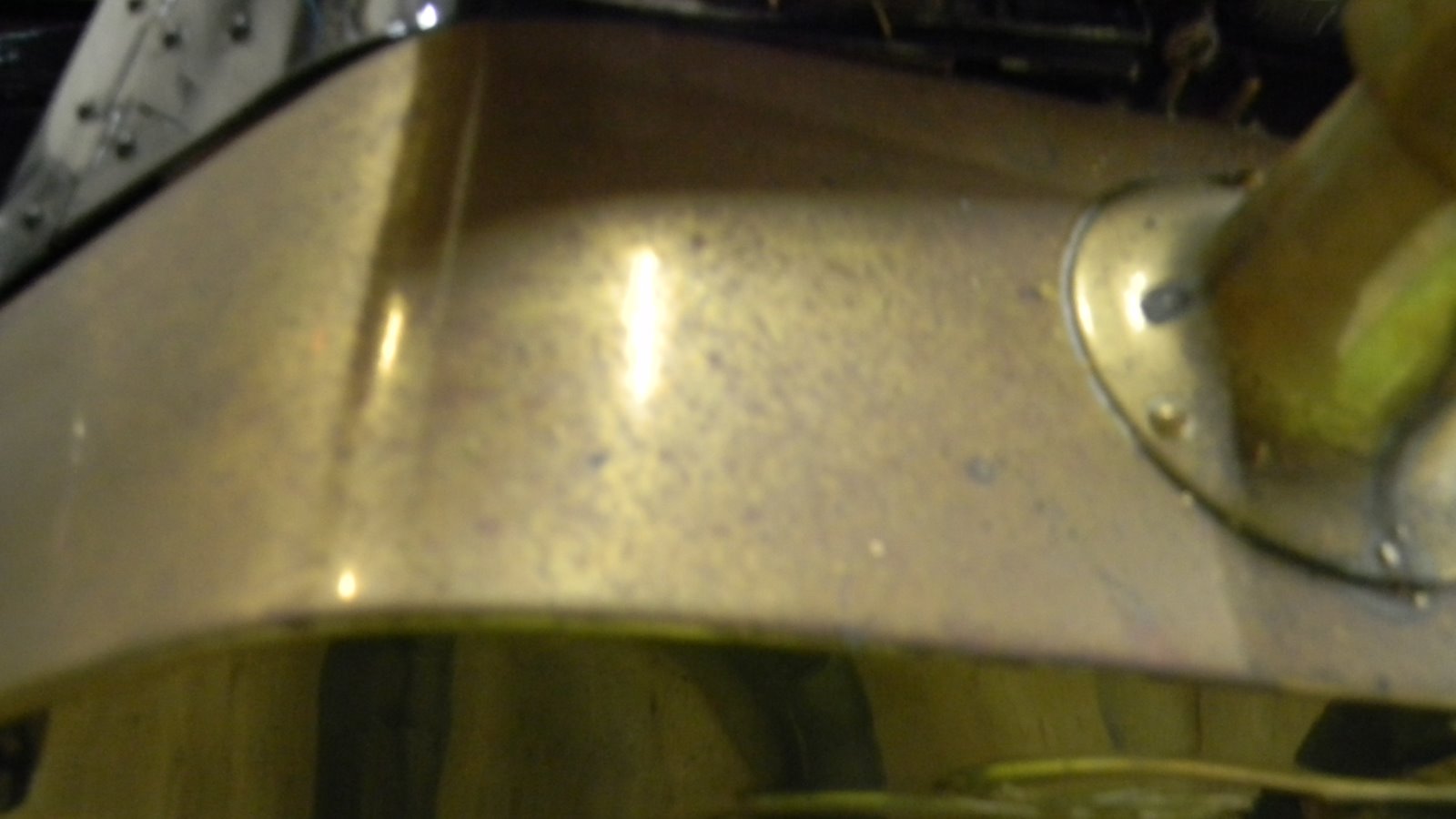

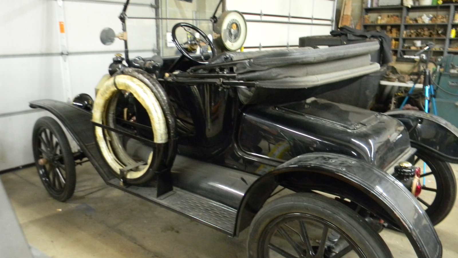

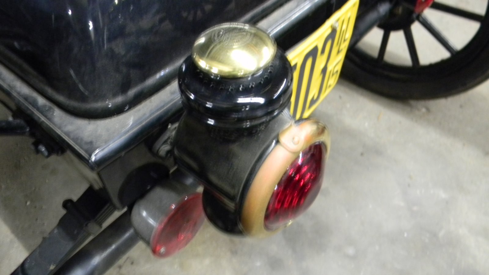

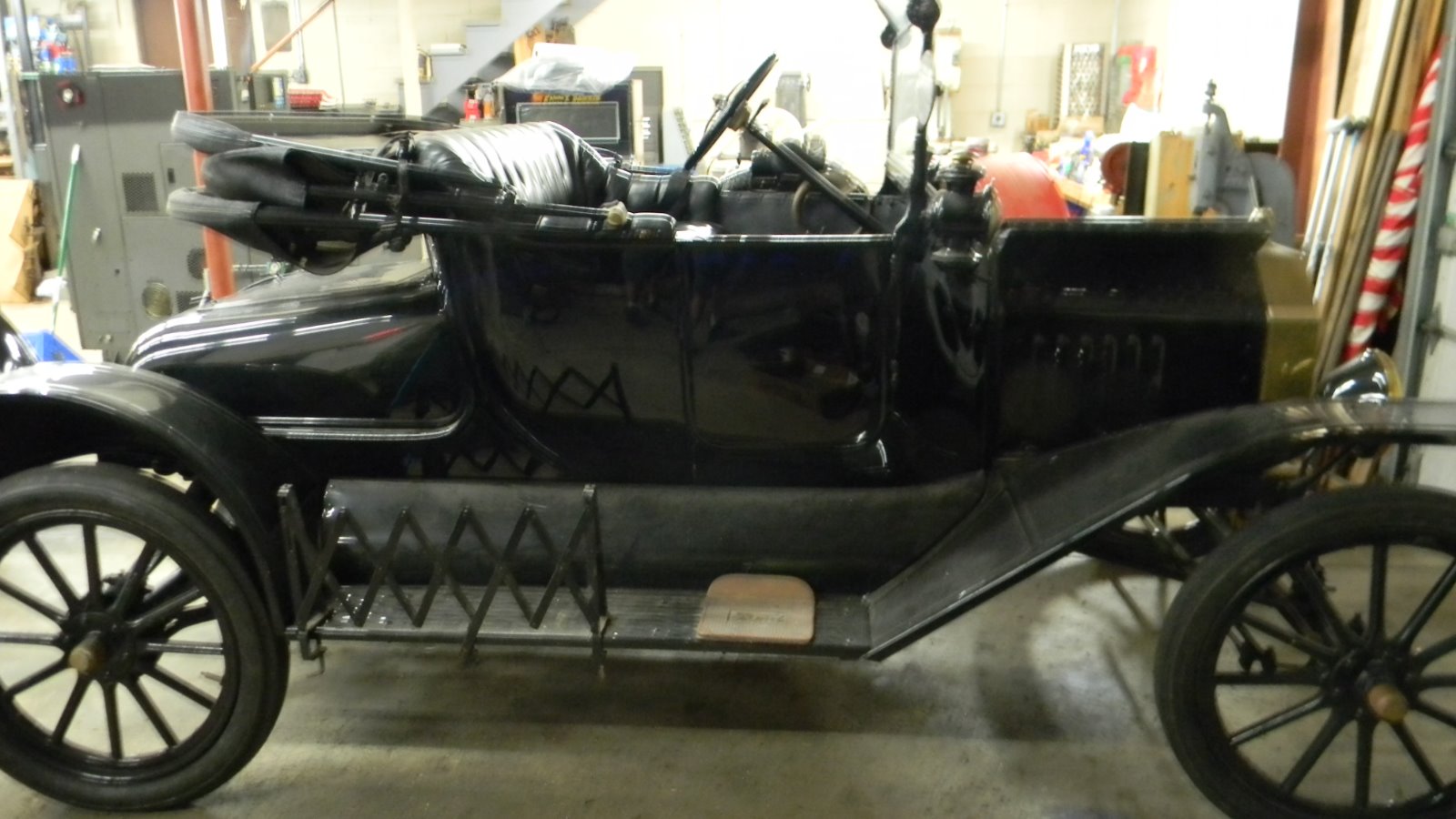

How to tell if lacquer was applied to a brass radiator
I have a very nice 1915 roadster that I will be selling for a family friend who passed away a while back, starting to polish the brass all the lamps and other items seem to clean up great but the radiator seems like the more I polish nothing seems to work, I have no idea if it was lacquered or not, nothing is peeling off, it might be just stubborn brass, any ideas? Bob

Lacquer thinner. Rub an inconspicuous spot with it, then see if the polish works there.

Re: How to tell if lacquer was applied to a brass radiator
It looks lacquered to me. I agree with Jeff

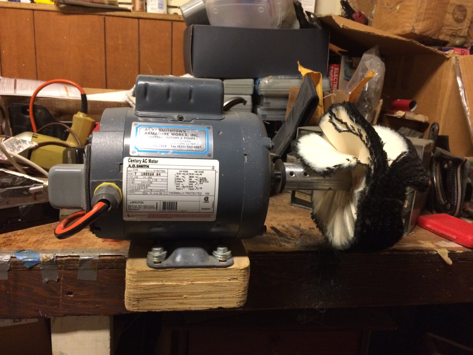

The ten-year-old, shiny brass doorknob on my front door tells me that for certain applications, lacquering brass makes sense. Where it doesn't make sense is on a brass item which generates considerable heat, such as a brass radiator, acetylene headlamps and kerosene lanterns. That kind is heat is the enemy of lacquer (You also don't want to apply wax because heat causes it to fog over and go dull. Therefore, avoid any kind of polish that contains wax). You can get away with lacquering your brass ahooga horn, your brass rear-view mirrors, brass buckles, hubcaps, etc., because they don't generate high temperatures.
The whole point of lacquer, of course, is to avoid the necessity of hand polishing. I hate polishing too, which is why I have a soft, whirling polishing pad on my bench grinder. I dismount anything that can be unbolted from the car and let my bench polisher do the work for me. For the radiator, I use a cheapie, 6" orbital polisher ($19 at Harbor Freight). Letting the electric polishers provide the elbow grease makes for a much easier polishing job. Your arms, shoulders and back will thank you for it.

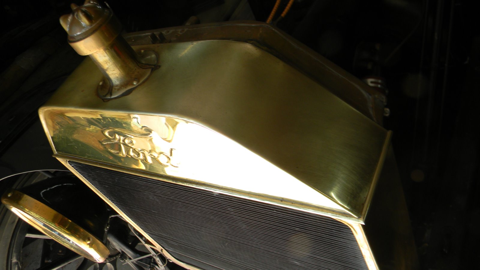

Looks laquered to me, too. (The speckley finish is what says that to me...). My dad's 15 roadster (the one I took my driving test in
) had a lacquered radiator that looked just like that.
Safest way to do it is take the radiator off (not hard to do) to protect the paint on the car, use lacquer thinner or acetone to remove the lacquer (may need to use steel wool, DEFINITELY need to wear gloves!!), repolish the radiator using a buffer, and reinstall.

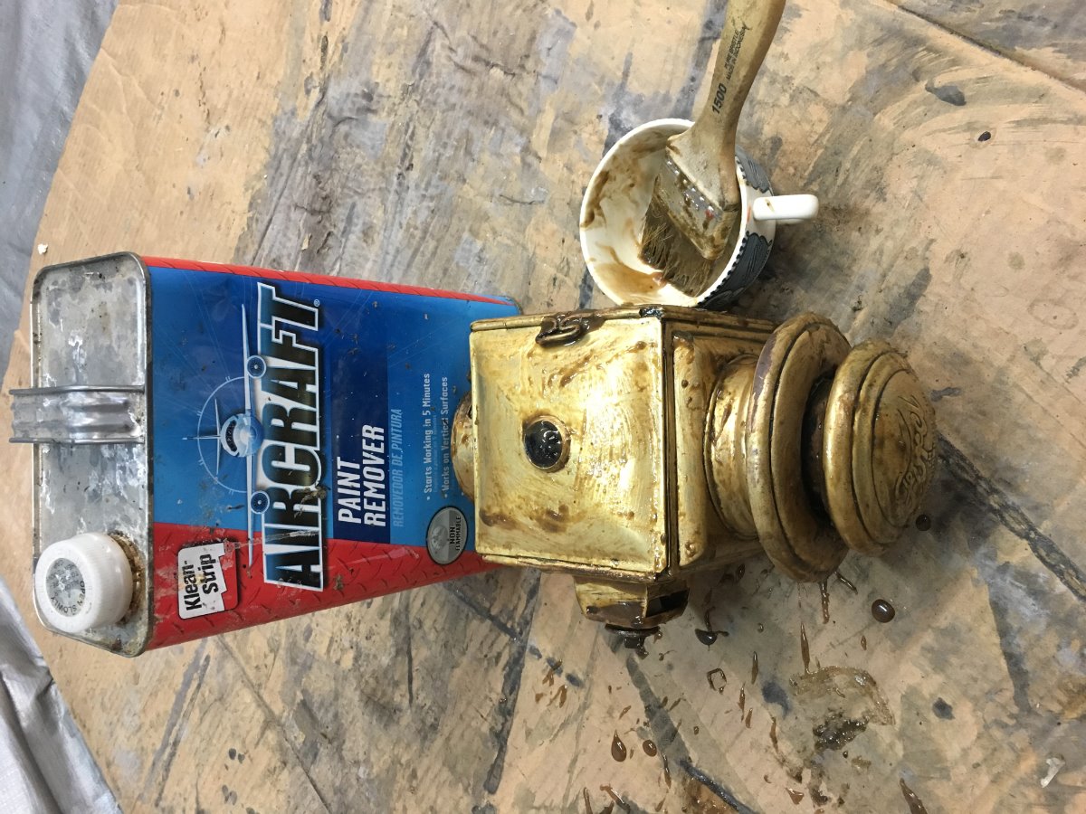

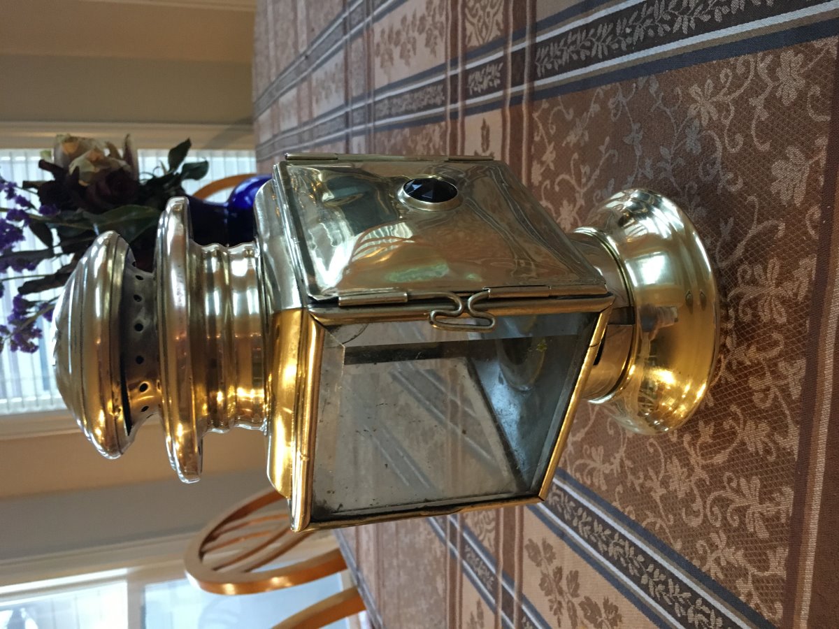

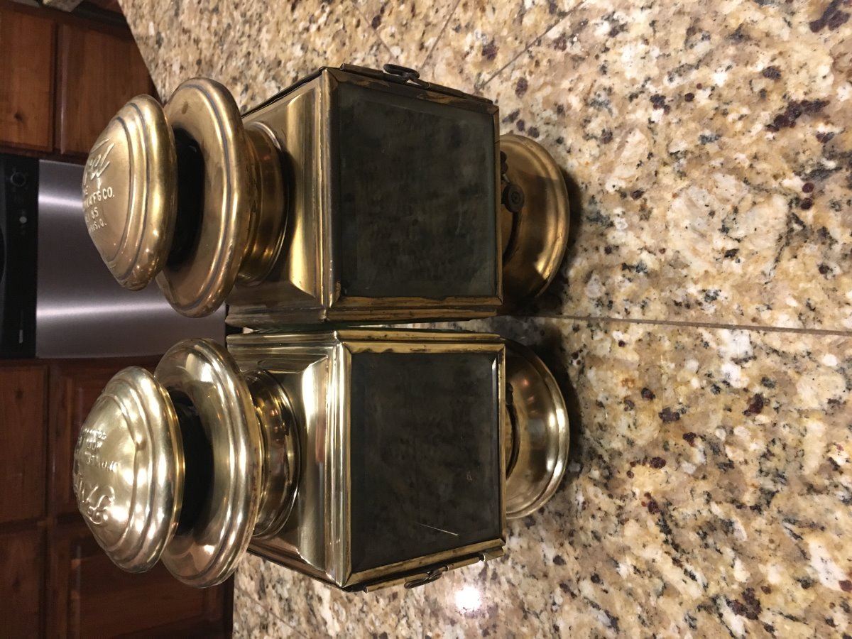

I used Aircraft paint remover on these lights, took if off in seconds and washed off with water. The one on the top is uncleaned the bottom with the clear whatever removed, then I later polished them up nicely.
Regards,

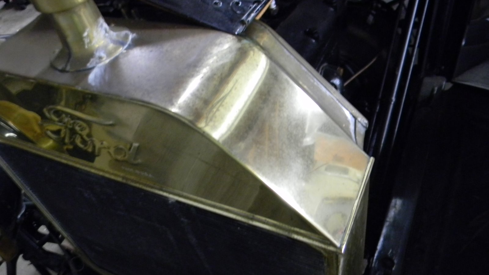

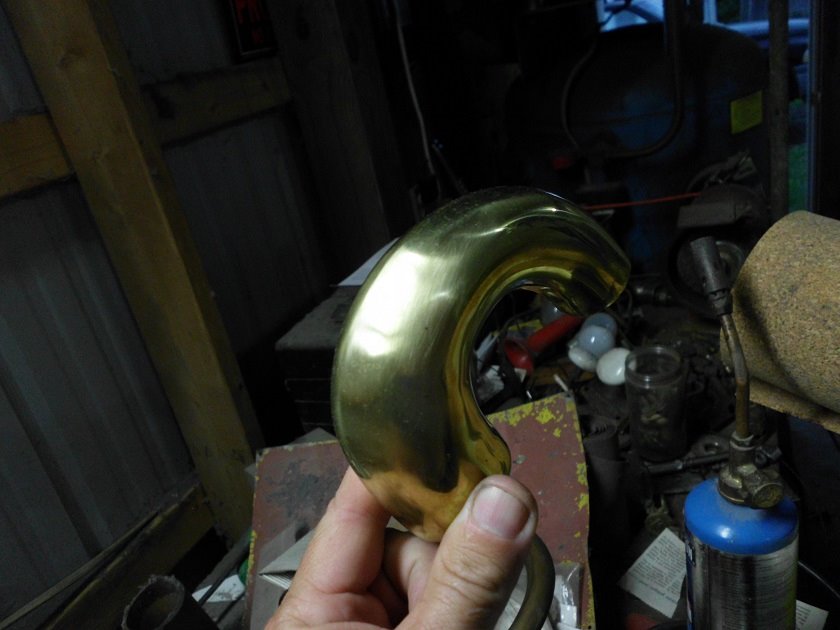

a dumb question, I am getting the lacquer of but its a dull brass look, polish not doing anything, no one around here that will polish the radiator, what will rubbing compound do? any help appreciated, Bob

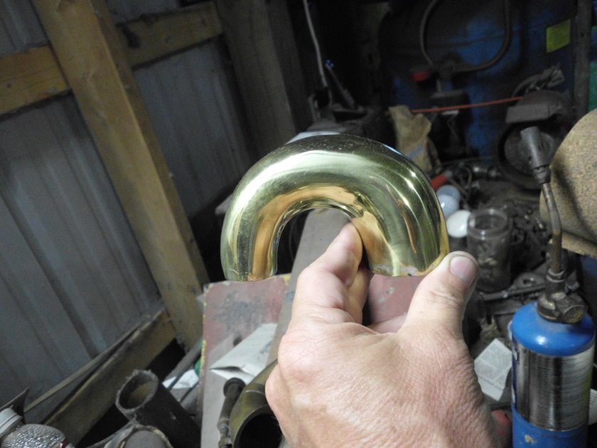

Bob, A rotary tool with a buffing wheel should get that radiator shining. I know you can get buffing rouge at harbor freight. Used to be able to get it at Sears but of course they are no more. It will take some time but once buffed a coat of good brass polish should remove small scratches. If I recall Steve Jelf had a thread on the old forum where he buffed the radiator on his 15 roadster. I think he had some type of buffing/polishing head he chucked in a drill.
