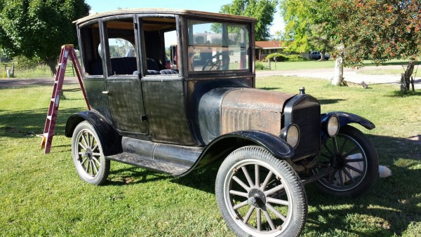

Just got this project with no gas tank. I am sure it goes under the back seat? Not sure about the shape?
Thanks Mike

Michael, your Center Door is about 400 times nicer than the one I have!
That's cool! I call mine a '24 as it has a '24 engine but I understand that isn't possible. Yep under the driver's seat.
Nice car! Thank you for the pic.
