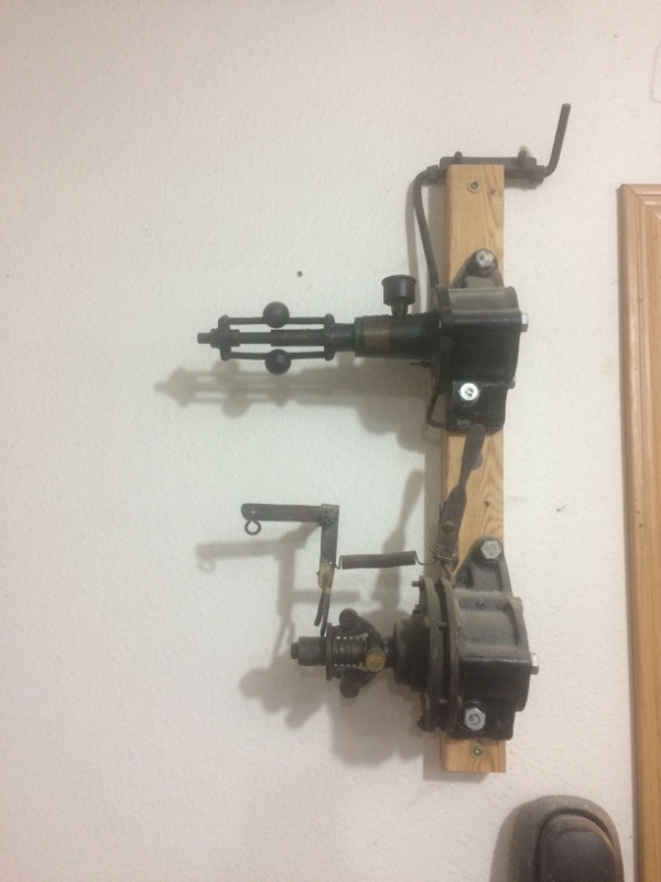

The bottom governor is made with two generator face plates.
