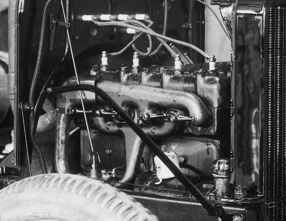

There is a persistent superstition that Model T engines were never painted. This picture of the 1917 Rip Van Winkle car disagrees.

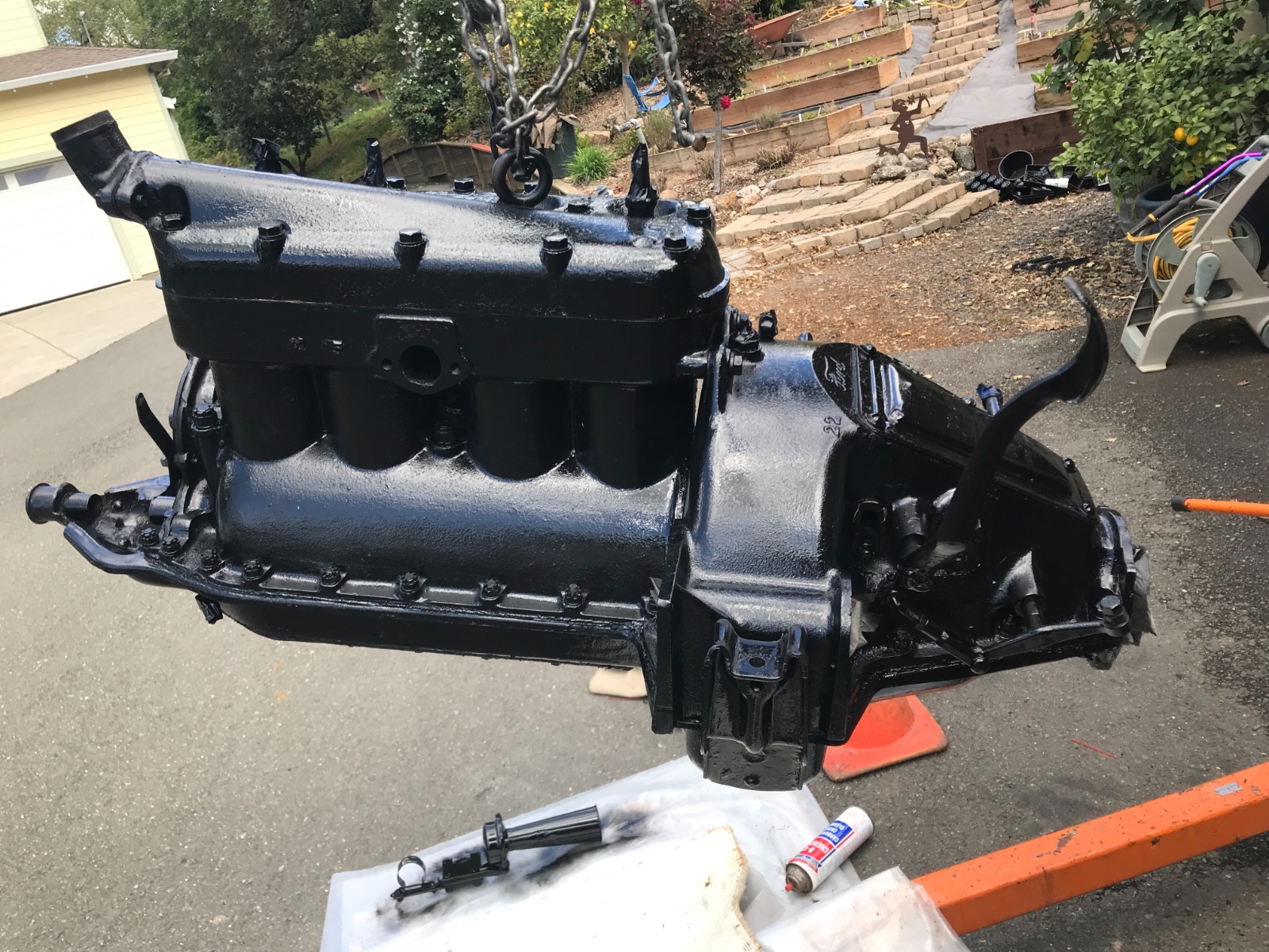

I did quite a bit of research on this when I had my engine out of the car recently. In the interest of saving time, I painted everything in one go. I ended up using this product.
https://www.amazon.com/POR-15-45918-Cha ... th=1&psc=1
This stuff is amazing. It is hard as nails once it dries. And it still looks great after several months of use. The trick is to get everything clean, clean, clean. Wire brush, degreaser and carb cleaner. Repeat.
I got 2 medium coats on the engine and a few extra parts with one can. The final results were amazing. Just be careful with this paint. Once it gets on something, it’s next to impossible to get it off.

I'd say the Rip Van Winkle engine shown above is a pretty good clue. I'm sure it has never been repainted.

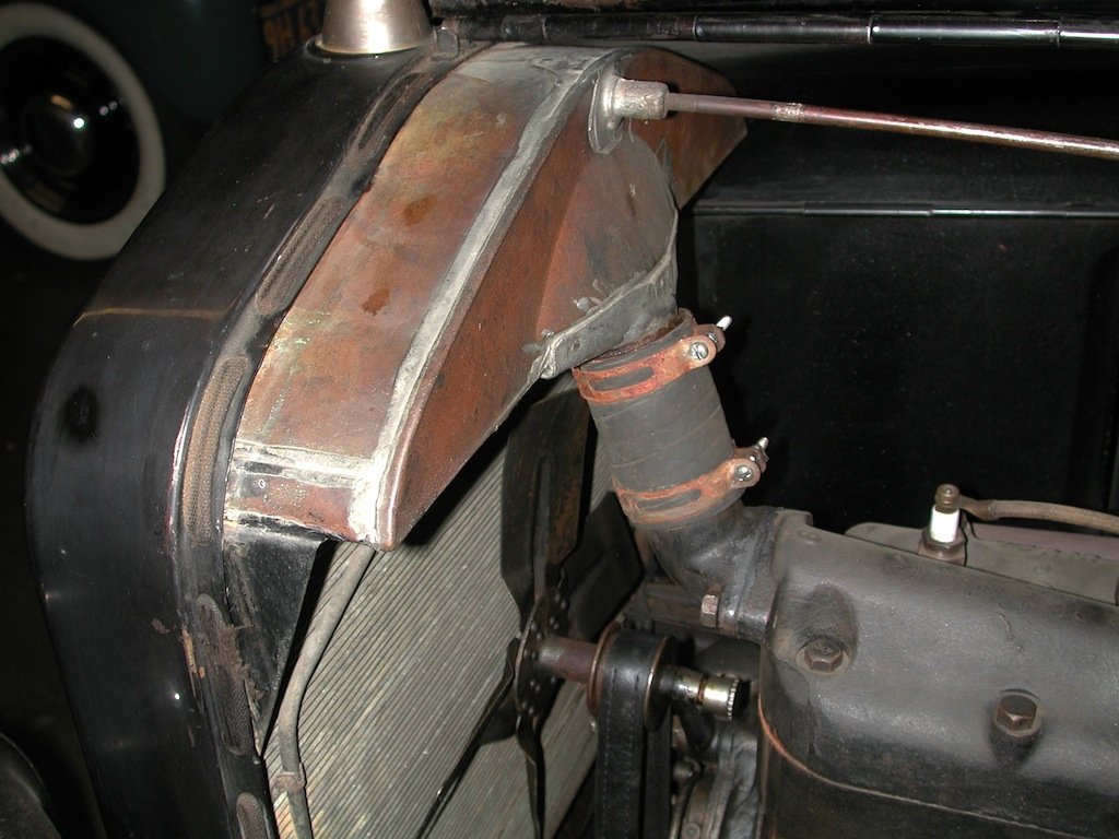

For26-27 I would go by this example at The Henry Ford. In the MTFCI judging/restoration guidelines the color is called "Drake green". It looks very close to military OD to me.
