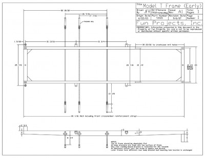

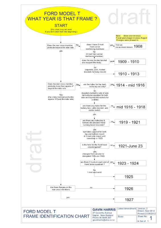

I am looking for a frame drawing / blueprint that shows the correct frame tapper and hole locations on the frame. Preferably a 1912-1914 frame but can work with other year drawing if it will get me close. The ones I have been finding are from hot rod shops and don't give the proper dimension.

Steve, Thank You! This is what I needed.
