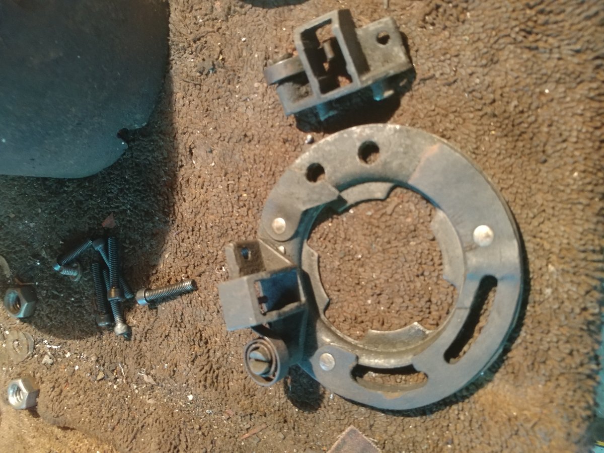

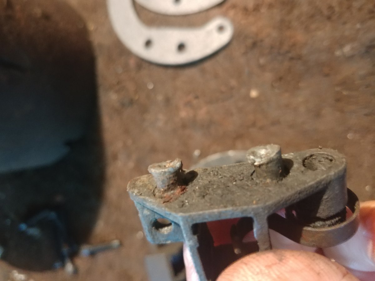

So I started into the generator for the TT. It turned freely and would even motor with 6v applied. The armature checked out ok on the growler so it is a rebuild candidate. But after removing the brush plate I noticed the insulated brush mount was loose, actually to the point it would pull out of the holes in the plate. Has anyone had luck remounting a brush holder? I know Langs sells the plate assembly.

Start with a new repro or good used one and drill & tap to a # 4 or #6 brass screw - I've done several that way and I also have rebuilt ones available - drop me a note.

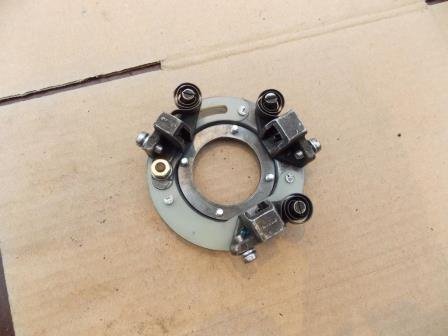

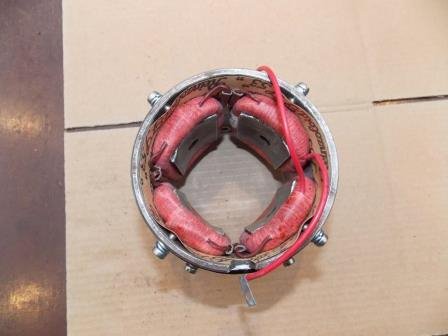

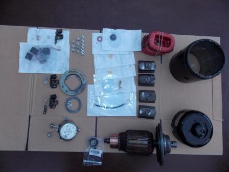

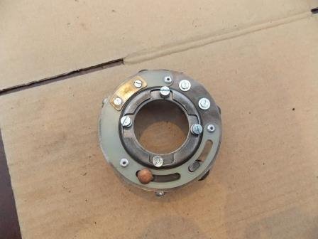

AndreFordT
Posts: 555
Joined: Sun Jan 06, 2019 12:25 pm
First Name: Andre
Last Name: Valkenaers
* REQUIRED* Type and Year of Model Ts owned: 1926 ; 1922 ; 1915.
Location: Scherpenheuvel
Re: Another generator brush holder question
Post by AndreFordT » Tue Aug 06, 2019 5:41 pm
Preston,
Here is the way I do it.
The order of the photos is up side down.
Good luck
Andre
Belgium
