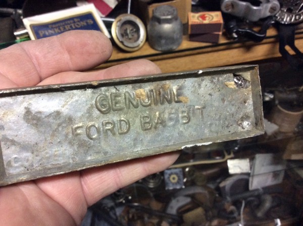

Dropacent
Posts: 3384
Last Name: Morsher
Location: Norwalk Ohio
Re: Babbitt Material
Post by Dropacent » Wed Aug 07, 2019 4:11 pm
Here it is !
[attachment=0]

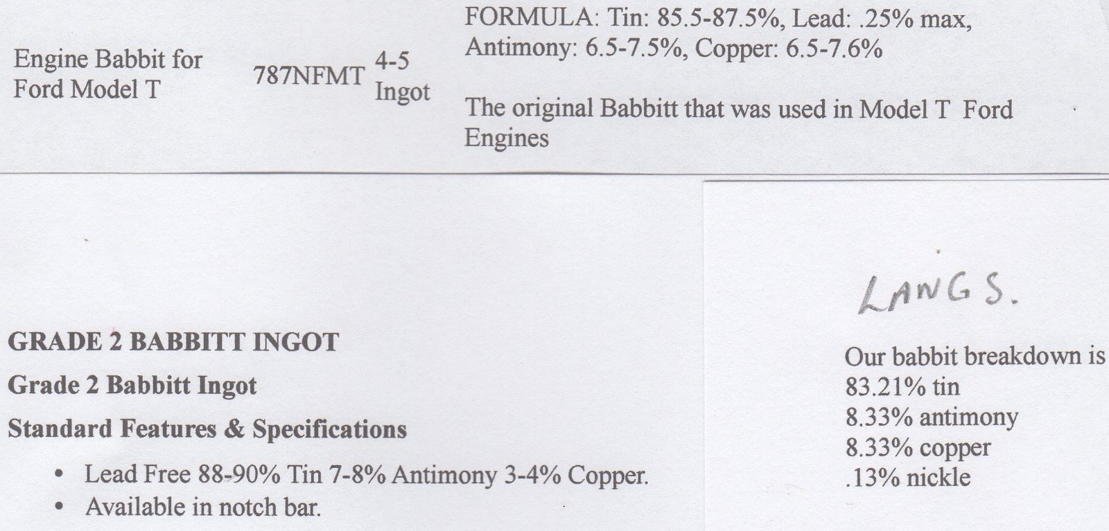

Kerry
Posts: 1461
Last Name: van Ekeren
Post by Kerry » Wed Aug 07, 2019 5:24 pm

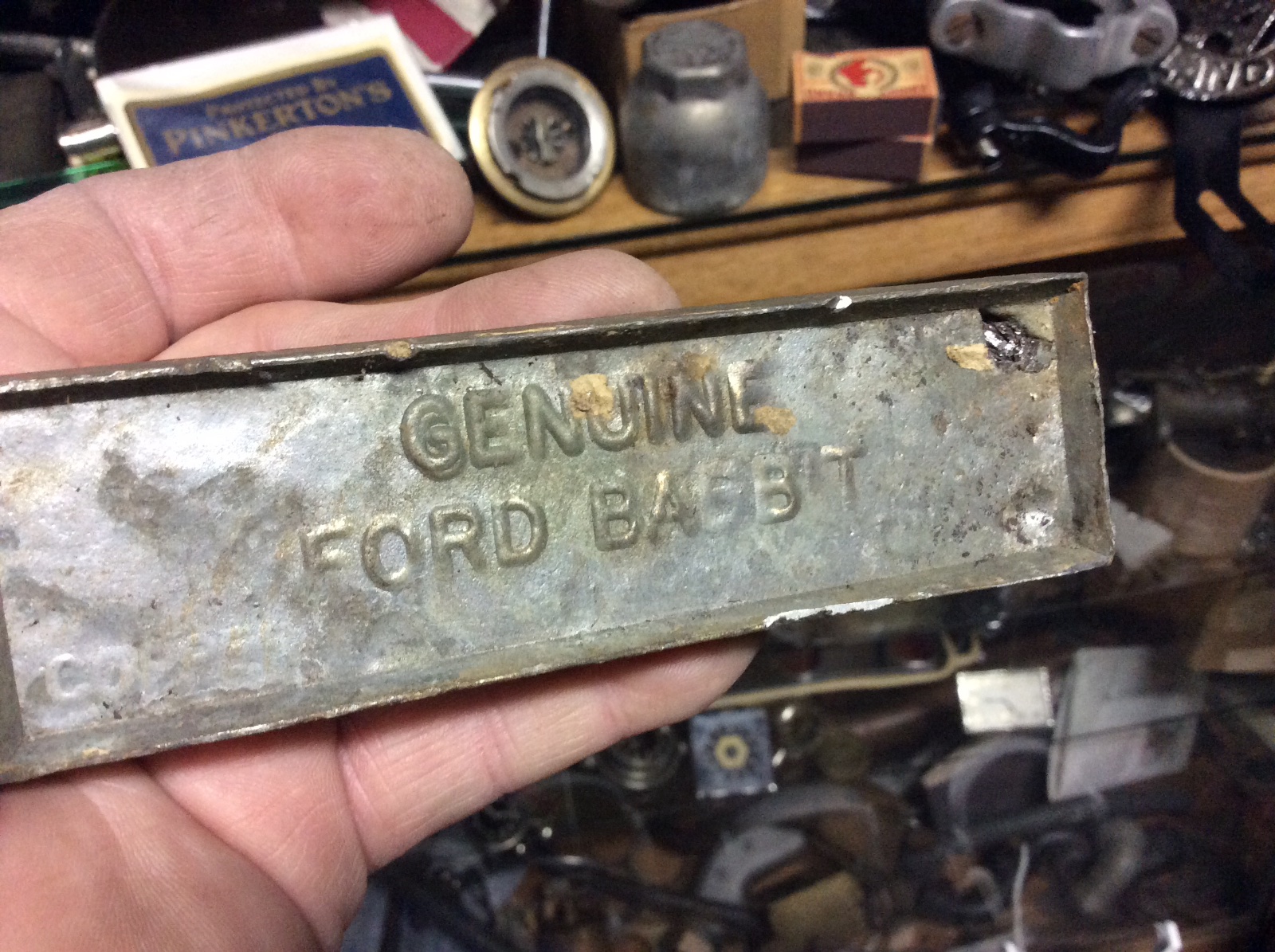

Post by Kohnke Rebabbitting » Wed Aug 07, 2019 9:47 pm
Just because babbitt has Ford in the babbitt, does not mean it came from the Ford Factory, it may be 86-7-7, but it didn't come from Ford.
The babbitt in the Ford Garages, that we got with Wilson tools, that was Ford Babbitt, all had Ford Imprinted in the bar, and written out, Just like the Model T, and A, signs.
We have had a lot of Babbitt that was Printed Ford in it, but was lead Babbitt. Henrys, Gyp parts.
Most all Bearing Manufacturers, used Grade No. 11, specified by car builders.
We use Grade No. 11, and also a lot of Grade No. 2.
We don't use much of 86-7-7, Ford formula, as it machines dirty.
Herm.

Post by Dropacent » Wed Aug 07, 2019 10:34 pm
BUT IT SAYS “GENUINE “. Thought I’d go fishing with that pic and I caught a big one !
