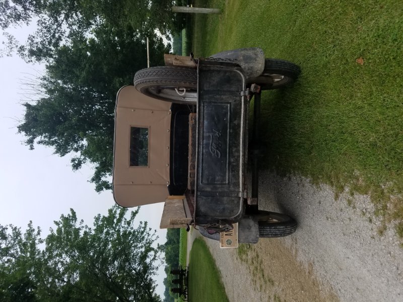

Re: Pickup spare tire holder
Most of the ones I’ve seen have been homemade. I mounted mine there several years ago. Keeps the bed clear for Cosmo, my Golden Retriever.

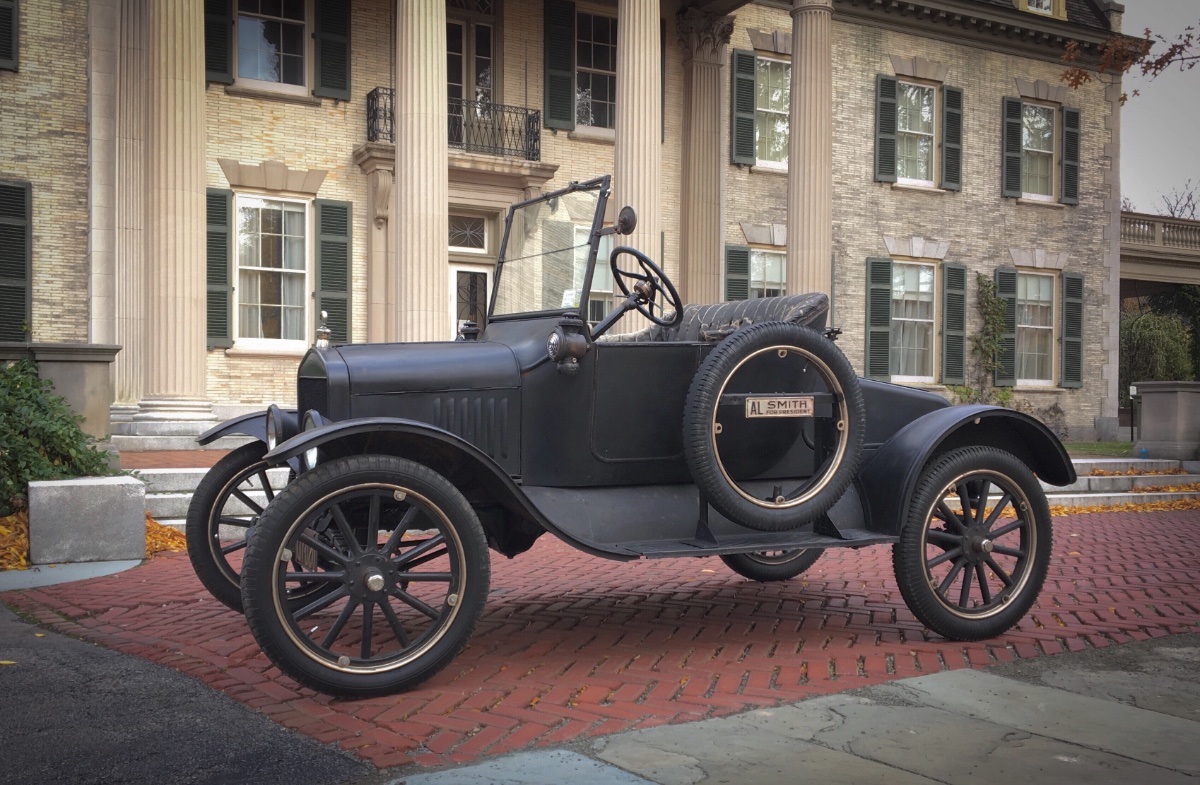

I have yet to install the original pickup box on my ‘23 runabout but here is the vintage spare tire bracket that came with my car.
