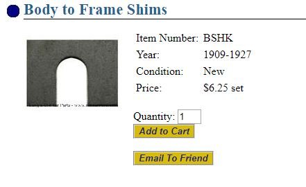

Hi,
Just use shim in the middle of the body. I face-up the same issue and it is work really well and it is a cheap solution. All the best,
https://www.modeltford.com/item/BSHK.aspx
Super Mario Bross ;)

Thank you Quickm007
