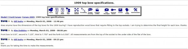

This older post has the bow height from the end of the irons,I.e., what sticks out of the irons.
http://www.mtfca.com/discus/messages/29 ... 1204593956

Here is a screenshot of the old forum page just in case we loose it.

Not sure whether dimensional differences are due to early or late, but distance from tops of sockets to tops of bows on my 09 are much different than those posted here. They are: Front 8.0, 9.25, 9.75. Rear 9.50. The critical dimensions may be the distance from socket pivot points to the outer tops of the bows. I located dimensional data that shows socket configurations that are not identical to mine. The bow radius on mine are all 6" to the outer surface.
