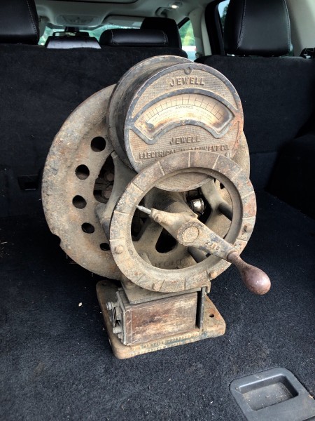

I bought this magneto / coil tester today made by The Service Products Co of Springfield Ohio. The bearings are good and it’s complete but really dirty and the wires are toast. So, I’ll start to take it apart this weekend and see what needs to be done. I hope that enormous Jewel amp is still ok. How should I test the amp? Any tips on using one of these machines. Are there any operating manuals

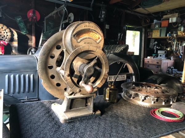

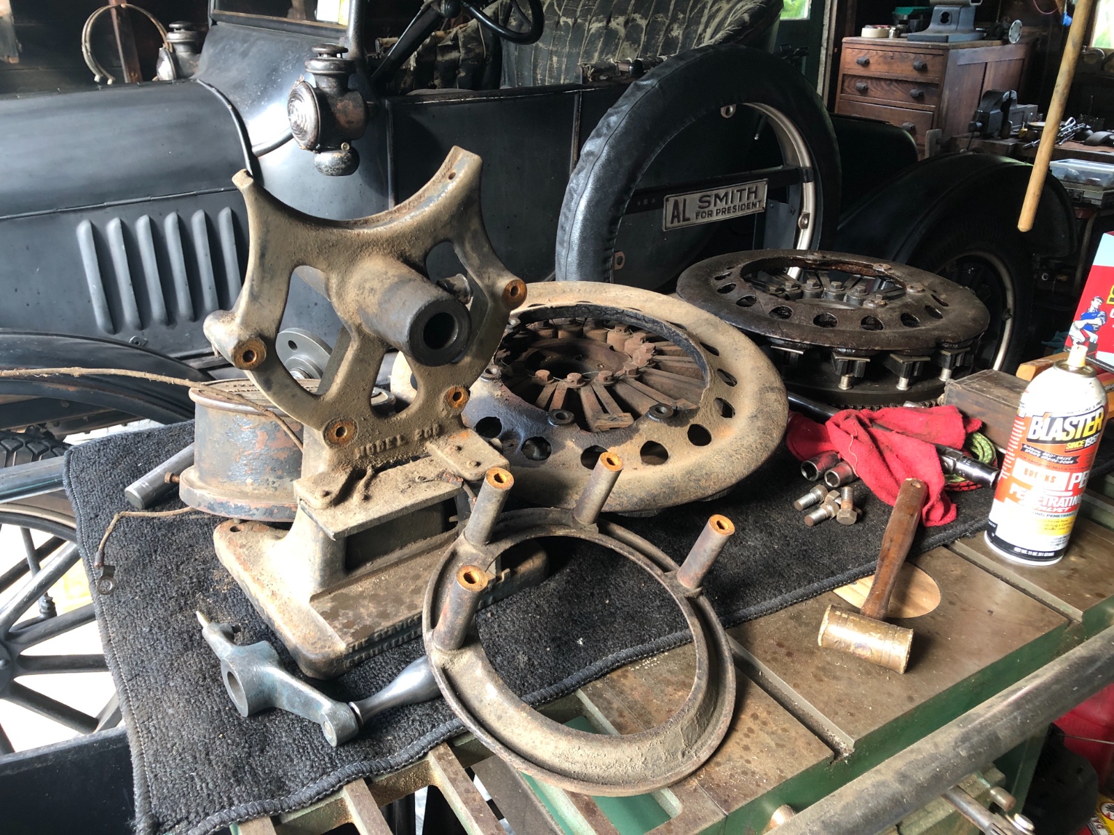

Here it is at home and apart a few minutes later. Looks pretty good. Will clean it up and rewire it this weekend if not sooner.

While you have everything apart, you might as well go the extra step and recharge the magnets the full strength, and check out the coils for missing insulation and damage

I actually have a flywheel magnet assembly that I rebuilt recharged and a perfect coil assembly for the purpose of building one of these all set to go.
