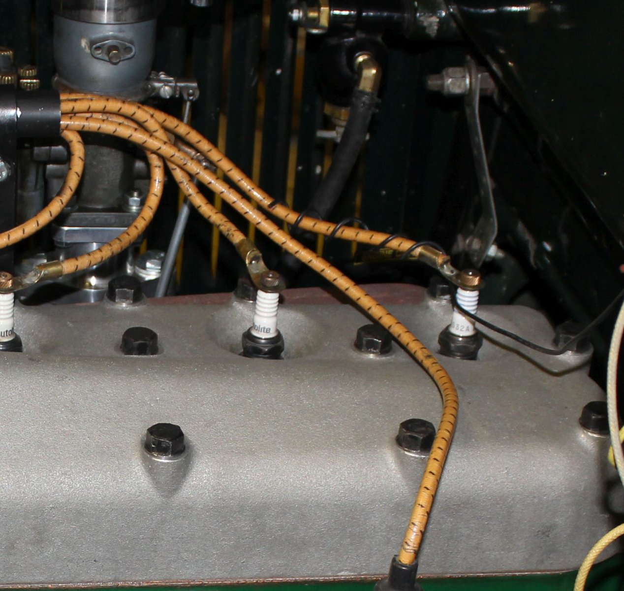

I’m a new Model T owner and have not driven my car on the road. I need to get a feel for shift points and maximum safe engine RPM’s to prevent damage before heading beyond my driveway. I can’t tell what RPM my engine is running by sound. I had an inductive tachometer on my lawn tractor for years and it worked well. I want to get one for my Model T too.
Inductive tachometers work simply by wrapping the inductance wire around a sparkplug wire a few times. The sensor picks up the spark and displays RPM based on the number of firings per 2 revolutions. I don’t know if an inductive tach will work on a Model T.
Does the sparkplug normally fire once per ignition cycle or is there more than one spark? Since I don’t have a magneto, I can only run on 6V. Would an E-timer fire a single spark per ignition cycle?

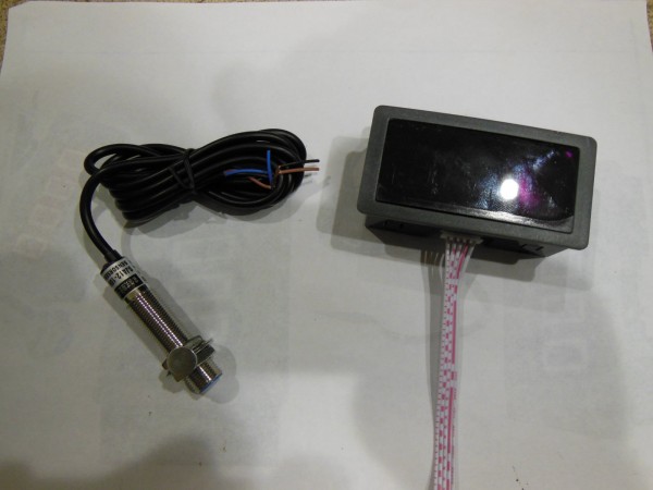

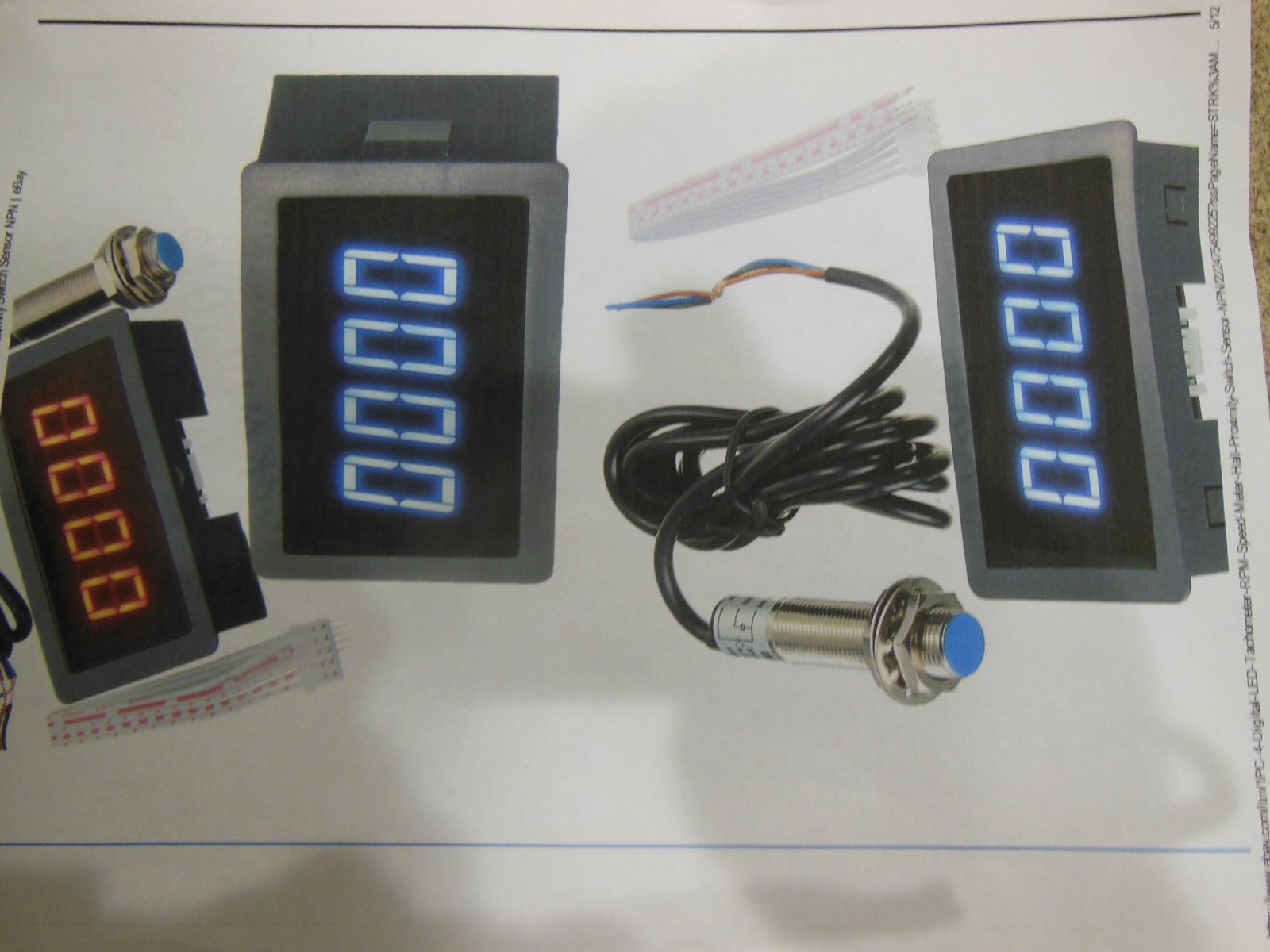

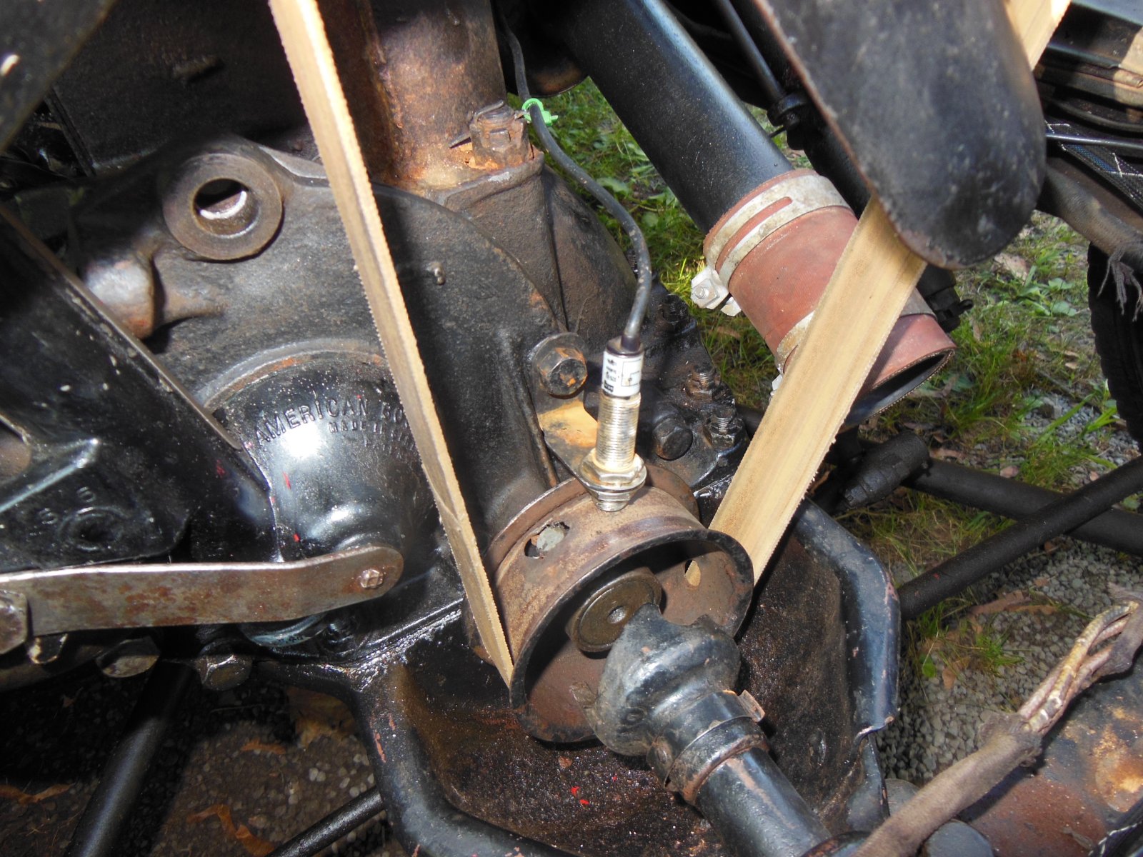

Mark, If you want a digital tack the pictures are of the components from a source on Ebay (they sell it in red or blue) and I show how I mounted the magnet ( I glued it to the crank starting pin) an mounted the pickup to the cam gear cover. You can see the magnet through the hole In the pulley. Total cost was $5.59 + .29 shipping from China. It works great.

The E-Timer provides a continuous spark just like when a mechanical timer is used with original coils. In terms of knowing the 'safe' rev range of the engine, you'll find it's not something to worry about too much. In top gear, a standard car just can't drive fast enough to get into the danger zone (unless it's going down a steep hill perhaps). In low gear, it's unlikely you'll over rev it, but when I'm ascending a steep hill in low gear, I just keep an eye on the speedometer ( a bike speedo with magnet on one of the front wheels). I stay under about 25 km/h (16 mph).
