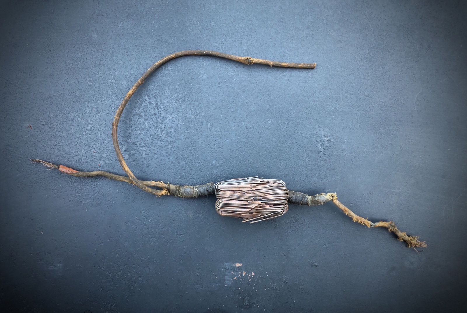

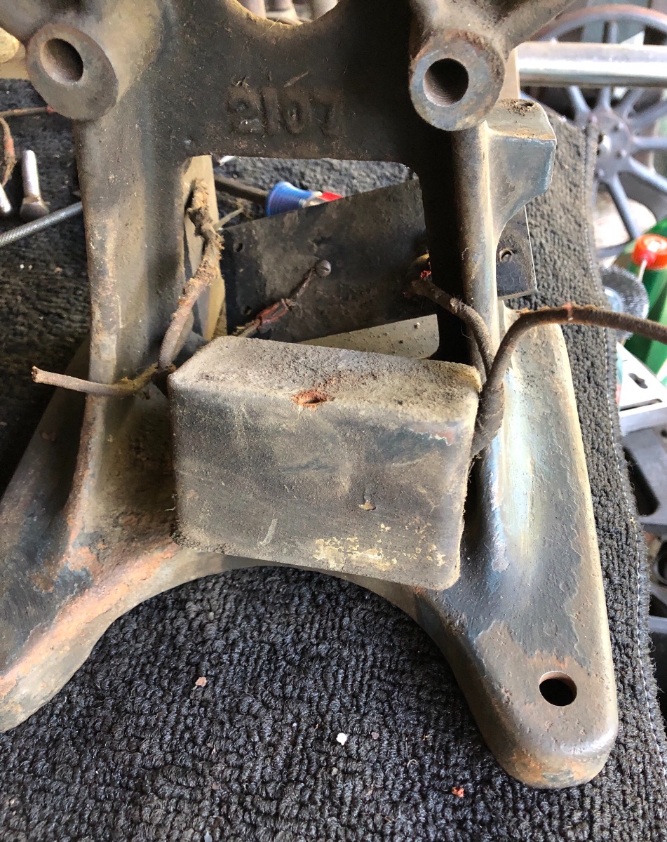

Am disassembling a hand crank coil tester and found this in a stamped brass box screwed to the base. Any ideas?

I'd be inclined to maybe call it a resistor ??

It’s a choke coil to put load on the magneto.

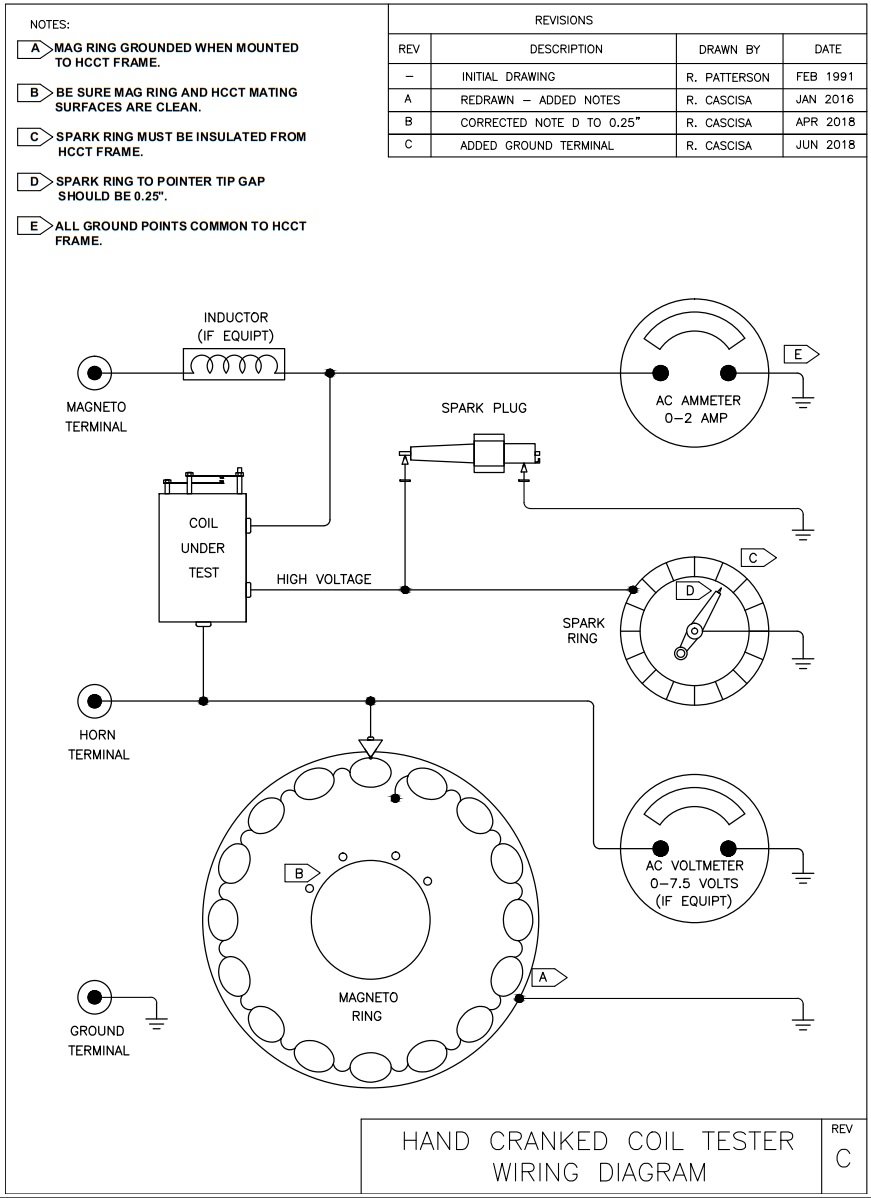

That is an Inductor.
As Dan said, it is used to simulate the load of an ignition coil when the car magneto is connected to the HCCT for testing.

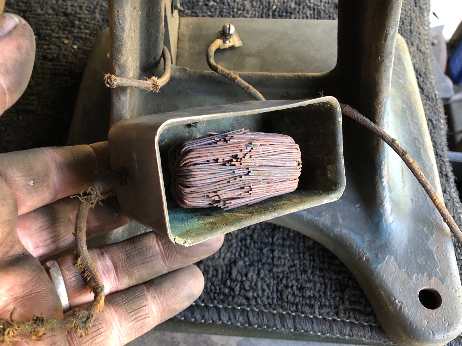

ALso, that's the second one I've seen of that style in that condition.

Is it in good condition or bad condition? LOL .. I wouldn’t know. Seems to be surrounded by a shield made of stiff wires. Do I need to reinstall?

The inductor is only in play if you want to test the output of a car magneto.
It is not used for the normal testing of ignition coils.
