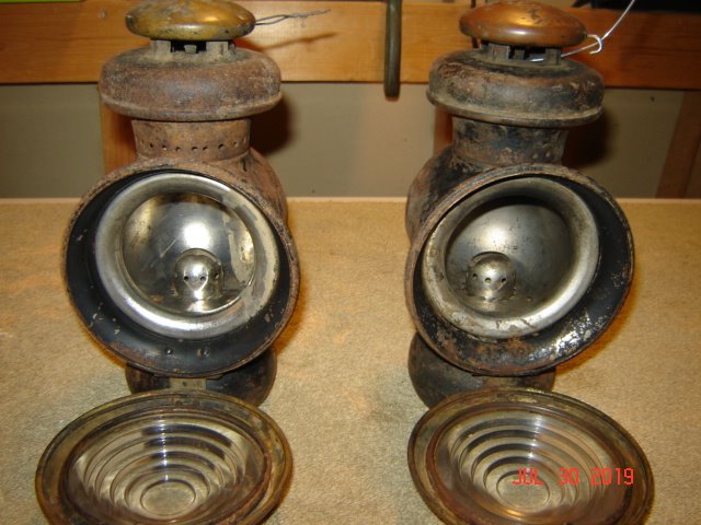

Here is a pair of E & J Model 8 side lights for the 1915 Model T Fords. Even though they need restoration, they have pretty nice examples of the round "diver's helmet" reflectors that Allan is describing.
1922 Coupe , 1926 Touring

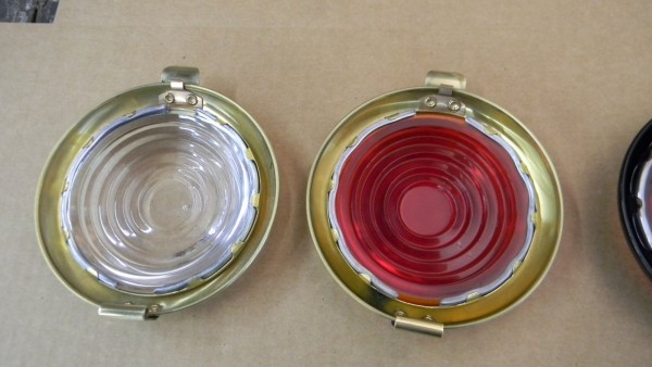

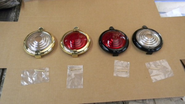

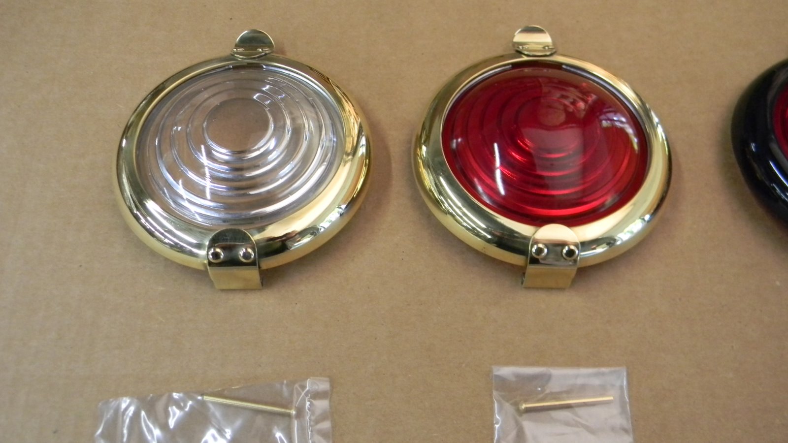

We have these in stock now with tabs to hold the glass, and we sell them with glass installed, Bob
