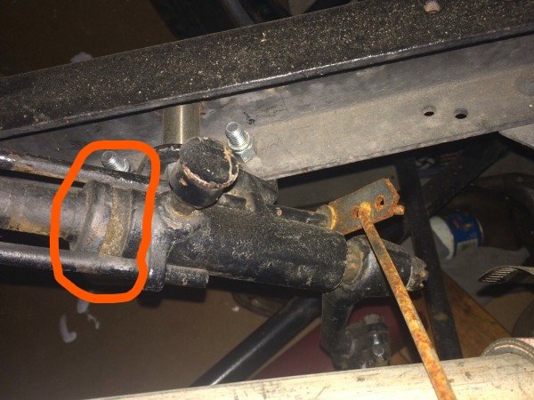

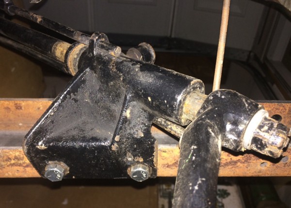

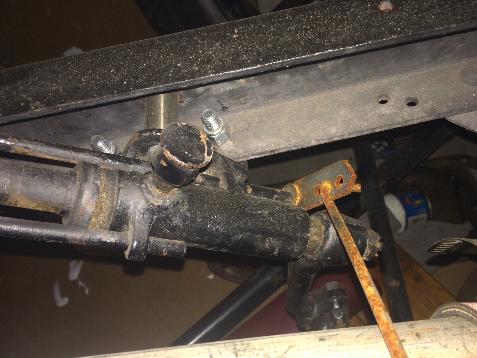

Matt in California
- Posts: 818
- First Name: Matt
- Last Name: G
- Location: California
Re: Need photo TT truck lower steering column mount
Here is what I have. I am not sure if it is correct.
I will let viewers determine if it is correct for TT.
Yes, I got this on a project car and the linkage is not Ford. I hope to replace it eventually.
Matt
Matt
This is the wood block. It goes inside the frame and a bolt in inserted through the outside of the frame, through the block and the hole in the side of the steering bracket. Matt's lower photo has a round spacer where the block should be.

- Posts: 5510
If you look at the 2ed photo above, you will note if you look close, there is a metal cap with felt under it on the top. While not 100%, I think all TT used a bracket that did not have a built in place for the felt and used that cap type seal on the top end.

- Posts: 5512
Mark is correct - the TT bracket utilized a felt & stamped steel cap which don't seem to be available.

- Posts: 5512
And Matt - that is a correct TT lower bracket.
