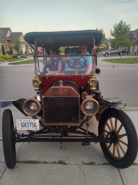

I have an early 13 Touring built in Dec of 1912, probably in Detroit, but sold and/or assembled in Canada. It has American engine serial # 181,4XX, with matching Large data plate, which says Walkersville Ont. on the bottom. Ford did not begin manufacturing in Canada till May of 13, beginning with engine # C-1. I am the 3rd owner from new, and the speedo says 3200+ miles, which looking at the pedals etc, I believe is real. The front fenders have none of the above mentioned beads, and no bill, BUT they do have an extra rectangular rib around the outside edge of all 4 fenders, much the same as a 1910 REO Model R. IF that's a Canadian feature, the only other one is the addition of a Left Hand door on the Fischer built body. This one was sold in Montreal, so its L.H. drive, and even has no holes in the frame rail for the R.H. steering to mount. It also has a few leftover 1912 features, Ford script trans cover, no Made in USA on the head (but it is on the block) that goofy long taillight bracket, and a few other bits. The Rands windshield is equal dimension on top & bottom halves. Otherwise its identical to its American cousins, and still has its factory leather upholstery. I am putting a top kit on it now, the old one did not survive the last tour, and probably was not original, but it was at least 90 years old.. Jeff Beaumont, Gardnerville, NV

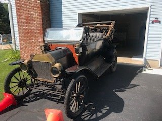

Jan. 1913 build date. No rib across fender like later styles had but I don't have a picture to post of it. I posted all of my pictures on the old forum here http://www.mtfca.com/discus/messages/599638/641256.html and should repost them sometime so people can blow them up full size and see more detail.

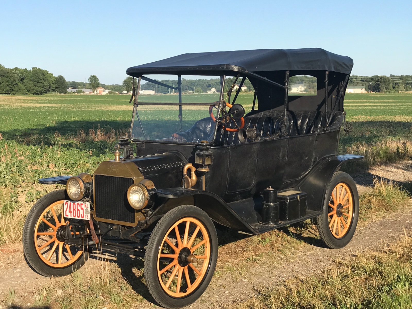

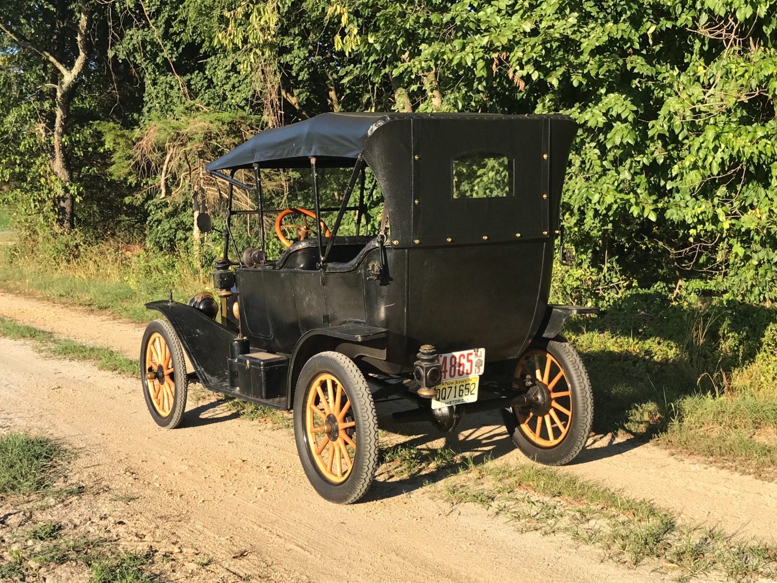

Late - July build '13 Touring.

The early '13 fenders don't have a bill, but the lip does stick out in front like a '12. It just doesn't hang down. It's the same distance all the way around the top of the fender as the rest of the lip. I suppose I could take some pictures, but I'm lazy!

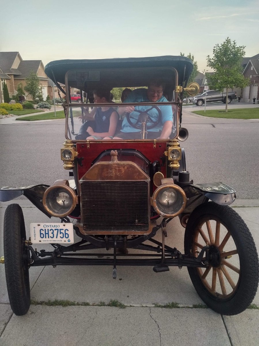

My early Canadian '13, built in I think Sept. or Oct. 1912 has double beaded, billed front fenders. Engine number C872

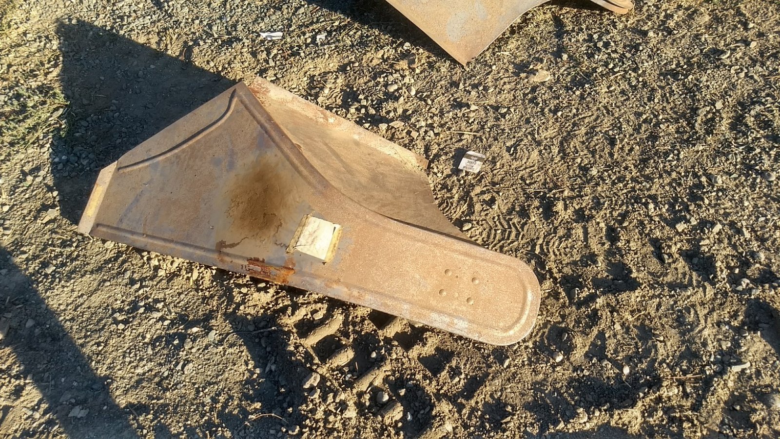

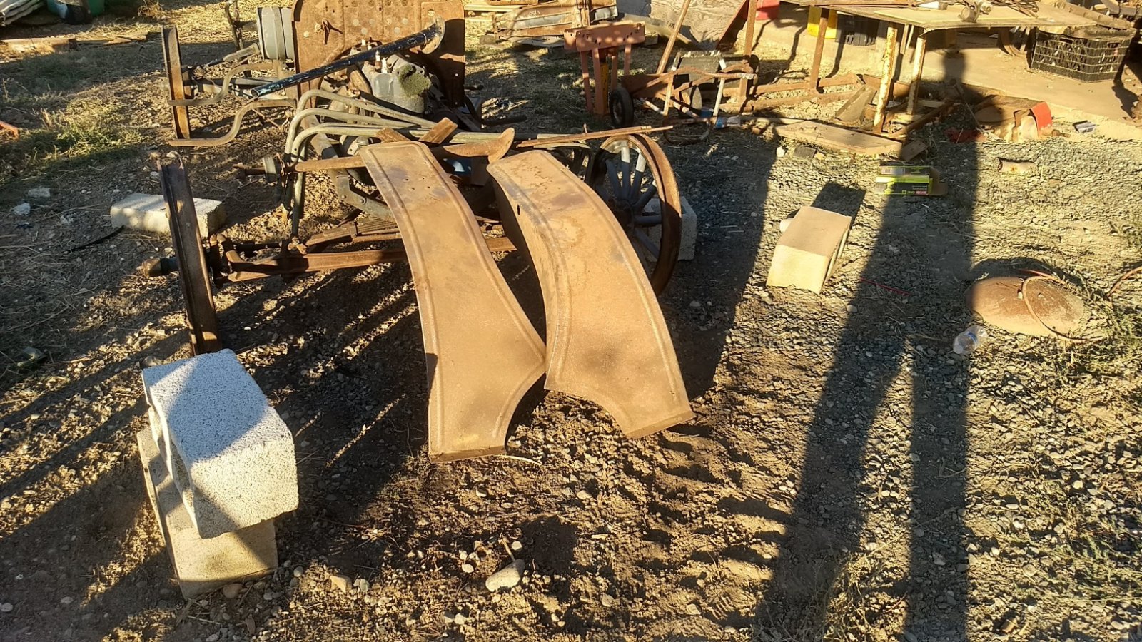

Hi, I think I may have a complete set of the early 13 fenders, that are new but made years ago. I'll take some pictures and post.

The fronts don't have a bill on them.
