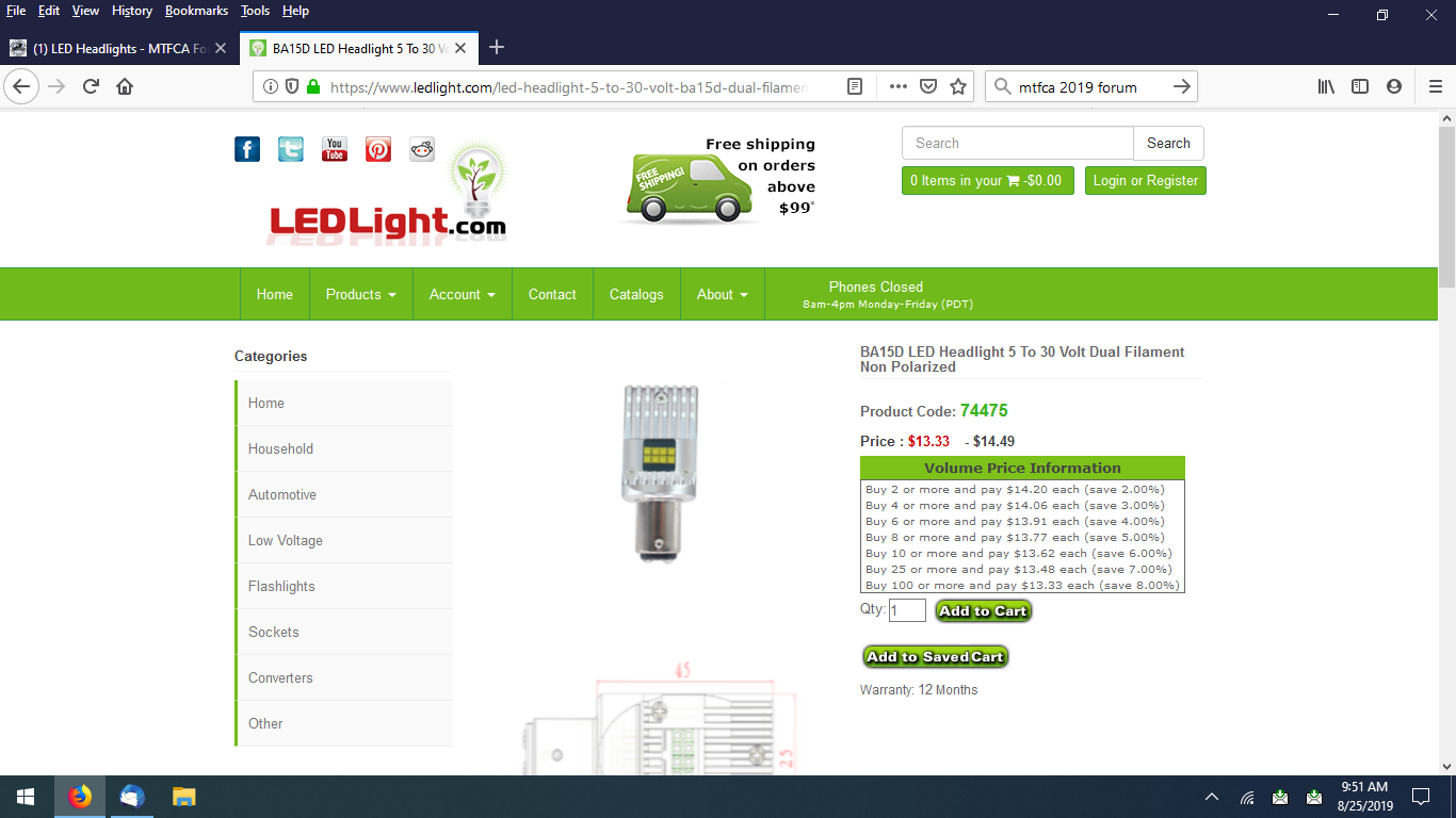

The web site is "LEDLight.com"
here is the link to the bulbs :
https://www.ledlight.com/led-headlight- ... rized.aspx

The LED bulbs are rated from 5 to 30 volts. So no need to change over to a 12V m/c battery. I did this when all I could find were 12V LEDs for headlight, stop and tail lights.

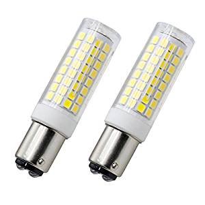

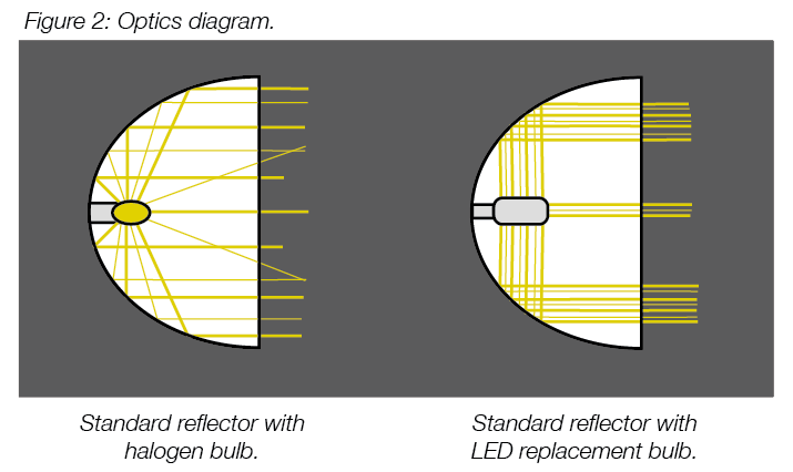

I checked into some of the BA15D LEDs but the do require a good reflector behind the bulb to work properly. Luckily I contacted the help line before I placed my order.

Victor, you may have found a bulb with a good match for the focal point of a T reflector. The shape of some of the LED bulbs aren't suited for the shape of T's reflector, the result is less output than claimed as shown in the photo. Could/would you post a picture of the bulb in the reflector, so we know what we need to get. The reason I'm asking is the fine print under LEDLights product picture says "Actual Product may vary from picture shown. One product per package unless otherwise stated." Would appreciate it , Thanks Frank

For some reason I can't get the picture of the LED to insert. The problem with LED bulbs is as stated in the previous post and that was the same issue I ran into no matter what LED bulb I tried. I needed LED reflectors which no one makes to fit a Model T. I found LEDs similar in design to these, but they required extensive modifications to the T headlights which I wouldn't do. These LED bulbs are designed differently from the LED pix and as such seem to work in a incandescent headlight reflector.
From their write up about the LED design... "The reason the leds light up on both sides of the led headlight is to simulate the original filament by splitting the led into to sides. The reason the led has to be split up on both sides is because the led light CSP only can light up to 120 degrees. Since to emulate the original filament two 120 degree CSP leds have to be used to properly reflect light of the headlight fixture."
I have used several design LEDs and to date, I can be seen, but as lights for me to see the road, they were poor. I live outside of town. No street lights anywhere so I will be able to tell how good these LEDs are in a little bit of driving. In the next day or so I will be running my T at night and will add to the post the effectiveness of the LEDs.

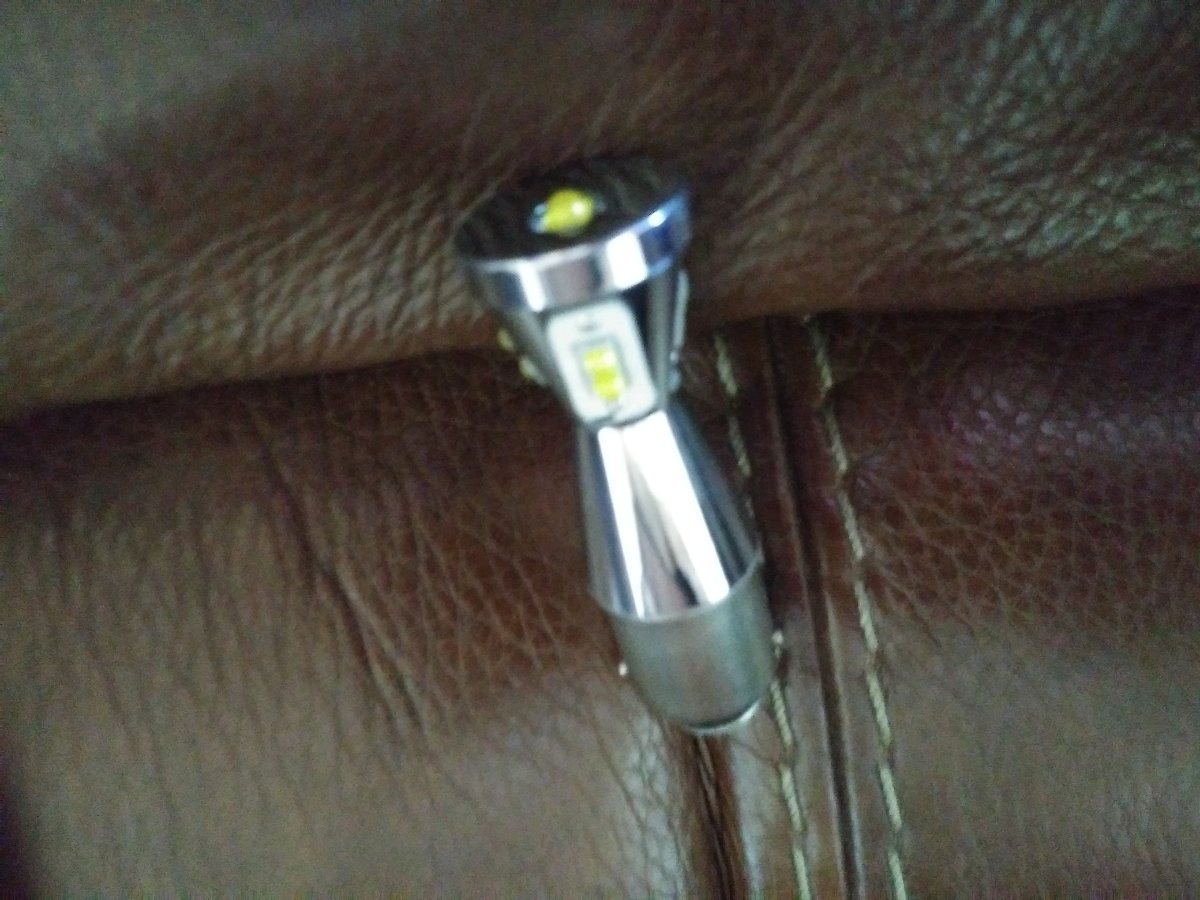

Ops, my LED headlight failed. I sent an email to LEDlight.com today, a Sunday, and already they have responded stating they were sending another one.

I'm currently running LED bulbs from led light.com. They are about half the price and half the cp...900cp I believe. Way brighter than stock, and dim is quite a noticeable difference.
1800cp seems rather bright for oncoming traffic to me.

- Posts: 7293
Re: LED Headlights
Victor, quite bright, but light going anywhere. LED's and parabolic reflectors just cannot work efficiently.

6 VOLT LED HEADLIGHT BULBS
I tried both of the LEDLIGHT.COM LED Headlight bulbs. The 5-30 volt dual filament wedge shaped 75 watt SKU74475W. $13.33 and the round 6 volt dual filament 55 watt SKU87455W. $7.81 Both are excellent headlight bulbs which operate on 6 volts and the 74475W can be used on 6,8,12 volt systems as well. I like the construction of both bulbs which had elevated the LED emitters to the same ? distance from the reflector as a original Model T bulb filament. My opinion is the 75 watt to be too bright for on coming traffic and puts out a funny looking c or u shaped pattern when reflected on a wall like Victors photo above post illustrates. It is a excellent Driver's headlight for dark isolated roads really lights things up but on coming drivers wont appreciate it much. The 55 watt 87455W bulb is the one I think Dave was talking about in above post. I think the 87455W is a better choice for several reasons. Is cheaper puts light out in a 360 degree circle of light and has LEDs on top of the bulb as well which eliminates the dead spot on top the 74475 has. which is not set up for original model T socket but vendor replacement sockets which have the wrong filament orientation resulting in the bulb being vertical instead of horizontal in the OEM socket. The round 87455 will work the same in either socket it too has high and low beam just like OEM bulb with elevated filament but much brighter but not too bright for on coming drivers. Can also be left on all the time for daytime running lights. On high beam. I can barely see the amp meter needle deflect. where original pair drew about about 10 amps. more that the generator puts out. it is lightweight where the 75 watt bulb is long and heavy could cause socket trouble after bouncing down the road for many miles. The 74475W would be excellent for use in a spot light. I am glad to see the LED manufactures respond to the needs of pre 50s classic car owners with 6 volt headlights.

Re: LED Headlights Photo
Photo of LED Headlight showing space between the base and the led to put it at the right focal length.

John Dow
- Posts: 177
- Joined: Tue Jan 29, 2019 10:21 am
- Last Name: Dow
- Location: Leawood, Ks
Re: LED Headlights
I just installed a set like "Novice" shows above. Huge difference!!
