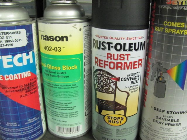

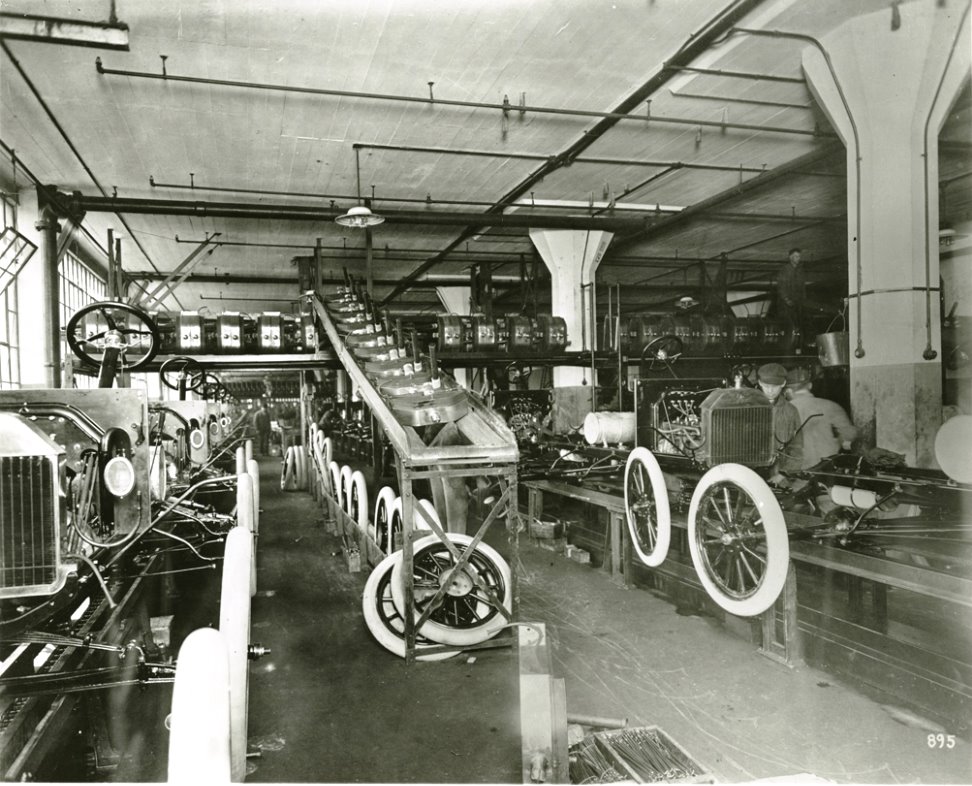

click on photo to enlarge
Donnie
Head on over to the Model T parts agency and have them dust off a can of M-122 Radiator Black, that's what was used
For real, just use a paint that is a soft dull black paint, thin, and dries fast. You can put it on the upper tank too. Ford Service says to coat the outside of the fins with black paint. For the radiator don't use heavy thick enamel, and many coats. Gloss isn't to be either, just a dullblack.
Have used Rustoleum Rust Reformer on my core, sprays thin, is a nice dull black, and lasts. While it can prevent rust, it is also a great thin primer, and is high temp resistant too for radiator tanks. Also have used Hi-Temp grill and stove flat black, just spray light coat.
Most times only the face of the radiator is painted as that is what shows, only the external fins and tubes, don't spray deep or thick into the core and try to cover every tube and fin, front and back, that is too much paint that can retard the heat to air exchange that the radiator performs.
Now for your period speedster you could mix up a batch of 'correct' covering for the radiator:
Dyke's 1922 formula:
3 0z. boiled linseed oil; 4 oz. lampblack; 1 oz. turpentine, mix and thin down with turpentine. Dip or spray or place horizontal on boxes and allow the thin mixture to pour over the the parts of the radiator.
And you can get labeled paint for auto radiators from places like Eastwood but they are marked as a gloss paint.

Thanks for the info. Ill be going to town tomorrow, so Ill look into the rustreformer or high temp xhaust paint.
