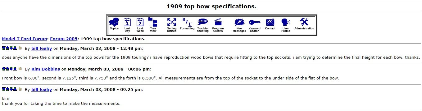

Here is a screenshot of the old forum page just in case we loose it.

My body # 82XX according to Bruce's book puts the build date as Aug.2, 1909 so late in the year. It has the aluminum skin Pontiac body which from memory was used last in September 1909? My engine was replaced at some point with a non starter 1916 engine so still hand crank and no generator. I would like to find the original engine but would keep the car as is for now to drive and save the open valve if I had it, but it needs the top so it is of interest to know if Kim's measurements are the same for early and late 1909 touring's?

Not sure whether dimensional differences are due to early or late, but distance from tops of sockets to tops of bows on my 09 are much different than those posted here. They are: Front 8.0, 9.25, 9.75. Rear 9.50. The critical dimensions may be the distance from socket pivot points to the outer tops of the bows. I located dimensional data that shows socket configurations that are not identical to mine. The bow radius on mine are all 6" to the outer surface.
