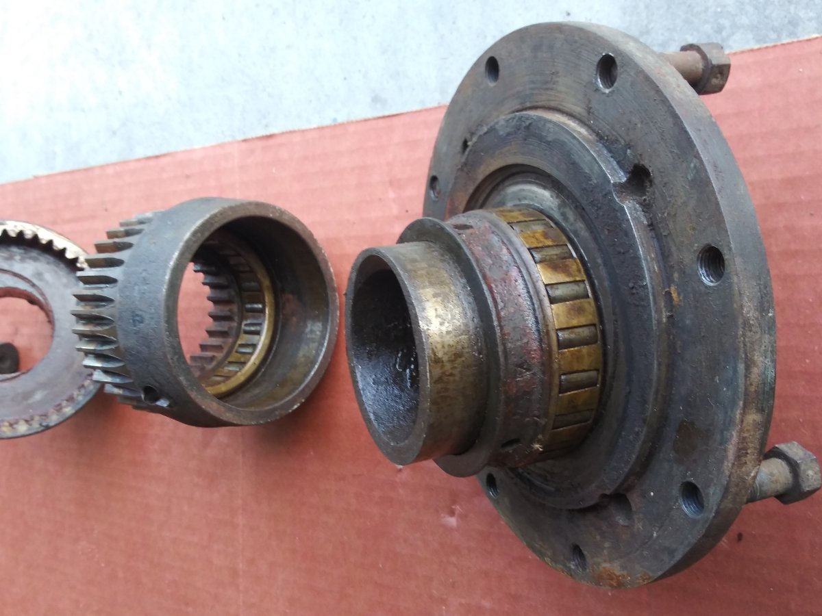

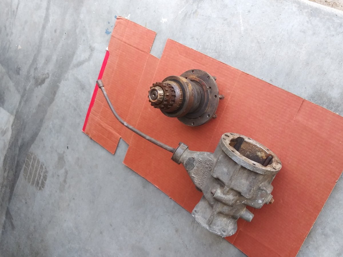

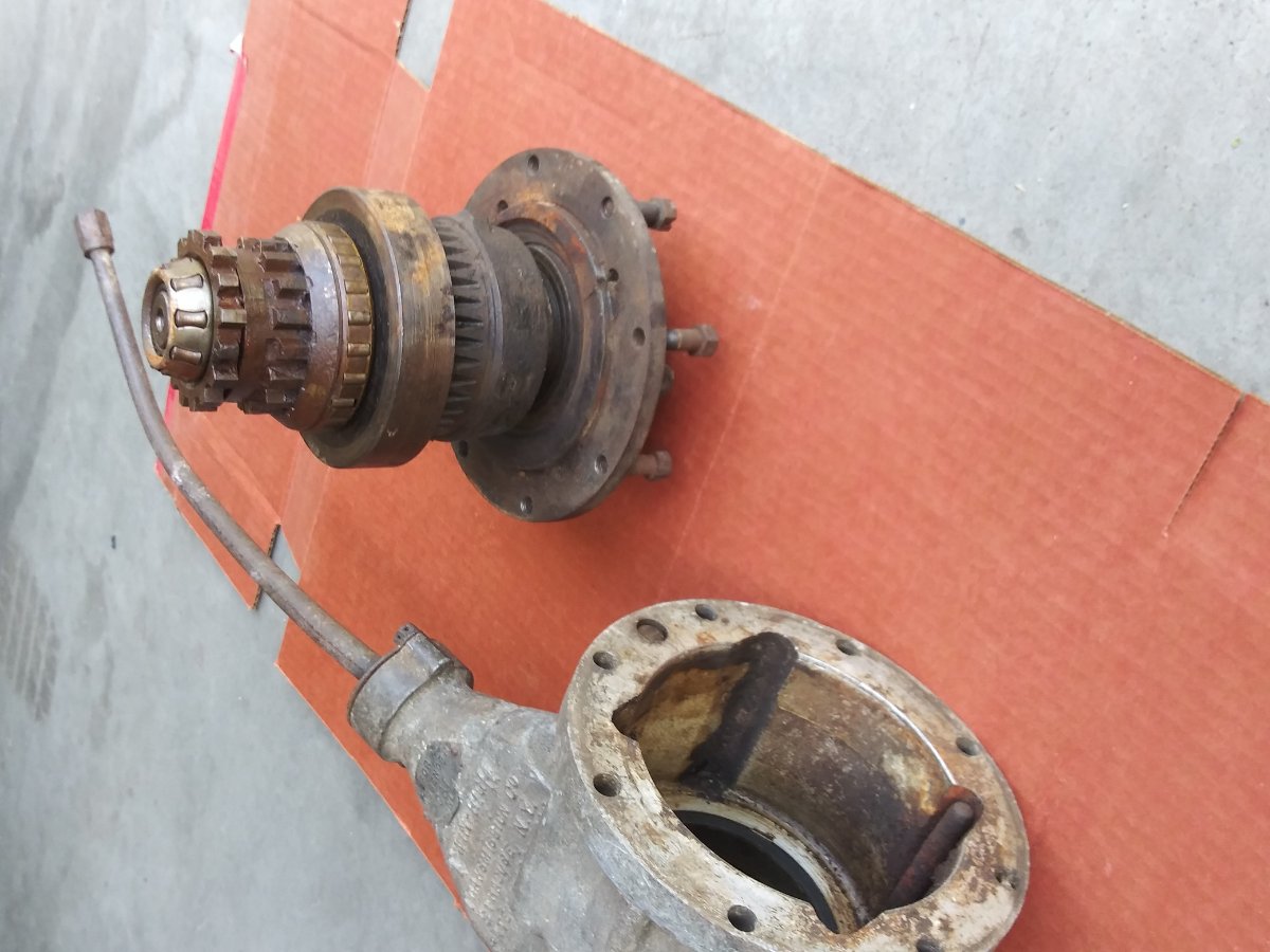

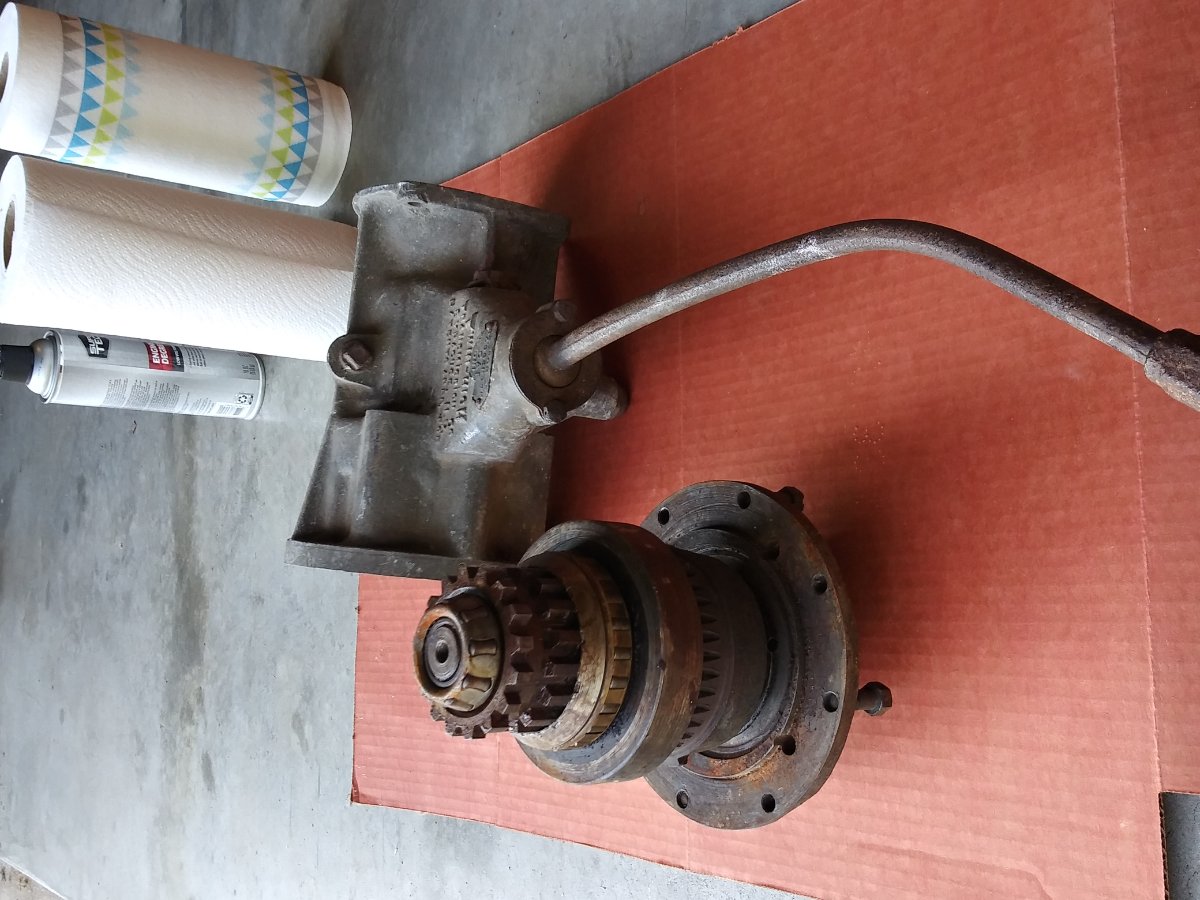

Joe is correct. I have one that needs a rebuild. You could say it's a thinking man's Model T transmission (so Gary Norton in MI, it's certainly not for you monkey boy).
Here's some pics

note gear teeth length varies

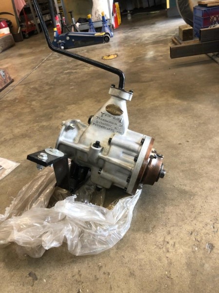

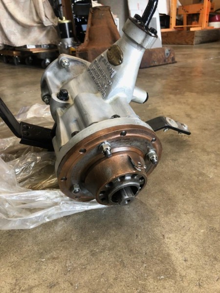

I’ve got the TT version going in my truck. Just painted it two nights ago. I’d also like to find another for parts just to have lying around.
Brad

Post by Jeepbone1 » Thu May 14, 2020 8:28 am
Here it is all painted up.

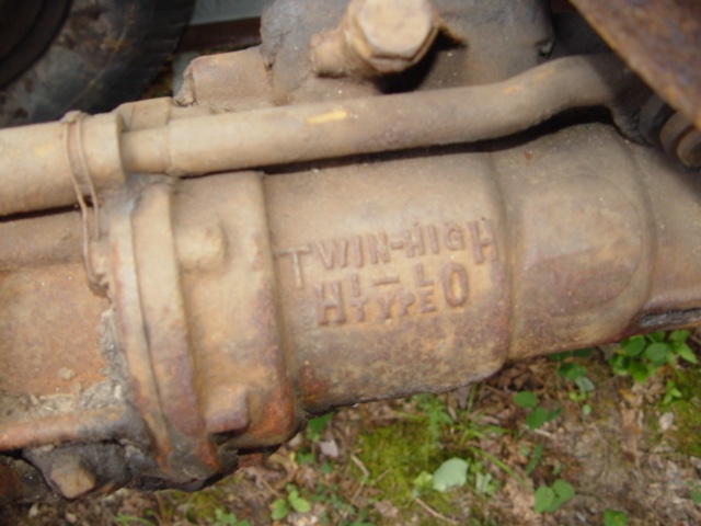

That's not the TT version of the Twin-High, you have the "Twin-High Hi-Lo type" a completely different animal.
"Twin-High Hi-Lo type" was only made for TT and was rear mounted. The Twin-High came in both car and TT versions and was a light weight front mounted unit.

I have a TT with a Twin-High Hi Lo type and would like to know more about it, like are parts available for it? and those with any experience with one is it noisey and do they shift easily? I bought the truck because of it and haven't gotten it running. I have been keeping my eyes open for doors, if I can find 4 doors I want to build a crew cab.
Note that the Twin-High Hi Lo type tranny was also made for the worm drive AA.
I’ve seen two slightly versions of the one I have. Assuming yours is one of those, no parts are not available. If you’re good with a micrometer, you should be able to match up the bearings with new replacements. Mine were in nice shape and the races looked almost brand new. It was just all sludged up. if you plan to go through it, here’s what I did. Separating the unit from the torque tube and driveshaft is a Royal PITA. You just have to remove the u joint pin and u joint, take out the two clamping bolts from the front of the trans. Slide the torque tube off the drive shaft. There is then a pin holding the drive shaft to the input of the trans that took me a solid hour and a half to get that out alone. It’s smooth sailing from there. Six bolts are holding it to the rear axel like a normal torque tube. The shifters come out without much fuss. There ten 3/8” bolts holding the case together. Four are 1”, four are 4” and two are 4-1/2” all should have a 9/16” head. Now is where I suggest taking pictures and remembering orientation. One slider pulls out of the back no problem. Once it’s split into thirds, you can do the bulk of your cleaning with brake cleaner to knock most of the gunk off. Then the front has a 1-1/16 nut with a cotter pin. Once that’s removed, start taking pictures because it can get to be a whole lot real quick. Everything should slide apart from there. After that, throw it back together, make some gaskets, squirt some paint for effect and you’re golden. Time consuming but probably worth the peace of mind that it’s solid. Mine shifted pretty easy but I also only shifted it while turning the motor over by hand. Any noise would probably be attributed to bearing/gear wear. Like I said before, the guts in mine are pretty nice so I don’t expect much problem.
