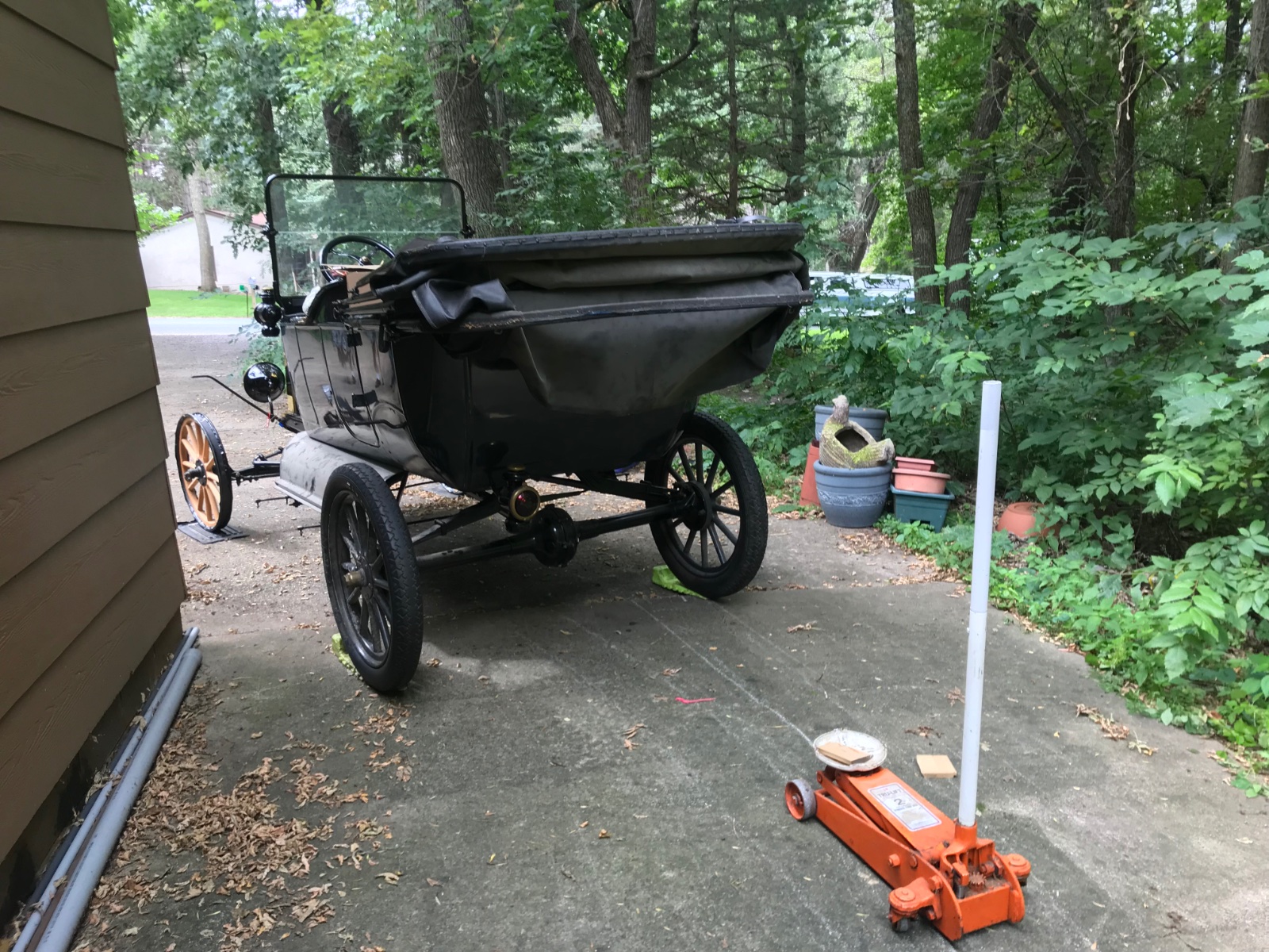

As far as towing "back in the day", a rear wheel could be removed from the axle, this device could be installed over an axle shaft, the wheel remounted on the device, and the car safely towed with the rear wheels on the ground. It was made specifically for this purpose.
Most people mistakenly attribute tool this to facilitating the retrieval of a T that has a broken axle (and it will do that), however that is not it's primary designed purpose.

Take a good look at the tool Scott C shows above. Think about it. There were other tools made to tow a T with a broken axle. The one he shows is made to tow a T with other reasons for towing. The "spindle" is held out away from the backing plate because it is intended to go over an intact axle. If it were intended primarily for towing a T with a broken axle, there would be no need to hold the spindle so far out as usually when the axle breaks, it comes out from the rear end (yes, I do know there are exceptions to that), leaving a close connection practical. Scott C's device is made to clamp onto the backing plate over an unbroken axle.
As Bill D's story illustrates, A T can be towed for some distance IF the U-joint or somehow other drive-line is disconnected from the motor. AND IF the steering, wheels and other pieces are up to the task AND a good well-built tow bar is used. These days, with the availability of proper car trailers, still not recommended.

I recently had a “ locked up “ Model T to pick up on a Sunday kinda out in the sticks.
This Model T belonged to Ken Jones in Minnesota who passed earlier this year - KD used to clean and polish as a kid growing up in Washington state.
This Model T started it for Kim .... :mrgreen:
Larry ended up buying the car to finish restoration.
Like every Model T that I haul - it had an important history .... ;)
It also had no tires - but nice wooden rims that the new owner had tried to protect with blue painters tape.
I called out a rollback tow truck.
We used floor jacks on the rear pumpkin and front axle to lift the T on wood blocks to get it from the rear garage on the property up to the driveway where the rollback could grab it and carefully winch it onto the deck using skates.
Then we transferred it into my enclosed trailer.
This took a few hours - but no damage was done.

I am fairly new to T's, but I don't see how it can be good to force the engine to turn over by towing a T.
And I don't see why loading or unloading one without forcing the engine and drivetrain would be complicated.
But I will soon be unloading one with a locked up clutch, so maybe I will find out first hand just how deep my ignorance is.
I have wheel dollies to put under the rear wheels when I back it off the trailer. Once off I will remove the rear axle keys so I can push it up the driveway. Maybe I am just too stupid or too ignorant to understand how this is a difficult thing to do. And maybe it is not necessary, but it looks like the professionals take the extra time to do it.
I don't see anyone posting to just roll it like it is, so I guess the little extra trouble I will go to is justified.

From you, that is good to hear.
So should I skip the wheel dollies for unloading and removal of the axle keys for pushing up my driveway?

If the clutch is locked-up and you need to push the car up the driveway, instead of removing the axle keys, remove the spark plugs, squirt some oil in the cylinders and push the car. With the transmission in high and zero compression, it should be easy to push.
The bearing surfaces in the motor or transmission will not be bone dry from sitting for a couple years. If lubrication bothers you, before pushing the car, jack up one wheel and crank over the motor by hand a dozen or so times. If the car was sitting in poor storage, I would be more worried about the possibility of stuck valves.
All of the above assumes the oil in the pan is at the proper level.

All good advice for just moving a non-running T a short distance. As your will be up-hill, the dollies under each wheel would make the job that much more fun, esp. with a couple of helpers. Then in your garage you can address what is needed.
Visited this original custom bodied T in south FL, to help the neophyte owner get a grasp of what the Model T is all about.
When there, he said it took 4 large guys to push the T into the garage as the 'clutch was stuck', that is what the delivery hauler guy stated, he had a hard time winching it onto his rig.
Well, that was not the case, they just didn't pull to center the emergency brake/clutch hand lever for 'neutral'.
They all thought hand lever forward was the rear brakes off :?
I showed him to pull back the lever to middle spot, and pushed it easy. So, you never know :D

I would concur with Erik and Dan
Since the car was drained of oil, I'd add some after unloading, before too much more moving occurs... just to get some splashing when flywheel turns, and like they said, pull plugs and put in a little oil and you're golden.
I use dollies in the shop to line up cars for the winter...they're great if you buy the ones with cast iron wheels (they won't flat-spot over time). I'd be leery of using them on an incline, though. Too much slope and things can get away from you. If that's not an issue, then that's not an issue.
Again, good luck.

Used by commercial tow companies to slide a non-rolling vehicle onto a rollback or other tow platform - they slide on diamond tread or aluminum deck or smooth asphalt/concrete roadways.
Typically used at accident scenes.
Wheel Dollies
Typically used on smooth & level hard floors to move a vehicle easily within a confined space.
Both rely on the weight of the vehicle & a smooth and level surface - neither device has a design provision for attachment to the wheel to keep the device secured that I have seen.
In the real world - when you are trying to move a lightweight vehicle that is locked up using either of these devices - on a broken or rutted surface that is not level - the vehicle has a tendency to fall off the device.
In the case of a Model T on nice wood rims with no tires - this can damage the wood rims.
Even with a person at each corner of the vehicle - it can prove difficult.
