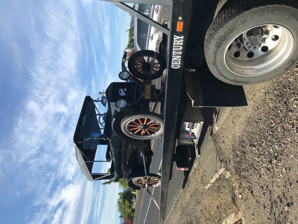

So there’s a first time for everything....first time I’ve had to call a tow truck. Ever.
Transmission nastiness. MAjor bummer.
