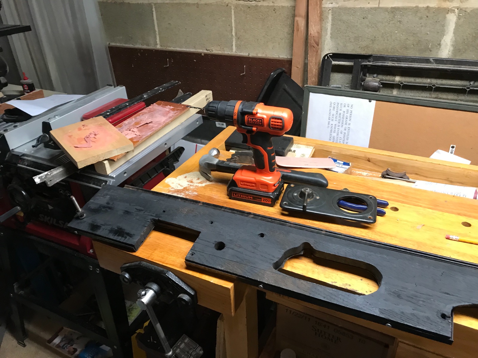

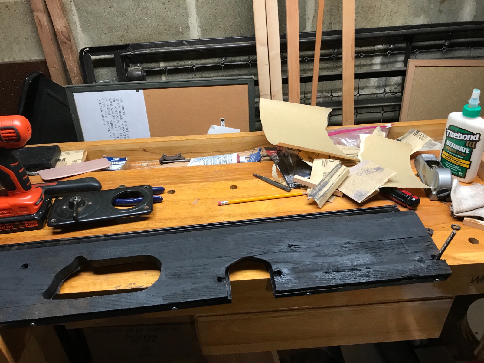

I like to use the original sound wood where possible.
This is the back of the dash. It was broken in four places with one piece of wood missing of the four. I made that piece and glued it all back together.
The two bolts are too long but they were all I could scramble together.
I need to find a Stewart model 160 speedometer to go in that square hole.

Just today, I found the broken piece I was missing on the dash that I made. If I had just dug deeper in the pile.
