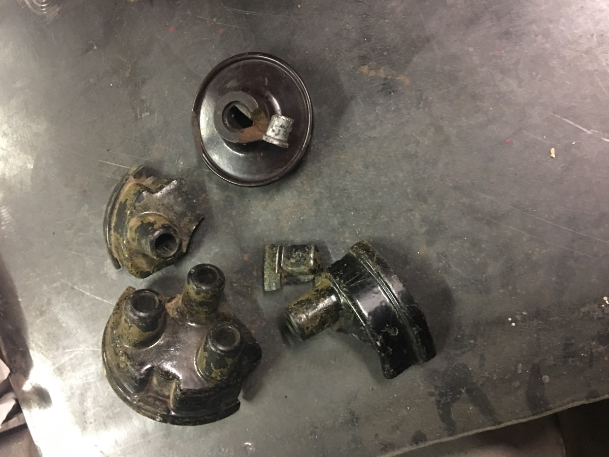

Ok. I recently purchased this Bosch distributor for my Model T. The cap and rotor were broken in transit. I see lots of new parts for these fairly cheap and I’m wording which ones you’ve had good luck with.
Also, how do I tell what model Bosch distributor this is? I see several sites selling parts that fit a 009 Bosch distributor. Not sure if that’s the one I have or not. I’m about to start looking up the info just thought I’d ask first.

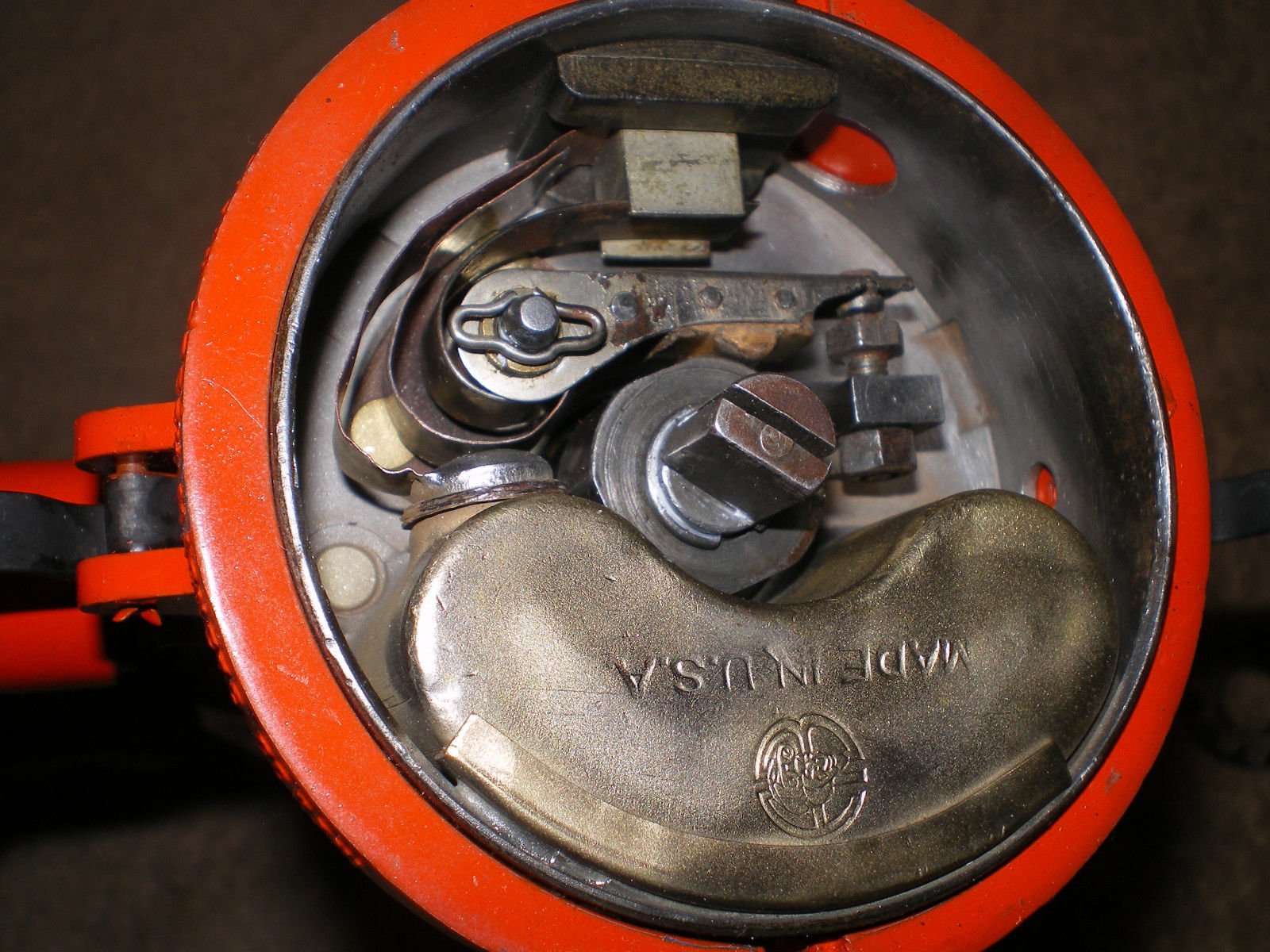

Here are the last 2 pages of instructions plus 2 others. I'm certain that this isn't a Type 600 but a different version of the Bosch 600 based on the bolt clamping the head to the base. I have both versions and there are many differences between the two even though they look quite alike. I believe his is what you should have under the cap & rotor (photo is from MTFCA)

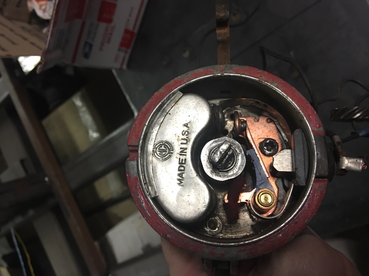

Thanks for the info. I’ll be reading all of that shortly. Here is a pic of the inside.

Posts: 6587
Re: Bosch distributor pieces
Post by TRDxB2 » Sat Aug 24, 2019 5:44 pm
Pete, I think someone has altered the distributor you have. The logo on the condenser is MC not the AB devil's head. The second major difference is the points are set up to rotate counter clockwise and the tip on the came shaft is 100% different. Not sure which picture Hank was referring to.
