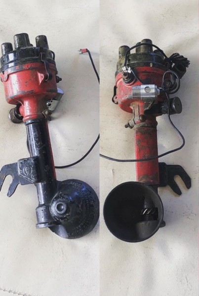

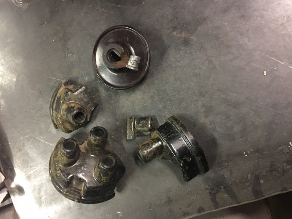

Ok. I recently purchased this Bosch distributor for my Model T. The cap and rotor were broken in transit. I see lots of new parts for these fairly cheap and I’m wording which ones you’ve had good luck with.
Also, how do I tell what model Bosch distributor this is? I see several sites selling parts that fit a 009 Bosch distributor. Not sure if that’s the one I have or not. I’m about to start looking up the info just thought I’d ask first.

From what I can tell this looks to be a Bosch 600. Is that correct?

What you have is a Bosch 600 series fully automatic advance/retard distributor with no provision for manual advance/retard. No parts for the modern Bosch (like the 009) will fit directly. The cap, rotor and points are the same for the 600 series distributor clip on types. I do not think they were the same for the Bosch distributor used on the front plate?
What you really need to watch for is how worn the shaft, cam and housing are. If these parts are worn, your timing will be all over the place.
I do not have a problem with using a distributor so what I am going to say is; I had one like this and really did not like the lack of control by me while driving. Seat of the pants, did not feel it was getting enough advance for today's driving.
The 600 clip on came in several versions. This one, one with combination semi auto advance with manual and I think one that was completely manual(?). The combination version, the advancing mechanism can be locked down and manually controlled.
Get the cap and rotor, install and have fun! It will be another T on the road.

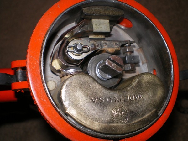

Here are the last 2 pages of instructions plus 2 others. I'm certain that this isn't a Type 600 but a different version of the Bosch 600 based on the bolt clamping the head to the base. I have both versions and there are many differences between the two even though they look quite alike. I believe his is what you should have under the cap & rotor (photo is from MTFCA)

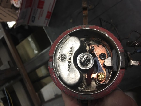

Thanks for the info. I’ll be reading all of that shortly. Here is a pic of the inside.

Pete, I think someone has altered the distributor you have. The logo on the condenser is MC not the AB devil's head. The second major difference is the points are set up to rotate counter clockwise and the tip on the came shaft is 100% different. Not sure which picture Hank was referring to.
