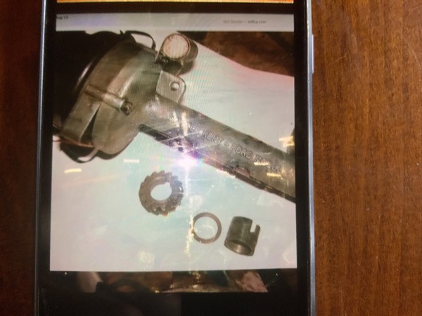

I purchased an Atwater Kent model LA distributor. It’s in excellent condition but
1- I need the condenser
2- missing the spacer and washer
3-any advise on proper installation, timing and setup
Any help that you can give me would be greatly appreciated.
The photo attached is not mine but a similar one for reference
Thank you in advance, David
