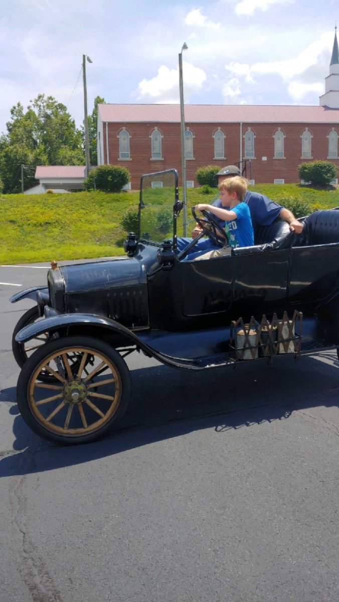

My nine year old grandson driving the '21 a few weeks ago.

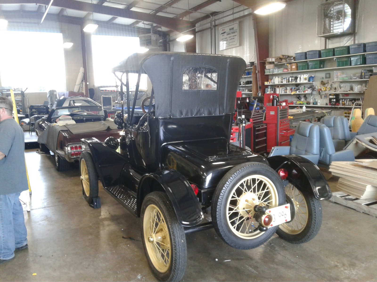

My car also came with an uninstalled top when I bought it, and earlier this month I finally had it installed. The top kit did not have the roll up rear window. I had my top installer add two zippers to the rear panel, so that I can have the increased visibility in good weather of a roll up rear window. While the zippers aren't authentic, neither is any roll up window on a 1915. The installation was neatly done, and I am satisfied with the results.

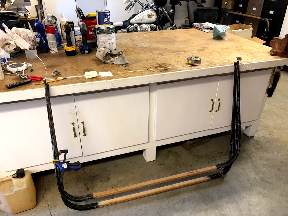

So far I've been the only guy on recent tours with no top on my 1920 touring. But now I see there's a whole club of topless Ts that have been running around. I recently posted some questions regarding the installation of my top bows onto the car that some of you may have read. First, all four top brackets on the body needed to be re-positioned requiring the upholstery to be opened up. Then the set of bows I bought 45 years ago didn't fit right. I think that from just laying around for all that time the corners opened and relaxed to differing degrees which created a lot of pressure when trying to squeeze them on the car. Both top bows and body bracket issues were solved here on the forum. I soaked the corners of each bow for most of a day and then positioning the bows in my vise where the two rivets are, I carefully bent them back into shape, tied them up and let them dry. No cracking of the corner pieces which had concerned me. With new wood installed on the top it's just sand and paint and I'll be ready for the top in the next month or two.
