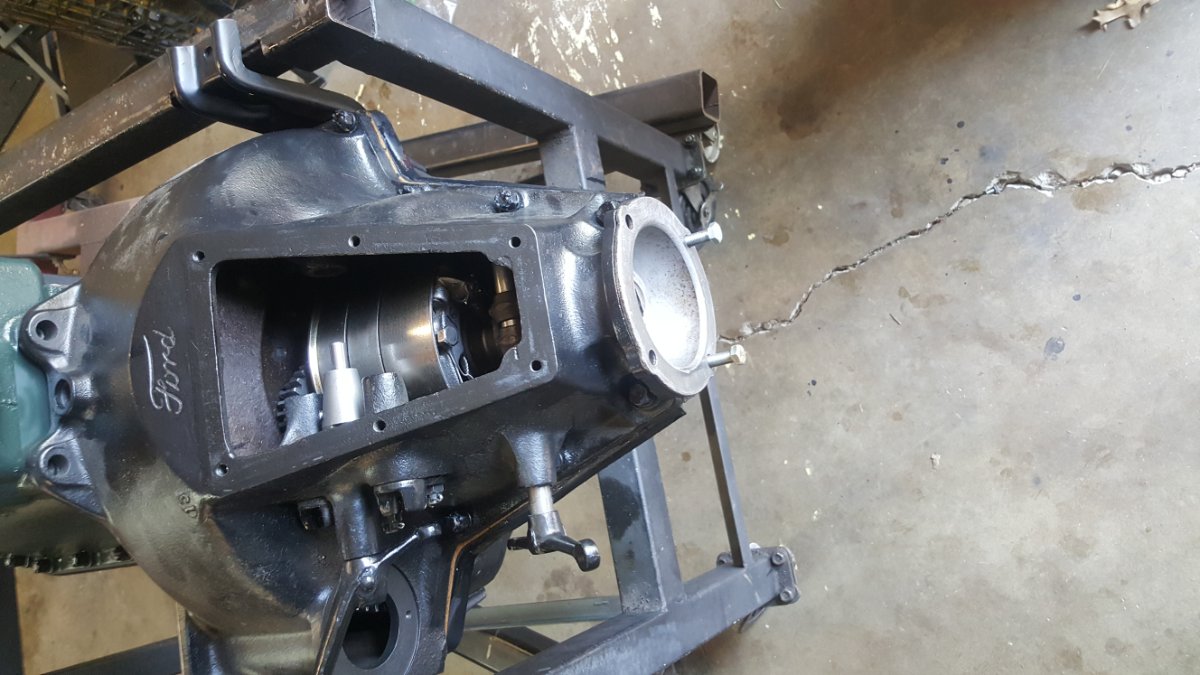

Yatcwhit
- Posts: 16
- Joined: Wed Aug 07, 2019 10:47 pm
- First Name: CHARLES
- Last Name: WHITEHOUSE
- * REQUIRED* Type and Year of Model Ts owned: 16 touring t
- Location: Margate fl
Re: Question about transmission sag
I just replaced my 16 T crankshaft. I put the engine on a stand on and. Installed 4th main with ultra gray TV and bolts. Let dry and removed bolts to install u joint. Fit no.4 main using original with large socket installed with tape shim. Socket drive adapter and battery drill spun with lapping fine compound. Fit snug.greased and pulled the T around the block 3 times to get it to start.fired up .fist attempt. Old crank broke at flange. Suspect improperly installed 4 main. Removed to seal an oil leak. Leak stopped but so did crankshaft.
