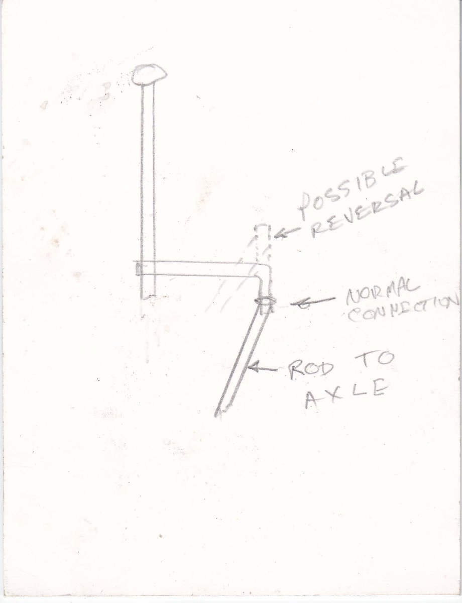

- Posts: 4694
Re: Ruckstell shifts backwards?
You cannot reverse the shift lock on the axle. However, if the rod connecting the shift lever next to the driver to the axle were to be installed above the fulcrum it could shift backward. This would involve modifications to the shift lever inside the car rather than on the axle. [attachment=0]Ruckstell shift.jpg
