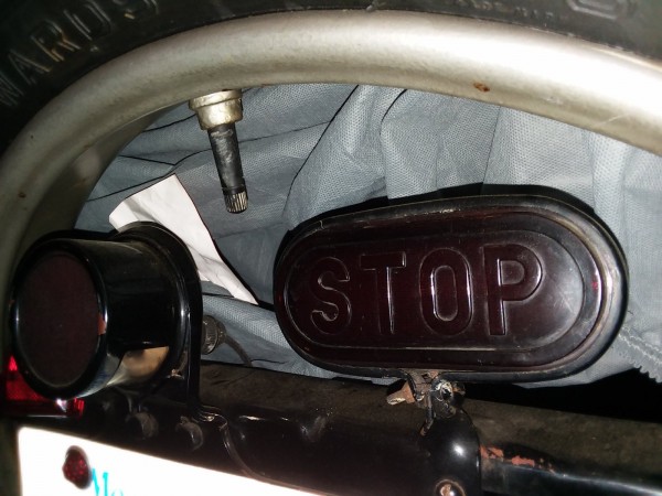

here is a picture of the lights.
I was hoping to be early enough they were not a factory installed item in '23. That way I would not need them to pass.
To answer your tax question. No tax on safety equipment. Just $35 for an inspection sticker.

The taillight is factory, but you have what I believe is a 26-27 style light that was modified.
Yes, the stoplight is an add-on accessory, but I see nothing wrong with adding any safety items.
23 should have a more rounded back and mounts with a stud in the middle of the back.

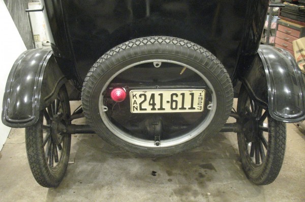

The left one looks like a stock Ford tail light. The STOP light is a swell accessory I would definitely keep. The T did not come with a brake light, but you can add one with a switch connected to the brake pedal.
1923 backside with stock tail light.

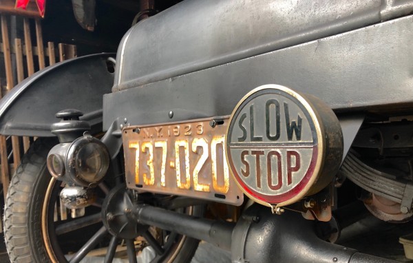

Anyway this is how this stupid yankee has his stop light arranged.
