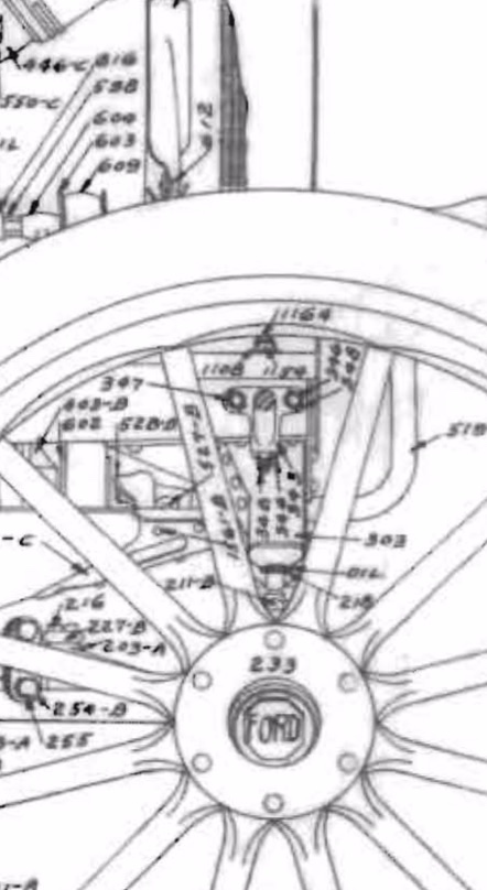

I was wondering where I could find the correct radiator mounting bolt and nut for an early T. According to sources, the 1909/10 T's had a single heavy head, brass plated mounting bolt that passed from the radiator mounting hole all the way through the frame and fender iron, using a brass castle nut to hold it all together. I know the vendors sell the mounting with the small spring but I'd like to use what's correct if I can find it.

The parts book lists that #3929 as 3/8" dia., fine thread, x 3 5/8" long with cotter hole in the end. These were steel, but entirely brass plated.
Restoration Supply Company. www.RestorationStuff.com. has high head bolts that size but only 2" length.
They do have a 4" length, but that one is 3/8" x 16 thread (coarse) so finding a brass castle nut may hard to do?

You are likely correct, that part, 3 5/8" long brass plated bolt was used for 1909. Don't know the date of change, just a guess that when Ford added that flat support strap across the lower radiator core, then the change to the stud and spring. Would place that in the 1910 model year IMO. Unless someone has original 1910's with that bolt.
The bolt is noted in Bruce's CD parts file, p/n 3929 is used for several of the radiator fasteners, but the Factory Number is the key. Fac. # 1106-B is noted for 1909. And also listed for first 2500.
The later stud version, is p/n 3929 stud and lower sq. nut, Fac. # 1162.
The long brass plated bolt goes into the top of the radiator, head on top, and runs down through both frame rails and also the front fender mount, with a castle nut and cotter under. The stud and nut and spring and pad is a better idea.

Bill, that bolt is not used on my 1910. My 10 uses the common stud and spring. I first saw those original Long bolts on a 1909 but I don’t remember the serial number. I think I have the drawing for the bolt, I’ll check and see if there is a revision date.

I found the drawing, that bolt was only used on the first 2500 cars. The bold head was brass plated and polished.
