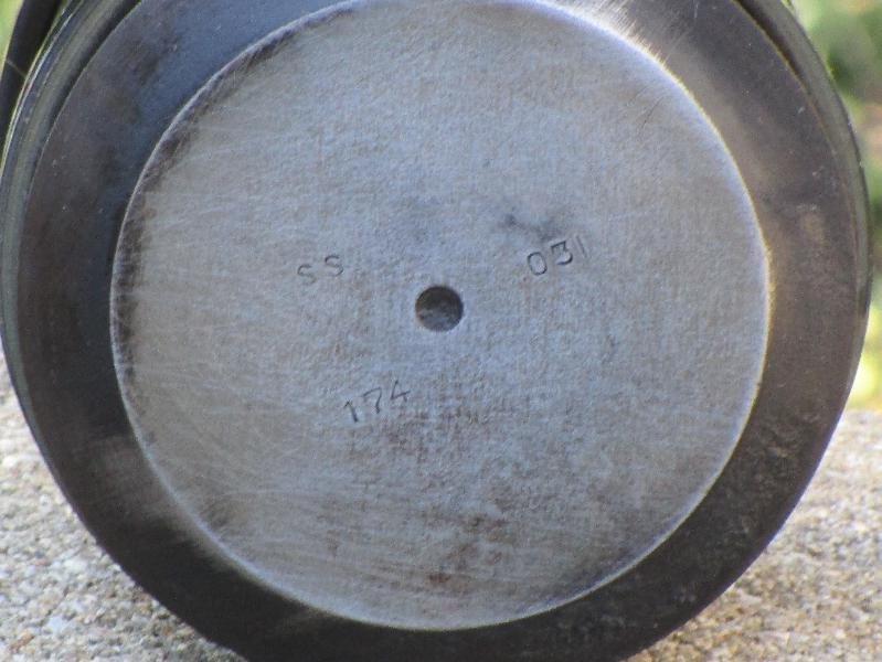

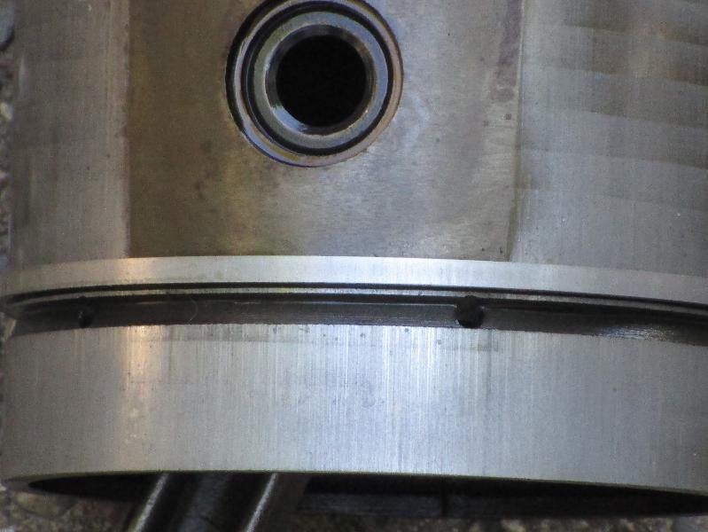

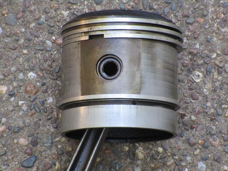

I have redone only about five Model T engines completely, but dozens of Model A's. So, I guess I am still a neophyte in the Model T world. Yesterday I encountered something in a friend's Model T that I hadn't seen before. 'Probably old hat to most of you, but I am stumped and need to know what to do in order to correct what I perceive as a problem.
Some of you may recall the 1924 Coupe my friend bought in late 2017 to match the one his parents owned in the 1930's. Here is the link to refresh your memory: http://www.mtfca.com/discus/messages/70 ... 1513295186. The car is a so-so amateur "restoration" , whose shortcomings have become evident since my friend can now drive the car more confidently. I have always felt the engine was more sluggish and under-powered than even a stock Model T with standard cylinder head should be. It does run smoothly, but just not much oomph. Yesterday we intended to install a new Z head his wife gave him for his birthday (We should ALL have wives like that!). Before removing the old head, I ran a compression check. The car is more than an hour away, so I really haven't had much chance to perform such tests on the engine before now. The readings were 30#, 42#, 25# and 47#. That explains why the car was so doggy with two such weak cylinders. We pulled the head and at least three piston tops were thickly coated with oily grundge. Clearly, a telltale sign that the oil was getting past the piston rings. Rather than just slapping on the new Z head and calling it a day, my friend agreed that we should remove the pistons and re-ring them.
O.K. so far. Problem identified, solution at hand. Right? Maybe. When I pulled out the rods with cast iron pistons, the attached photos show what I found. Are these original Model T pistons? They don't match anything I have pulled out Model T engines. Three top rings (1/4") width) AND one ring almost at the bottom of the piston skirt with a groove beneath that full of holes? The markings on the piston tops are also a mystery to me, as no typical Ford size stamp appears that I am familiar with. Could the "031" be the oversize? Kind of odd, if that's the case. .031"??? All four pistons have this same odd number. The other stampings on each piston top are "SS" and "174". I don't have a clue what that means. Some kind of secret society code? The pistons are secured to the rods with usual bolt.

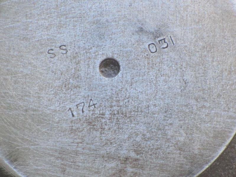

Can anyone tell me, please:
(1) What are these pistons, if not original Model T?
(2) Do any of the stampings indicate the oversize number?
(3) Are new rings available if not Model T pistons?
(4) Should I replace them with new aluminum pistons?
Thanks in advance for your advice. 'Sorry for showing my ignorance. I am still learning about these "T-Model" critters.
Marshall
Marshall

1. Aluminum pistons so not original T
2. Numbers; I have no idea. Stock T bore is 3.750”(or darn close to this)
3. Rings should be available although with only 2 compression rings is more common
4.Low compression, I would have suspected exhaust valves first (especially #4 cylinder)
Hopefully this helps a bit
- Posts: 4408
Re: Help identifying Model T pistons, please!

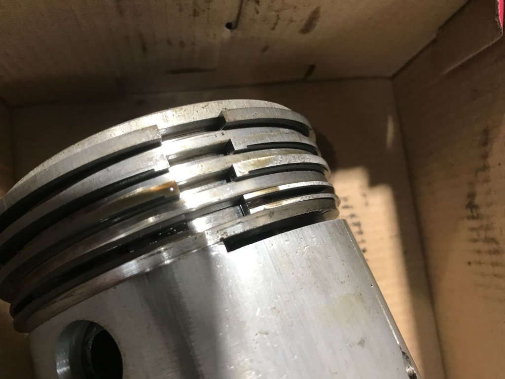

Are you sure those are quarter inch rings? They don't look that large. Cast iron pistons you say?
.031 used to be a common standard oversize for engines. I have a couple nearly new sets of cast iron pistons that size, and I may use a set one day. Why that uneven size was chosen as a standard I don't know. .015 was also a common standard. However, the common standard .031 cast iron pistons used three rings at a quarter inch thick apiece. I have seen four ring aluminum pistons for model Ts, but few and far between, and I don't know if they were made specifically for the T or not (although the tapered top looks like it?).
.030 oversize rings have been available (in the standard quarter inch thick for cast iron piston's size) for many years, and may still be. Again, in the photo, those rings do not look that thick.
Interested in what others say, and Good Luck!

I see wrist pin bushings, aluminum pistons do not use separate bushings. Every thing else looks like normal iron pistons.

A magnet sticks to the pistons, so they are not aluminum. The compression readings were taken from #1 through #4. So, #4 had the highest reading and also had the cleanest piston top, as well as cleanest spark plug electrode. That cylinder is doing what it's supposed to do. The other three are not. The other three piston tops are covered in an oily crud, telling me the rings are either undersized or never seated.
We'll examine the valve seats and heads and if o.k., we'll lap them in. I didn't have my spring compressor tool yesterday to remove the springs and examine the seats and valves. Next time.
Wayne -
You are correct: I misread the ruler. The rings are 1/8". Where are you going to get .031" rings for your pistons? Or do you have an extra set available for sale.
Jim Sims -
You are correct about the pistons being cast iron, not aluminum. Sharp eye!
'Still would like to know if these aftermarket cast iron pistons made for a Model T or some other make made to fit, as Ford didn't seem to offer this kind of ring pattern and odd oversize. Because of the size, that eliminates changing to new aluminum pistons unless the block is bored to go 0.040", right?
Marshall
Wayne -
Jim Sims -

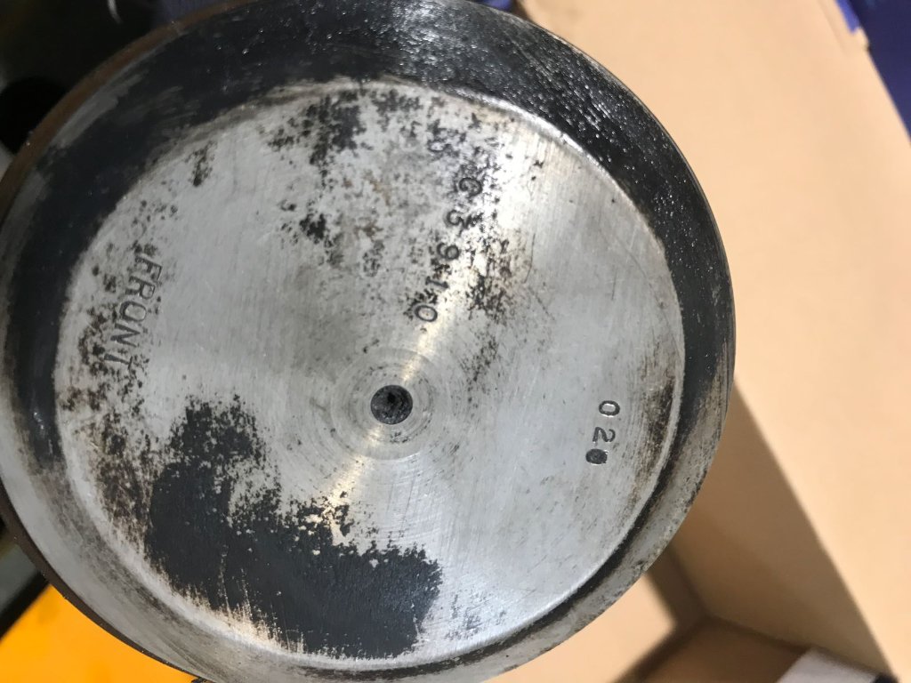

Back in the old days, standard over-sizes were 1/64" (.016") and 1/32" (.032") and they are still that for valve guides & stems. Hence the .015" and .031" oversize pistons. I would run a hone in the bores and mike them. IF they are round and plus .034" over or less, you could go to a .030" Aluminum piston set. The extra couple thou won't kill you, the max tolerance for new pistons in an old bore is +.004" on the bore size, or 3.784" in your case. Might be a little noisy on starting cold, but noise will vanish in a couple minutes, I had a 27 Tudor with this same situation. One of the best running T's I ever had though.
If its over that, you can hone to .040" over and go up one size, but that probably entails pulling the engine, which opens up another whole can of worms. Good luck! Best Jeff

As they appear to be “ordinary “ widths, then replace with.040 and spend a little time filing the ends to get good fit. EASY PEASY!!

FYI, I do have a set of .030 oversize rings for my .031 oversize pistons, however, the pistons are cast iron and take quarter inch rings, which mine are so they won't do you any good anyway. You may need to special order rings, but they should be available to fit those pistons. Changing to aluminum pistons would be a good idea (although some crazies like myself do like cast iron pistons?!). One used to be able to buy .030 oversize pistons, but I don't know if they are available "off the shelf" anymore or not. Larger oversize pistons can be turned down, even cam ground by good shops, and even"blank" oversize are usually available to be custom fit.
Always, carefully check the measurements before ordering any pistons. Not simply the bore size, but taper and oval wear. I personally like using a ridged hone to straighten a slightly worn bore. However, one must be careful that the wear has not drifted off center too much with a ridged hone because the hone will self-center to the wear. If a cylinder is worn off center too much (they ALL wear off center somewhat), it must be cleaned up with a properly setup boring jig in order to regain proper center alignment.
Les S mentions the two-piece valves. I think that bears repeating. I consider two-piece valves second ONLY to Babbitt thrust washers in the MUST BE UPDATED list. Such an easy fix. Even for a broke fellow like me? Not that expensive. And SO much damage can be done by a valve breaking at speed. (Thank you Les S for bringing it up!)

Look at the lowest groove in my first posting photo. This does not look like an oil scraper ring to me. It appears to be just another compression ring. Maybe that's why oil has worked its way onto the top of the pistons + four compression rings, no dedicated oil scraper ring. Were the wrong rings installed in this groove? This lowest groove is for the oil scraper ring, isn't it? Isn't the lowest groove in a piston always reserved for the oil scraper?

Piston/ring/cylinder debates have been ongoing for well over a hundred years! Any full discussion would fill hundreds of pages in a book. In short, several major factors must be considered. Piston material, piston design (Cam grind? Slotted side?), oiling system, water jacket design and water flow characteristics, are all high on the list. Even ambient conditions and the radiator quality and design sometimes need to be considered. My opinion, and the opinion of many long-time model T people, is that a model T piston NEEDS to be more loose than almost anything manufactured in the past half century.
Pistons should be checked for fit and clearances. The needed clearances vary greatly based upon piston material and design. Cast iron pistons can be MUCH tighter than aluminum pistons due to the differences in the coefficient of expansion characteristics. Some model T cast iron pistons can be set up with only about .002 clearance (the Chevrolet "cast iron wonder" was recommended .0015!) (all measurements given are of course decimals of a USA inch). They can usually be run safely all the way up to a rattling .010 (many years ago I ran a Chevy cast iron wonder for many tens of thousands of miles with a quick freshen of a badly worn .019 tapered bore!), however, that is not recommended.
The point of some of that, is that a .001 difference in old versus new standard oversize is not something to be concerned about.
Aluminum pistons in a model T fit depends a lot on piston design. I get tired of seeing "fit measurements" given without piston specifics. Roughly speaking, round (not cam ground) pistons without a skirt slot, need to be pretty loose. .006 minimum feeler gauge between one side piston and cylinder. I prefer .007 myself, that design piston tends to have thermal expansion and seizing issues. Cam ground varies based on the degree of grind, but generally reduces the needed clearance slightly. A slotted skirt also reduces the needed clearance slightly. MY opinion, a model T even with cam ground and slotted skirt aluminum pistons should have a feeler gauge one side clearance never less than .005, and I prefer about .006. Again, like the cast iron pistons, a .010 clearance may rattle on cold startup, but can often run for many trouble free miles.
On a model T, a bit loose is better than a bit tight.
Running one good condition used ring amongst a set of otherwise new is not a bad thing (as long as you KNOW the old ring was carefully removed and not fractured in the process. Which groove should get the used ring? Is debatable. I tend to believe the top ring should be a new one. As far as holding compression is concerned, each successive ring holds against less and less compression as the rings above keep reducing it. But whether a worn ring above reducing the compression somewhat for the new ring below is better than the new ring doing a better job reducing the compression for the weaker worn ring below is an interesting debate that can go on for hours. (Non-engineers have NO clue what it is like to be an engineer and get into such debates!)
Ring design is another huge subject. Some rings do not have an "up" or "down" side. Many other rings that distinction is CRITICAL! "Scraper rings" generally (not always) have a square cut on the bottom side of the ring. These MUST be put in the correct way because if they are upside down, they will push the oil up instead of down. I have taken apart a few engines that previous people had installed some or all such rings the wrong way. This nearly always results in an excessive oil burning issue.
SOME oil rings also have no up or down. Many do, and many are not well marked. I picked up a new-old-stock set of rings awhile back, and the instructions are missing. (Ah, the joys?) I tried to find something online to identify the specifics for installation, but found nothing helpful. I do hope I can figure them out? I know I will be using a magnifying glass when I look them over.
Some compression rings have an angled cut (chamfer) on the inner edge of the ring. These, the chamfer must be on the TOP side. The theory is, that some compression flows down from above and around the back side of the rings, the chamfer is supposed to capture the expanding gasses which in turn push the ring outward helping to create a tighter seal against the cylinder walls. Many engineers cry hogwash to that theory, but that is the theory. (Personally, I tend to think the theory is hogwash.)

Aren't new rings for cast iron pistons 1/4" thick? The ones on my friend's pistons are only 1/8".

Ted is saying to use the 1/8" aluminium piston rings on those cast iron pistons.

Aha! The light bulb finally turns on! THAT was the missing piece of the puzzle = the rings from aluminum pistons will fit the grooves in these cast iron aftermarket pistons. My mindset was focused on cast iron pistons needing rings made for cast iron. But you are saying I can mix and match? I dug out some old aluminum pistons that I had replaced in an engine a couple years ago and compared the grooves in them and the rings to what those aluminum pistons used. Sure enough! They are a match! 1/8" thick, 1/8" wide. Once I measure the wear in the supposed 0.030" over cylinders tomorrow, that will determine whether we can use 0.030" or 0.040" rings on these cast iron pistons. Thanks, Kerry and Ted. Those were the answers I needed!
So, let me see if I have this straight before spending my friend's money: you're suggesting the new ring set be placed in the top three grooves of the cast iron pistons, oil ring in the bottom of those three, and re-use the bottom ring in the fourth groove below the wrist pin. Correct? What was the purpose of that lowest 4th ring. If it was to serve as an oil scraper, it didn't do its job, if the oily grundge on top of the three pistons is any indication.
Yes, our plan is to hone the cylinder walls prior to re-insertion of the pistons with new rings.
Marshall

I have a similar, but slightly different problem: 4 groove aluminum pistons, with really big ring gaps.
Just today I pulled the pistons from a 27 engine that I purchased to replace the tired unit in my 27.
It is low mileage, and so the plan was to take it apart, check all the clearances, address any issues, and put it back together.
The pistons are aluminum 0.20 over and have FOUR rings. I will try to post a picture tomorrow.
All that is stamped on the top is "front", and ".0020"
I was told that it had new pistons because the originals had frozen in place.
New in this case is a matter of some creative interpretation, as they have some carbon in the center that looks like they were used for a while somewhere. So they are new to this engine anyway.
Indeed everything in the engine and transmission agrees with the description (without creative interpretation, I'm happy to report). (the only new parts had to do with the pistons, still some shims on the mains, (though checking the clearance suggests those shims need to go.)
I was able to check for taper in the cylinders and there is none. So it looks like the cylinders were cleaned up and these pistons fit the bill.
I plan to check piston and cylinder diameters next, if that's ok I'm happy to use these pistons. It's the rings that have me concerned.
The issue that has me stopped in my tracks is the ring gap:
I checked the top 2 rings on one piston, and they each have more the 0.030 gap.
So, now what?
I've looked, and no one seems to be selling ring sets for four groove pistons (0.020 over)
(Assuming my existing rings measure 1/8"):
Can I use 2, 3-ring sets and use (the extra top ring, or the extra 2nd ring) for ring 2 or ring 3?, or
Is there some other way to get a set of 4 rings?
In addition to what rings to purchase, I would like to know:
- which ring to double up on? wand which groove to put it in.
- how to orient each ring, and
- what ring gap to use for each?
Any help on this would be most apricated.

.031 was an original Ford factory oversize. The other factory oversize pistons and rings are .0025, .005, and .033. From Ford Service Bulletin Vol.5 No.6 Pg 45 , June 1924

I think you are forgetting one important step. Mic the cylinders to see how much they are worn. If they are over limits putting new rings in won't cure the problem.
- Posts: 7279
I'm with Chris. If they are .031 oversize pistons with a worn set of rings, the bores will need measuring for wear and taper. Plus, if they are worn, a rebore to take .040" oversize alloy pistons may well not clean up the bores. Your machine shop will be able to advise you once they have measure and perhaps test bored a cylinder or two.

Attached are the proverbial 2000 words.
With regard to bore diameter, I haven't forgot about it. I expect it will be suitable for 20 over pistons. I will check as soon as I get my hands on a 4" mic. (I've got one coming in the mail)
I was able to check for taper and there is none. Therefore, I don't plan on any significant increase in the bore diameter.
All the information I have seen says the ring gaps should be like 0.012 to 0.015 ish.
My gaps are > 0.030! Therefore I need new rings (at least). Or do I? Could it be that these pistons are meant to have 30+ gaps?
The question is: where to buy them? All the ones I see for sale are 3 ring sets, not 4.
If I buy 3 ring sets, do I buy 2 sets and use 2 of the middle rings, or 2 of the top rings, or as was recommended by ____ 2 of the oil rings?
Or I could leave one ring out? (I think I can rule this out, unless someone has had a positive experience with this approach.)

Note the markings:
C3910 020 and FRONT

Also note the ring profiles.
top appears to be square
2nd and 3rd have a taper.
Thanks for the link Mark.

Cast iron pistons that look like aluminum are probably tin plated.

Those after market cast iron pistons may or may not be made for a Ford. The SS 174 most likely means Standatd Size. The Ford T standard size is 177 CID. The 0.31 is the over size as has been said. Frist check the cylinders for current size and uneven or taper ware. If the engine doesn't need to be boared, and you don't want to go to 0.30 aluminum pistons you could try to find a useable set of 0.031 Ford cast iron pistons that you can get rings for.
