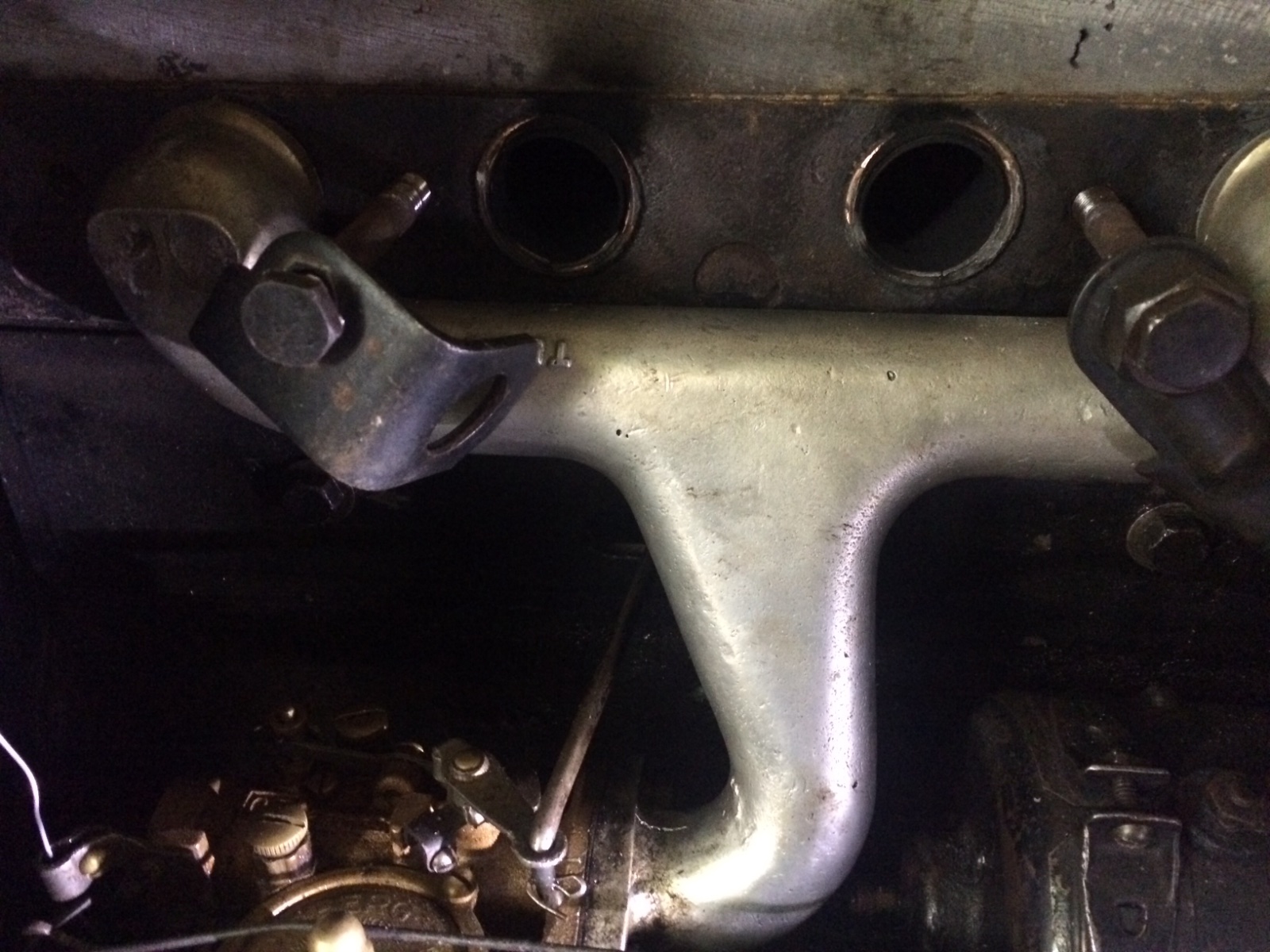

I had used the paper gaskets when I swapped manifolds and a refresh last summer. (I had them) Go figure, the back port let go.
Got some copper rings and the gland rings from Snyder's and swapped them out the other day.
Had a little difficulty getting the center to fit, but thought I got it. Not so, the bottom of the center ports didn't go together and bent the rings. Took it apart today and the copper rings were reusable and I used two old steel rings on the center ports. Everything seemed to draw up evenly this time. Took a cool down break and have to connect exhaust pipe and will let you know.
I think the new steel rings fit so tight in my manifold, that they caught instead of slipping together. This manifold was a NOS and was straight...

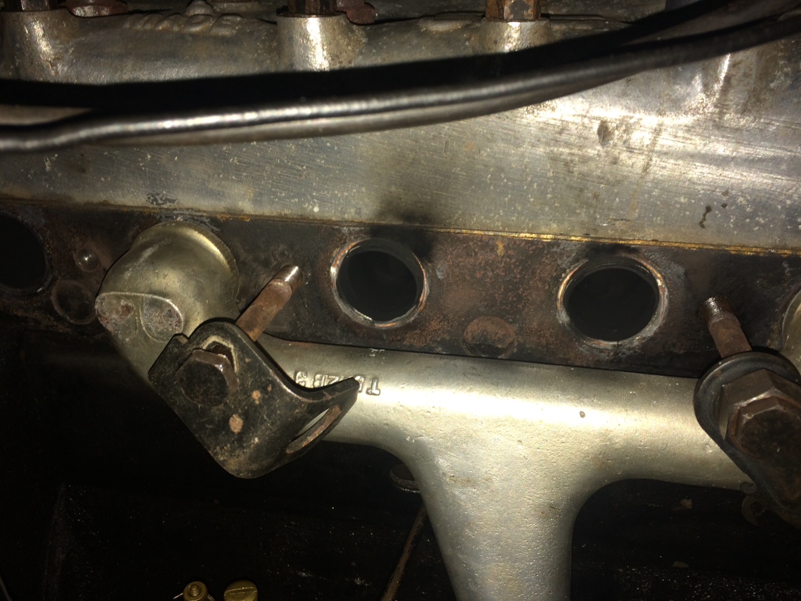

Jerry, I used the steel gland rings with the paper (asbestos) gaskets.
Installed the rings I tried to use the other day, got everything to line up, but the rear port ring must've been crushed too far for reuse.
A friend had a set of the 3-1 copper gaskets and I really didn't want to wait and order more rings, so far no leaking. And yes I used gland rings with them.
The first try, you could see the manifold was tighter at the top and actually hitting the cylinder head. Now it is flush.

Turns out my manifold was warped slightly, enough where the rear ring was not lining up right.
Found another one with nice threads and straight !!
Everything went well until the third bolt broke off in the block...
It was not coming out with an EZ-out, drilling out proved to be a little bigger than I wanted, do to the drill shaking, I think.
Any how, Friday evening, trip in the am, and stuck. found a 10mm tap and it fit pretty good, soooo 10 mm it was for the trip.
Nobody around had a 3/8-24 Heli-coil at 7pm Friday. And nobody noticed the 15mm head amongst the 5/8" ones !!
Got a kit on E-Bay and rethreaded it yesterday, insert went in nice and all is well. New bolts, chased the other threads and no more "puff puff"
