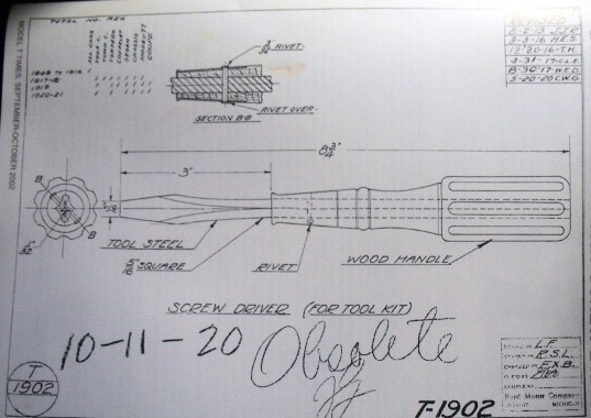

Factory print if anyone wants to replicate. Just don't add Ford script, it was never there anyway.

Dan, That drawing is fantastic. That's what I was thinking of doing. I located a company who can make the handles with the proper fluting and another that may be able to do the assembly. Before I went further in my effort, I wanted to make sure that I'm not the only one having trouble finding one in nice shape.

The print Dan has posted shows the blade to be made of tool steel which indicates it’s a quality piece of steel. But the information for the wood handle just says a “wood” handle.
If the screw driver was to be reproduced I wonder if there is a source for the type of wood that was used.

The shaft is square all the way stem to stern. That shows on the print, too. The much later , ( model A, v-8, ford tractor) screwdriver had round steel all the way through.

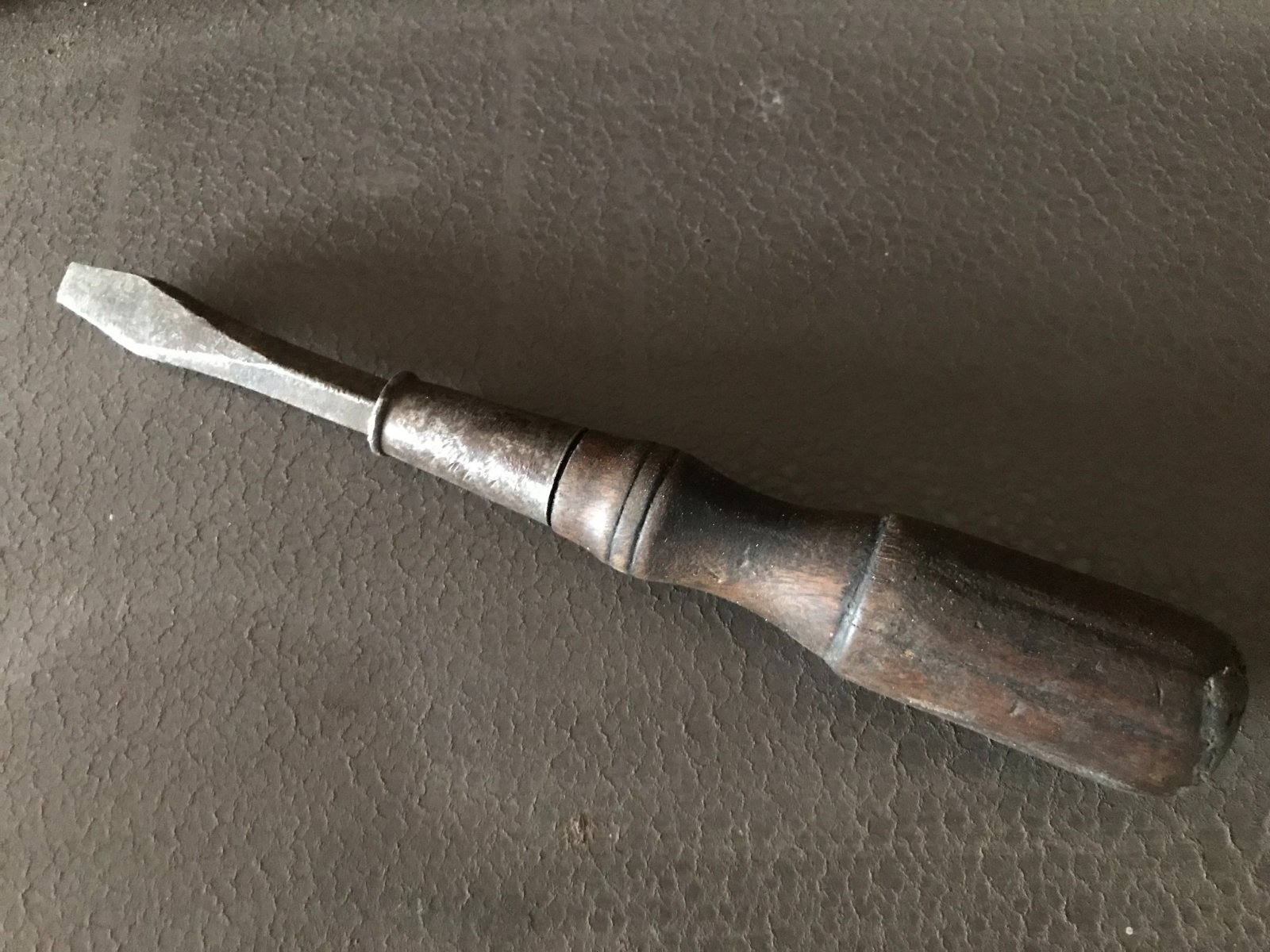

I have probably one of the best ones in existence. It still has the original black paint on it, and doesn't appear to have been used much. I used this screwdriver in an article on Model T tools I wrote for the Vintage Ford many years ago.

Richard, these two will be $80 each, postage paid to a USA address. I have blades to assemble more, but I need to have more handles turned before I mill the slots in the grip. Subsequent ones will be dearer due to postal charges.
These screwdrivers are somewhat unique in that they have 8 grip slots in the handle. Most other screwdrivers have smaller diameter handles which means 6 grip slots.

Richard, I had a nice piece of teak left form another job which fitted the bill. It takes the black paint well, soaking it up so it looks much like a stain.
I don't plan on making heaps of them. Finding suitable old square blades and ferrules to use is difficult at the best of times, so I can only do them as blades come along. This means I am really limited in numbers. The last 6 I did took me 5 or so years to find the blades. Then I have to talk my nephew around to have him turn the blanks. I think Queensland hoop pine is a better match timberwise to the original timber used.

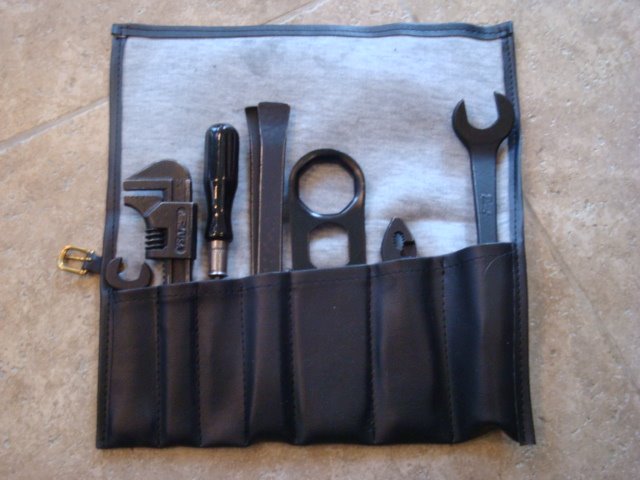

I am certainly by no means an expert, but I had read the previous forum posts on screwdrivers when they came up, and here are my conclusions, and again I am no expert.
1.Ford didn't make their own screwdrivers, they were manufactured by outside suppliers.
2. Because of the volume of cars produced before 1920, there was likely more than one supplier involved. These suppliers were the manufactures that likely made screwdrivers for other customers in addition to Ford.
3. The screwdriver is one of the hardest tools to find for the tool kit. I believe this more due to the fact that the screwdrivers are unmarked, rather than the fact that the screwdrivers were discontinued after 1920. Other tools had running changes over time (spark plug wrench, adj. wrench and such). and it is relatively easy to find examples of each style. But not so the screwdriver.
4. Since there were millions of screwdrivers produced, there must be thousands still out there. Folks generally don't through away a screwdriver, even after it becomes too battered to use as a screwdriver. It gets relegated to the screwdriver that is used to open paint cans and such, to save the "good" screwdriver. Because the screwdriver isn't marked "Ford" folks that have one don't recognize its collector protentional, and so it just sits in their tool box or "junk" drawer.
5. The screwdrivers that came in new, 1920 and earlier Model T's, probably didn't all match the print exactly. I suspect, most of them didn't match the print, or we would see more "Ford Model T" screwdrivers out there. After 1914 production of Model T's really took off, as did production of other cars such as Chevrolet, Dodge, etc. These other cars came with tool kits including screwdrivers also. If you were a buyer for Ford, you would not want to be responsible for holding up production because of a shortage of screwdrivers. You would have bought a screwdriver "close" to the print that would have functioned the same. Probably some Model T's came with screwdrivers that had a round instead of a square shank. We will never know for certain, since the only documentation on the screwdrivers is the factory print. Plenty of Ford owners took photos of their new car, nobody took a photo of their new "Ford" screwdriver. You may have an authentic "Ford Model T" screwdriver and not know it, and have no way of proving it.
6. I am not an expert on judging, my understanding is that while more points are awarded to a screwdriver that matches the print, one would still get most of the points as long as you include a screwdriver of the approximate type. Not having a screwdriver that matches the print exactly would probably not be critical in the ranking of your car compared to others, as long as you include some type of period appropriate screwdriver in your tool kit. Again I am not a judging expert.
7. When my Dad passed, I went through his wooden handled screwdrivers to see if any of them matched the Ford print. None of them did. I took the best one I could find and repainted the handle, and this is the one that I carry in my Model T tool kit. Where ever I go in my T, one of my Dad's tools goes with me. What I lack in authenticity, I make up for in sentimentality. If I ever have my car judged, I don't believe my screwdriver will be a critical factor in the judging results.
8. Again I am no expert, these are just my conclusions based on what I have read on the forum and the various Model T publications. Here is my tool kit:

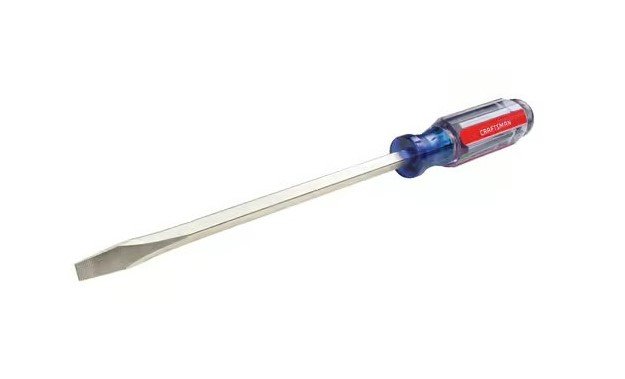

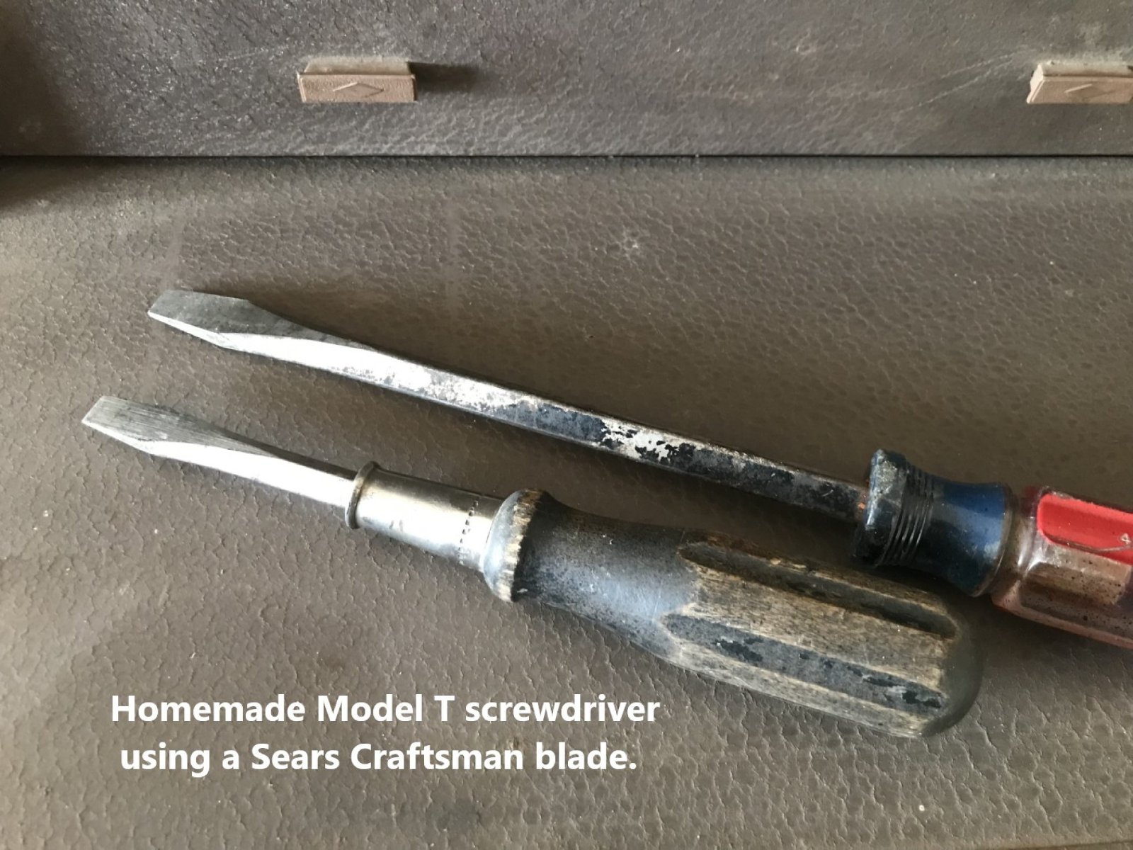

One could look into using Sears Craftsman blades to build completely new screwdrivers.
Sears Screwdriver.jpg (8.99 KiB) Viewed 4735 times
I like to make Model T type screwdrivers by combining blades and wood handles found at swap meets.
Got one in each T now.

Nathan, Thanks for the tip on a modern donor for blades. I have found similar ones here but often the shoulders on the square are a little rounded off, and it is difficult to remove the plating on others. If one goes to the bother, it is better to get the details right. The original handles on the factory drawing are a different shape coming out of the ferrule, and, instead of six flutes they have eight flutes in the handle which terminate within their length. Lang's had some reproductions a while back, but these too had a problem. The point on the blade was forged with the square on the flat, rather than being formed with the square on the diagonal. It makes for a very different looking point. T modellers who seek to build an original kit of tools like to have them correct, not just usable.
Nathan's find is an original. Its handle is well worn, such that the flutes have almost been worn off. It has been pounded on so that the end is mushroomed , further damaging the wooden handle. All this is to expected in a 100 year old tool. I would not touch its original appearance.

Good insights, Allan. You're just the right fellow to make these!
And yes I will plan to keep the screwdriver I found in it's original condition.
They are really cool tools.
