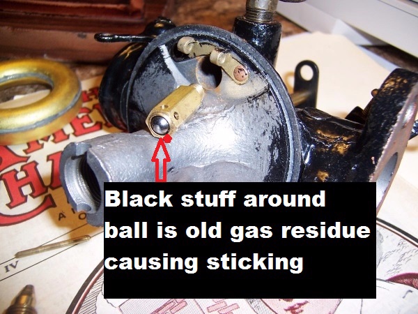

Have always had problems with Grosse, seem to stick open or closed for any reason, most for me is from gas setting a while, other times from additives in todays gas that dry and deposit on the ball. Maybe too is these are china made, balls can be tiny bit out of roundness, seating poorly. :shock:
You know my fix :D Go with Ford. 8-)
