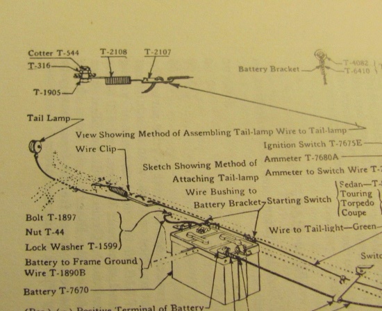

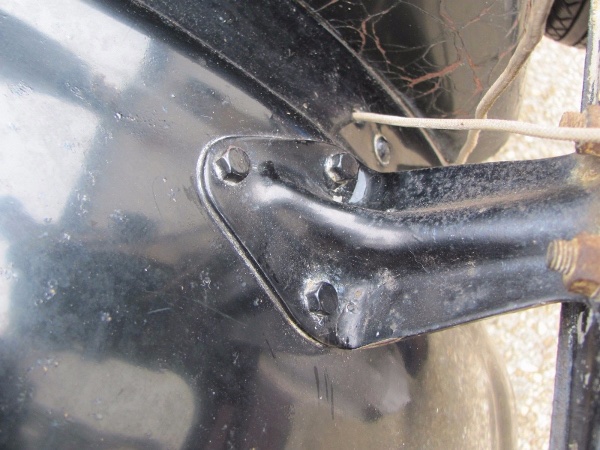

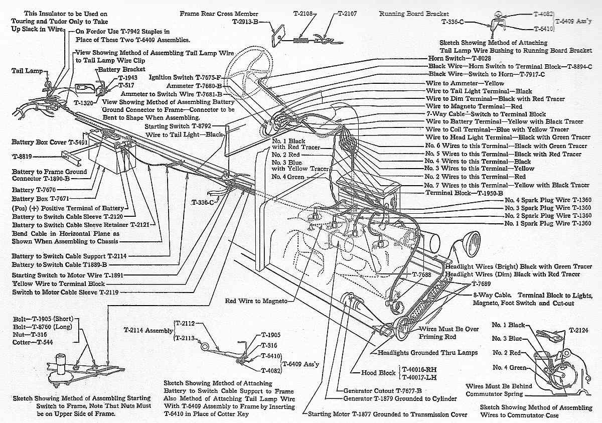

Ford Service manual has chassis wiring diagram, and Service Bulletin shows same enlarged.
The coupe and runabout have a small hole in the left rear fender flair to the lower body, pass the tail light wire into the hole to bring it to the tail lamp.
