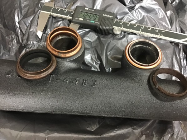

I have one on the bench here and made precision measurements with a telescope gauge and micrometer. The holes are 1.247” to 1.250”. If the target size is 1.250”, then these holes are .003” undersize. I wonder if that is outside of spec on the Ford print? Anyone have the print?
I only use the original style copper / steel ring and gland set and have had no issues.

Just measured a new manifold on hand and the port i.d.’s run about 1.242-47. Don’t know the Ford spec.
The std.repo Ford steel glands are split to adjust, some need filing to open gap if gland doesn’t seat. Or you can spread some. The copper compression gasket rings fit over and get compressed to seal.
As for the one-piece gaskets, have tried, but for me don’t seal. The copper or brass formed part seems work hardened and can’t be compressed at all, and stood too proud off the block. Don’t know if parts meet Ford spec for I.d., but at this port only one side of the new one-piece fits into a port.
Prefer the repo glands and copper sandwich gaskets with a new repo manifold.
