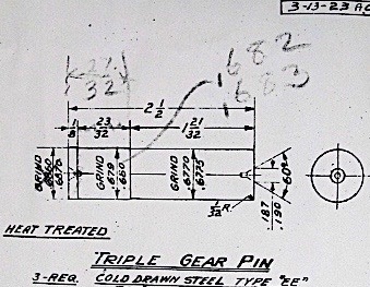

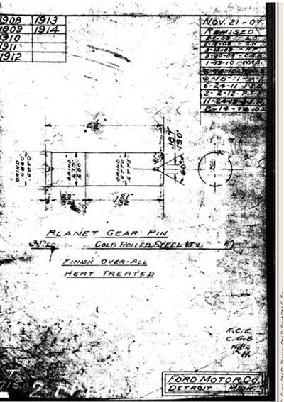

Follow up on triple gear pins.
The Ford data is for that part # 3315, Fac. # T-715.
Earlier post, like the one Donnie posted above, list the dimensions of that original triple gear pin. Those dimensions are for the original factory pin, but when correctly removed, the flywheel hole is enlarged slightly by that original pressed in pin.
Original T-715, note the end has 1/8" added ridge to really lock it in place. Original pins up to 1919 were type 'N' steel, heat treated. Later pins are type 'EE' steel.
This print is Ford for the triple gear T-715, but had markings on it as acquired at Benson, it lists the 'EE' steel heat treated and is dated to 1923. I believe those markings in pencil are the correct dimensions for the oversize pin, listed in parts catalogs as the 715AR. This one is for field service in replacing a triple gear pin.
The pencil marks show the little 1/8" shoulder is now gone, the overall length of the end in the flywheel is lengthened, and that end is 27/32" long, and the new oversize is .682/.683" which provides a .003" oversize from the factory pin.
