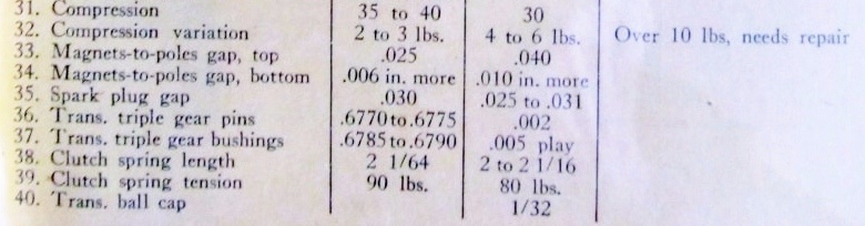

Post by DanTreace » Mon Sep 09, 2019 12:25 pm
Philip
Here are Ford's service tolerances, 1st column is factory new, 2nd column is allowed service tolerance, when over/under tolerance, repair or replace.
If the gears are very nice, and bushings have proper service dimensions on the pins, one can reuse.

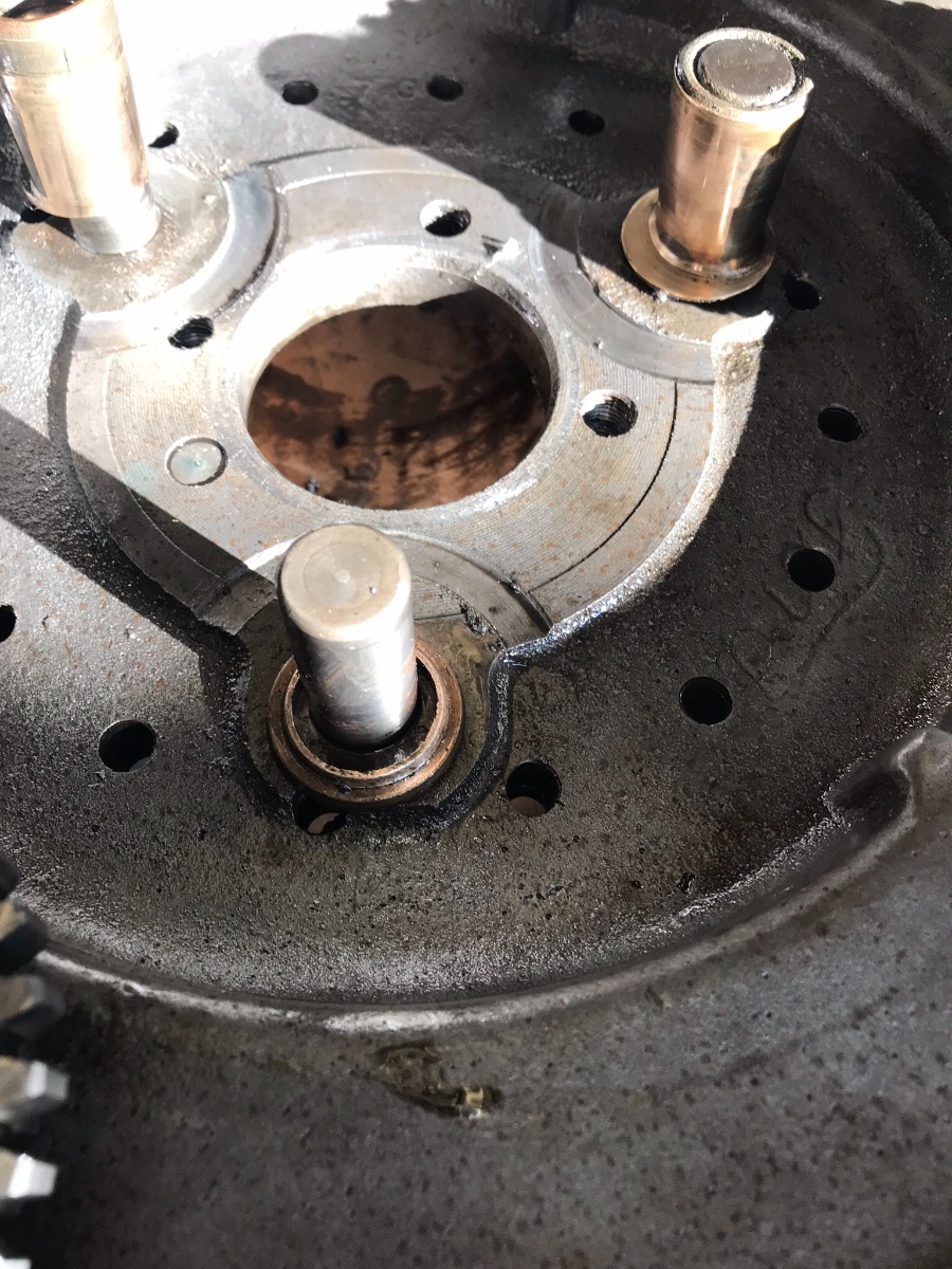

Post by Scott_Conger » Mon Sep 09, 2019 11:07 pm

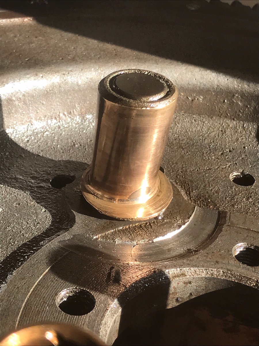

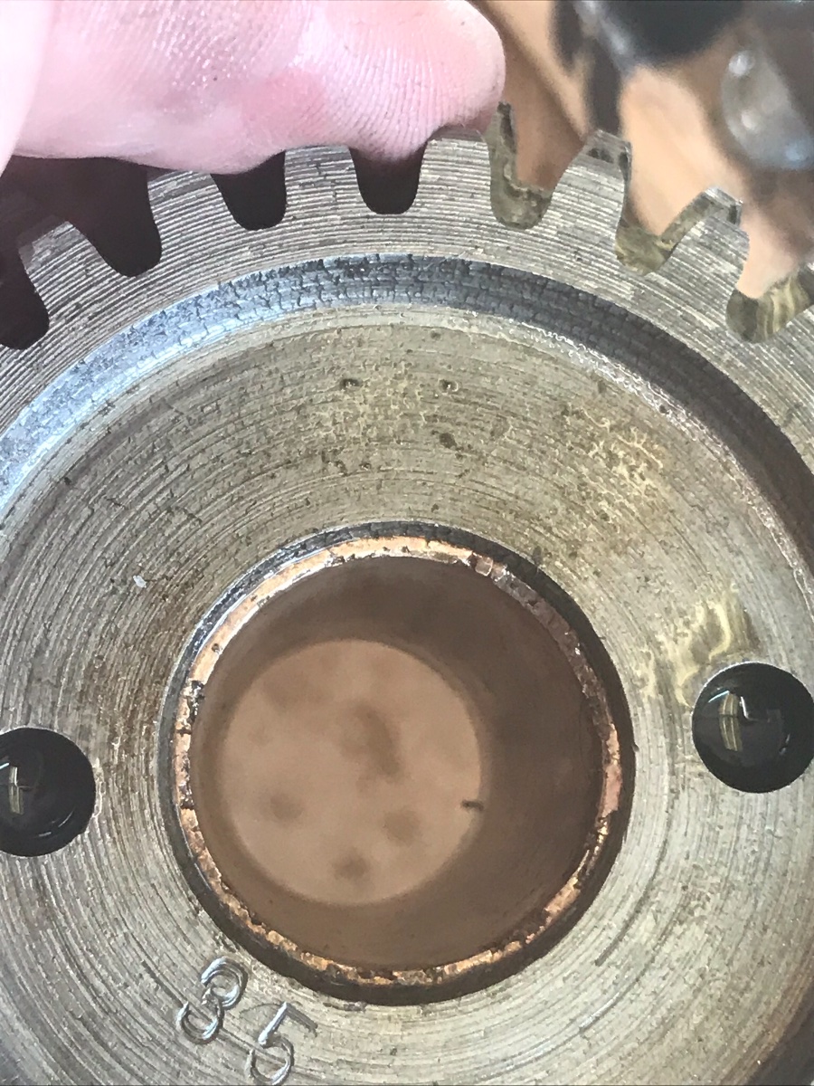

I've never seen a bushing wear so thin as the one that has left only the thrust remainder on the flywheel, nor have I seen a spun gear wear out the bushing quite like it did. Often times, even silent transmissions have a bushing welded onto the pin and spinning happily within the gear. This looks like a lubrication problem to me. Chicken or the egg...who knows?
It also looks like the drum assembly was not stable within the triple gears and wonder if the front bushing on the brake drum destructed first and oscillated within the triple gears. Oh, to be there for the teardown...

Nope. 2 of them spin freely on the pins and all three wore basically the same - look closely at the gear wear pattern in the flywheel that shouldn't be there. Funny how so many folk "know" exactly what happened. As a trained engineer, what I know is that is all speculation at best. I am up for testing the metal though... not that it will ultimately lead to anything conclusive.

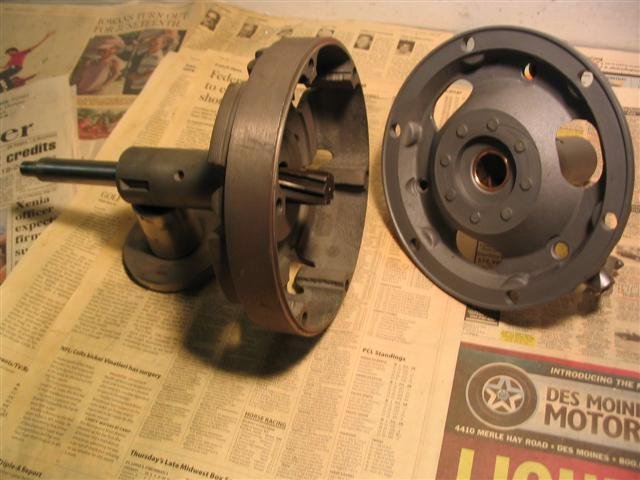

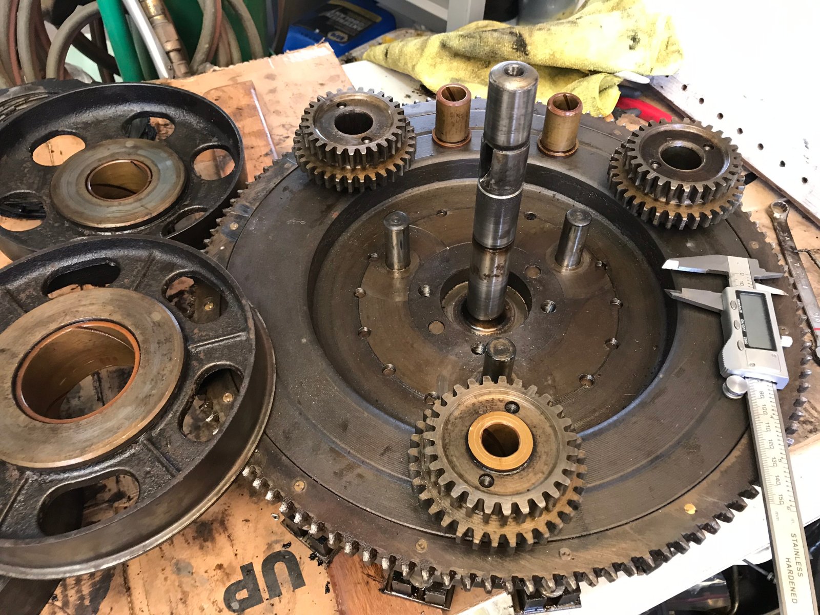

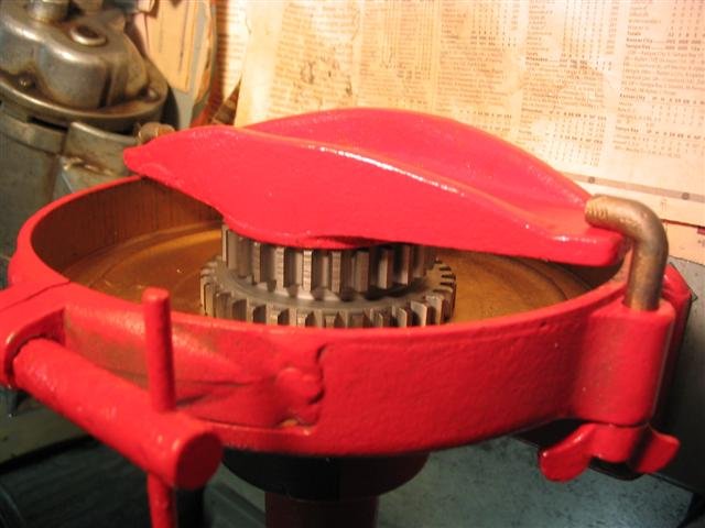

Post by Kohnke Rebabbitting » Wed Sep 11, 2019 10:49 pm

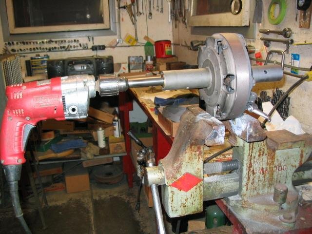

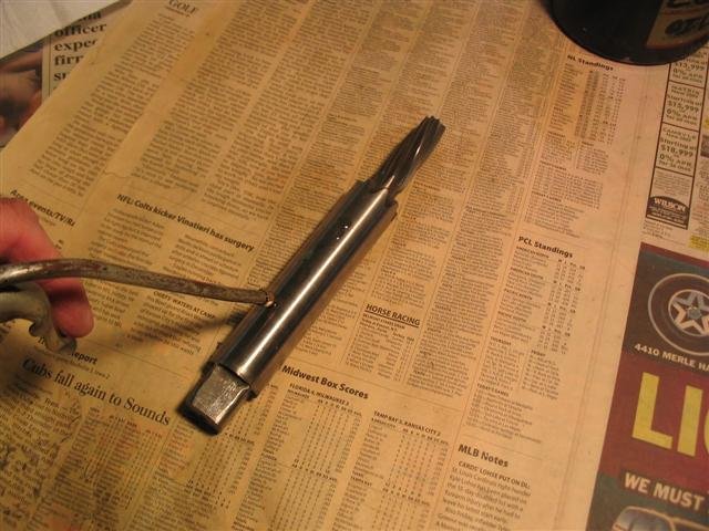

Clearance for the triple gear bushing should be .003, that is what Ford reamed them at by, Micing New Old Stock, drums, and triple gears.
Also, K. R. Wilson Reamers make a .680 hole for the pins. I have got one good used set of transmission Wilson reamers, and 2 sets of N.O.S., they all cut the same size hole, for what ever Bushings. The O. D. of the pin should measure from .676-50, to .677-00.
The new repro pins, some are all over in size. There two companys making them. One is good, other isn't worth the postage.
The good company, still has to be checked for size, they will very. If the pins need to be brought into Spec's, Emery strips, and a lathe, will do it.
Always Mic the old pin, where it pushes into the flywheel, your new pin should be .003 larger. If smaller, it may not stay, if larger, it may bust your flywheel.
If the brake drum bushing is not reamed in a Jig, chances are it is not as true as it could be, also the tail shaft. Tail shaft bushings can not be cut in a lathe, and have them align with each other, unless you have excess clearance. The picture of the triple gears, what broke them, they tried to run over the Driven Gear, to much slop, and or out of alignment.
If you don't get the brake drum bushing " WE HAVE ALWAYS USED JUST ONE " driving plate, in perfect alignment, you will get a heck of a vibration,
and it doesn't take much, misalignment.
Herm.

Well Glen, my new old stock tripple gears that came from Ford, already reamed, measure exactly, .680. The Wilson reamers are, an exact fit in the Ford reamed Tripple gear bushings. If Wilson screwed up, then Ford made the same mistake.
Yes I agree .002 thousandths, is to small.
Like ball caps, Ford cut all I.D.'s to 9/16's, or .562-50. At that size they will work fine, if cut at .002, they will some times smear, because when bolted to an irregular surface, they will twist, causing a bind.
We have probably rebuilt around 400 transmissions, all .003 clearance on the gears, never a failure, the same with 55 years rebuilding, babbitt bearings, knock on wood.

Herman, I also have a reamer that cuts to 0.003 clearance. I agree 0.003 is probably ok but not 0.002. But that still doesn't explain why Ford plainly said 0.002 running fit. Ford never uses this term anywhere else and None of the other Ford repair manuals even address this issue, only the Ford Service Shop Manual. No where can I find a plain definition of running fit, but I think my definition is logical. There are many who disagree but offer no evidence for their disagreement. Good hearing from you. Glen

Posts: 4084
Re: tripple gear bushings
Post by DanTreace » Fri Sep 13, 2019 3:44 pm
The Ford Service does mention the tolerance of the reamed triple gear bushings as a 'Running Fit' to the shaft of the triple gear pin.
That 'running fit' is one of the classes of tolerance for fits.
The Ford blueprints call out the tolerances of the pin and the reamed bushing
Pin shaft tolerance: .6770 -.6775' O.D.
Reamed bushing tolerance : .6785-.6790 I.D
So the tolerance or fit between these parts ranges from .0015 -.0020. That leads to a 'clearance' of .003" to .004".
These are the numbers that are successful for Glen and Herm and others, when done right with the good workmanship of aligning the drums and gears for reaming.
Murray Fahnstock with his Ford Power Plant chart of service ( I posted above earlier) listed .005" as "serviceable" but I can attest that .005" makes for a more noisy set of triple gears , as I had my last engine set for 'safe' clearance, but..oh boy. ;)
Found this info in The Automobile , 1916, to describe the classes of fits, you can see that a "Running Fit" is in the middle of the pack of precision fits.
The upper end of the chart is for shafts, the lower end of the chart is for bores, or the reamed bushing. The # on the left of the chart are tolerance units, if you look at "Running Fit" and look down on the lower chart you can decipher the range of about .0015" to .0035" or so, that is what Ford stated as the .002" running fit , it makes it on this chart in the middle of the grade for a running fit.
And listed definitions:
Fit in general denotes the physical correlation of two parts joined tog-ether, and is characterized by the clearance or interference.
Clearance is the free space between bore and shaft.
Interference is the amount by which the diameter of the shaft to be inserted exceeds the bore.
Allowance is 'the difference between shaft diameter and bore; it is positive when the shaft diameter is greater than the bore and negative when the shaft diameter is smaller than the bore. Positive allowance is interference; negative allowance is clearance.

But I do have a question about the triple gears in this "new" trans....
Yup, amazingly something that hasn't been discussed. When i pulled the gears out, I pushed 2 of the bushings out of the gears with my fingers. They were snug but they came right out. They each measured about 4-5 thou in terms of pin to bushing clearance (inside bushing minus pin). Aren't the bushings supposed to not come out of the gears? No abnormal wear patterns anywhere.
Jeff

Mon Sep 09, 2019 9:07 pm
sometimes they spin. Sometimes for years. There is all level of mechanics out there.
You will find the gear is likely now oversize in the bore. New bushings (Bob's) will be slightly oversize and should press in fine, anyway.

My plan is to send this set of gears to Dan M. to get the needle bearing setup. I'm assuming they'll work ok for that mod. Andy Clary recently came over and experienced my "hill" for the first time. He now knows why I want to go this route.

Through the years, I have found that more success is to be had in properly applying a specification to a given machining job than trying to guess what the confusing language was on a very old technology/drawing. If you doubt that, try applying old Trade Formulas used in watchmaking: One particular one I was interested in stated in part, you use Dragon's Blood as one part of a concoction for making a durable Lacquer for Brass. Even with the internet and 40 year's experience as a professional and now hobbiest, I still don't know what that is! " END QUOTE "
Scott, I am not completely sure, but if you were wondering what Dragon's Blood is, it is a Pigment, Blood Red, used in violin Varnish.
I used it mixed with shellac, to repair old worn violin finishes, after, repair. Not to be used on modern violin, gloss finishes. It would blend in to any color.
It can be had from any violin makers parts house.
