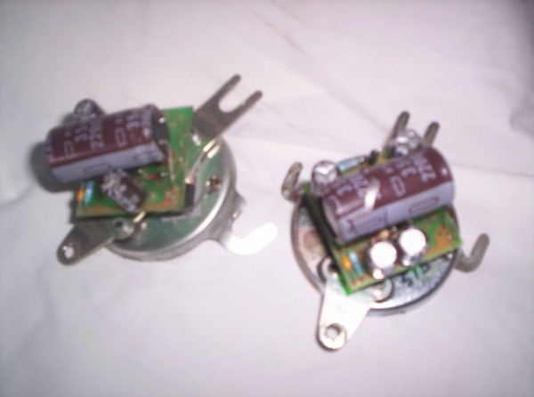

2 of my T's have generators and the only trouble I've had with them is the doide cut outs. one cost me a generator, a complete burn out and the other I caught in time when I saw the amp gauge go 100% neg. I'm sticking with the original type.

The diode cut out is not a voltage regulator. The one with the regulator is a full solid state voltage regulator. Have never heard of one failing.
- Posts: 1455
- Last Name: van Ekeren
Re: Vottage Regulator
I opologize for any confusion, my bad habit of always calling them cut outs, dug them out of the junk tin and as can be seen they are not just the diode cut out.
