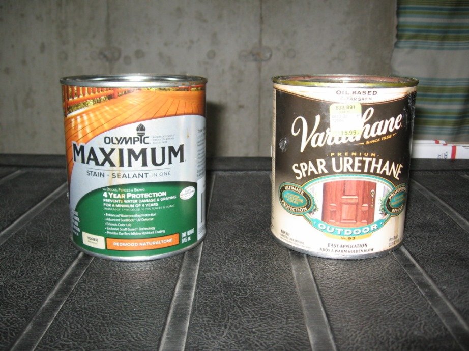

Here is what I used on mine - two coats of stain/sealer with light sanding after each, then three coats of exterior grade spar urethane with a light sanding after the first two coats.

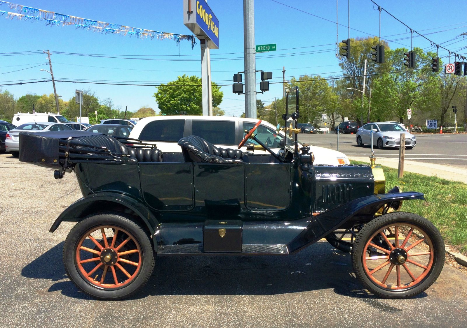

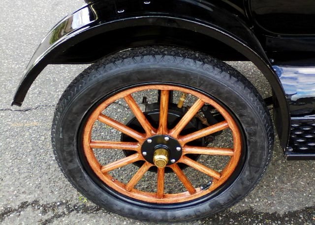

The above is what I did to get my wheels to look like this:

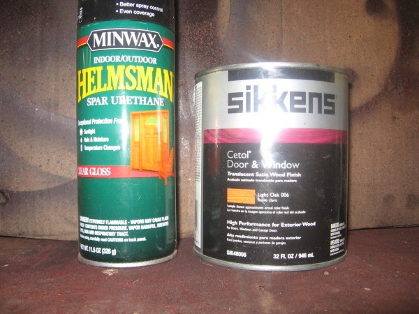

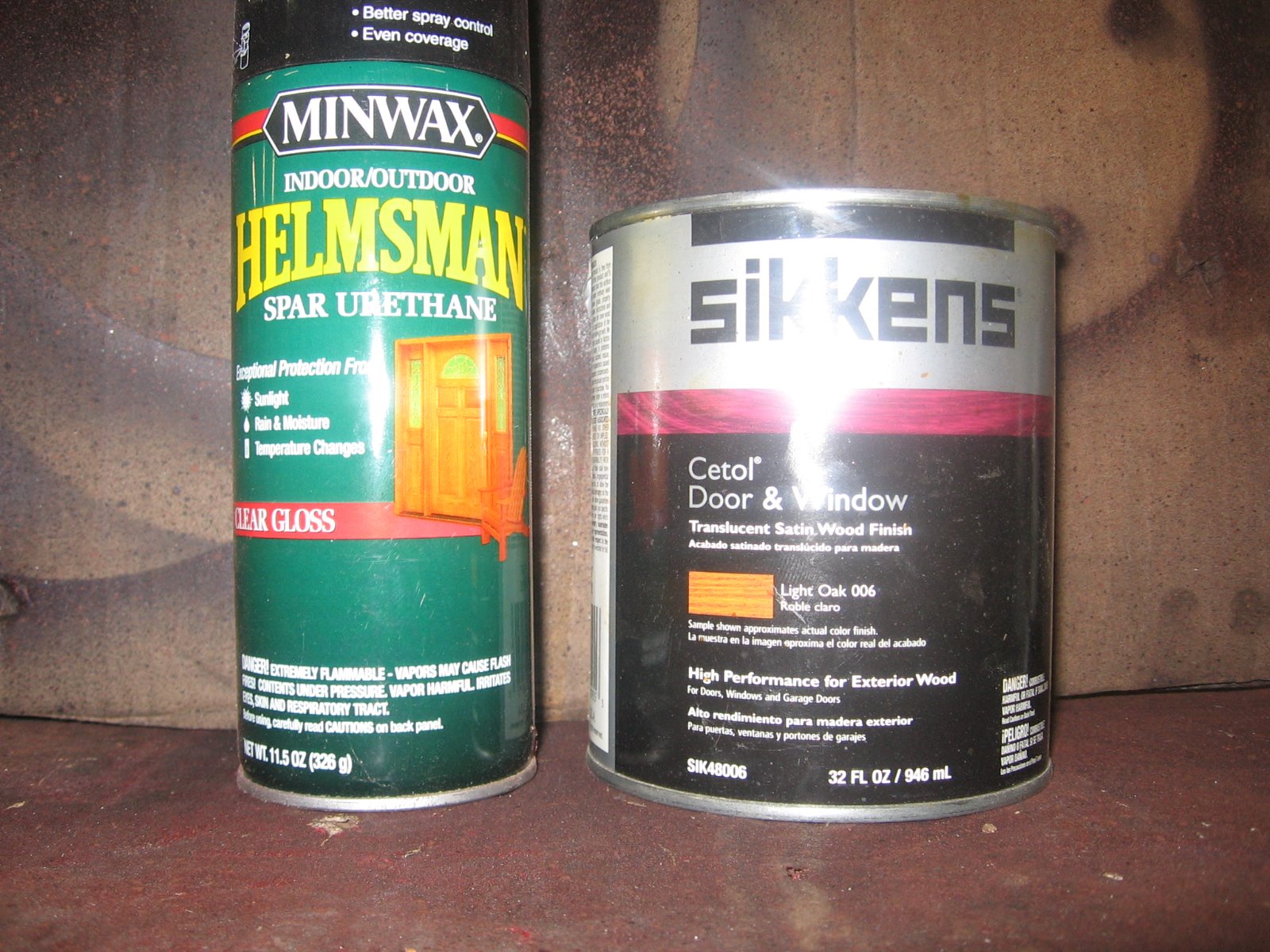

Here is another option. Two coats of the Sikkens Light Oak 006 and two coats of the Minwax have held up well for more than 10 years.

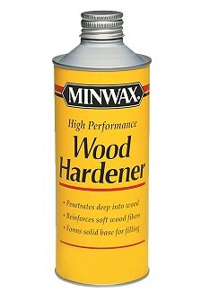

Don't be taken back by the description but you might want to consider using Minwax® High Performance Wood Hardener. While the product
was formulated to strengthen and reinforce decayed or rotting wood. It is a quick drying liquid that is absorbed deep into the wood fibers. So its not just an external layer. I did some old wheels (applied, let dry, sanded, reapplied, let dry and sanded). The wood finish looks great, I also have used Helmsman Spar Urethane in the past. Helmsman is a bit thicker so it doesn't get into the wood as much. Buy a can and try it on some scrap wood, following the directions. I think that once you see it being sucked into the wood you'll be convinced. You can always apply Helmsman over it after a sanding
