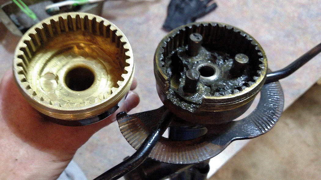

My first thought was maybe the steering box. There are three small gears held in place by three pins. One pin that is longer than the others that works as a steering stop. My guess is that the steering shaft is not lined up with the gears properly or the one long pin is in the wrong place. Just my guess of course but it is, at leased, someplace to look.
Mark Nunn
- Posts: 1289
- Last Name: Nunn
- Location: Bennington, NE
Re: Steering Issue Has Me Stumped
The long pin is indexed to the key slot for the pitman arm. Moving the long pin would put it 60 degrees from the keyway. The slot in the gearbox for '25, I believe, ends about 55 degrees from vertical. That would let the pitman arm move only one direction.Scottio wrote: ↑Tue Sep 17, 2019 11:51 pmMy first thought was maybe the steering box. There are three small gears held in place by three pins. One pin that is longer than the others that works as a steering stop. My guess is that the steering shaft is not lined up with the gears properly or the one long pin is in the wrong place. Just my guess of course but it is, at leased, someplace to look.
Maybe the gearbox was replaced and installed upside down. The slot for the locking screw would be at the bottom rather than at the top.
Another possible problem is what I found in my car. My gearbox had 4 broken teeth. If one of them fell into the gearbox, the steering would have locked up. I replaced the gearbox.
