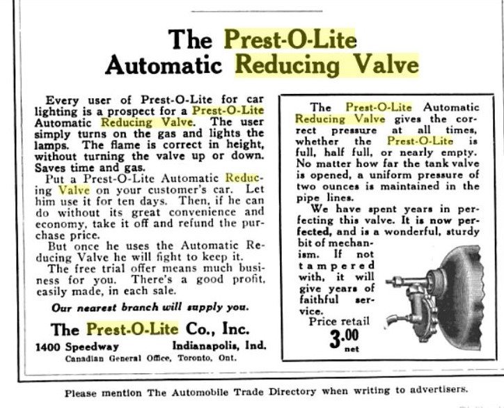

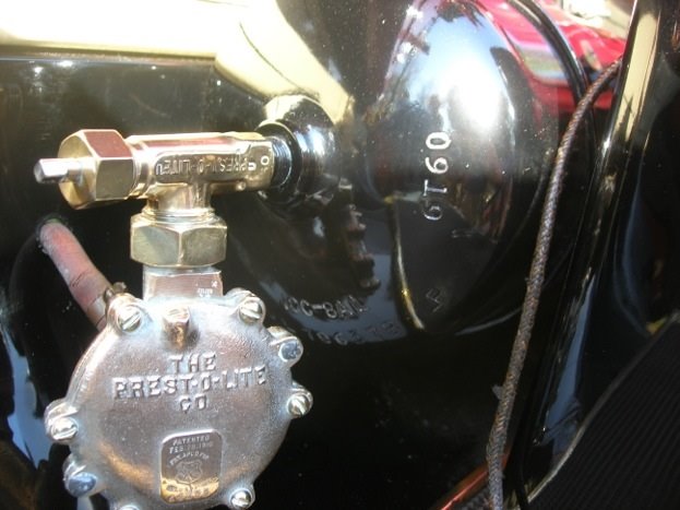

You do not need a regulator. Just "crack it open" about 1/8 turn. Lamps run on about 3 psi. The old "prest-O-Lite Automatic Reducing valve" was set at 3lbs. Most "Prestolite regulators" you will find today are set at 10 or 15 psi. Some are 5psi, but that is still too much.
-Keith

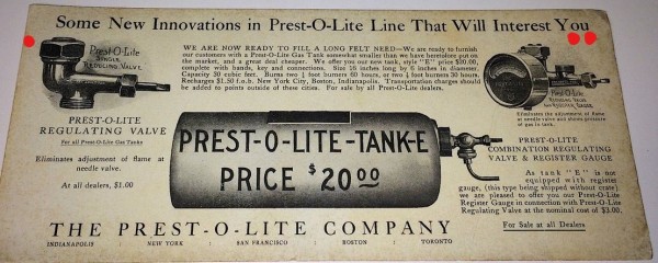

I did a lot of searching to find 3 psi specification. It does not appear in any advertisements that I found.
This looks pretty scary as it is NOT af offset tank designed to sit horizontally!
Here is a common Prest-O-Lite regulator that can be readily found. Ten psi is way too much pressure!

The ad copy posted above specifies that the regulator is set for "two ounces" pressure, which is more in line with my own experience. Other sources refer to two or three "inches of water column" pressure.

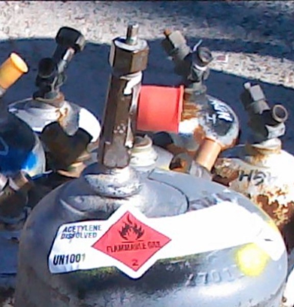

The 20 inch tank is called a "B" tank at the welding supply houses where I find a few Prest-O-Lite offset valve tanks mixed in with the regular tanks. They are not the old style tank with the pressure gauge on the bottom which can't be filled here in the U.S.

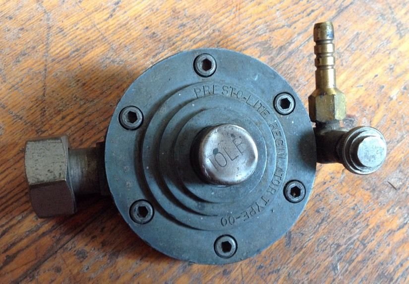

First Photo
Here are a couple more POL regulators to be on the lookout for. The one with the tank pressure gauge in working condition would be a real find! (Two red dots)

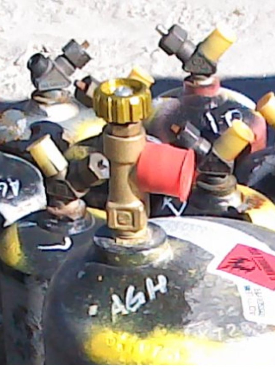

Second Photo-Fine Valve
IF you have a choice on Prest-O-Lite tanks at the welding supply, the "fine" valve is easiest to "crack" the old way without a regulator.
Third Photo-Coarse Valve
Knurled Knob is modern change out by filling house. I use this style with a Uniweld Regulator.

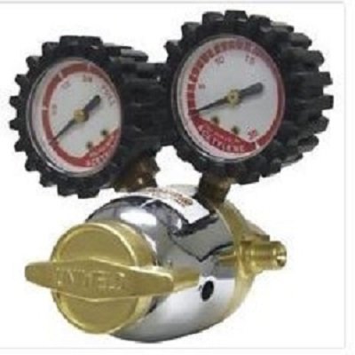

Fourth Photo-Small Uniweld Regulator

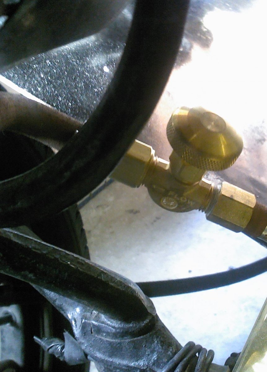

I use this one set to about 4-5 psi and a small acetylene valve at each headlight to set the flame exactly where I want it (Last Photo). This makes it a simple "light and go" by only turning on the "B" tank valve.
To turn them off, just close the "B" tank valve leaving the regulator and small valves where they are set.
Two minutes, or two weeks, turn on "B" tank valve.... "light and go". :)

UNIWELD REGULATOR
UNIWELD REGULATOR
Uniweld Regulator.jpg (32.12 KiB) Viewed 6078 times
RADNOR ACETYLENE VALVE AT HEADLIGHT

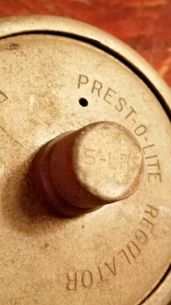

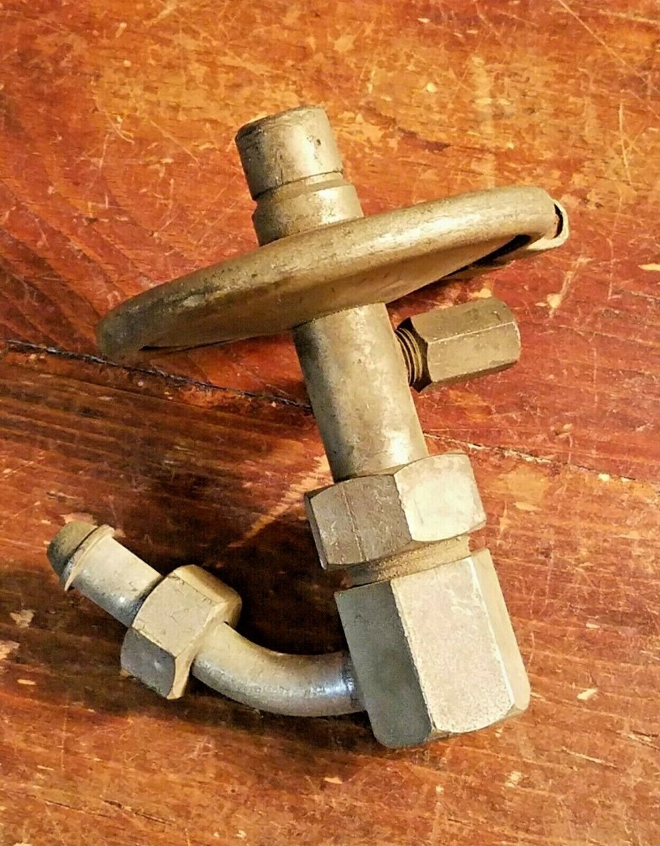

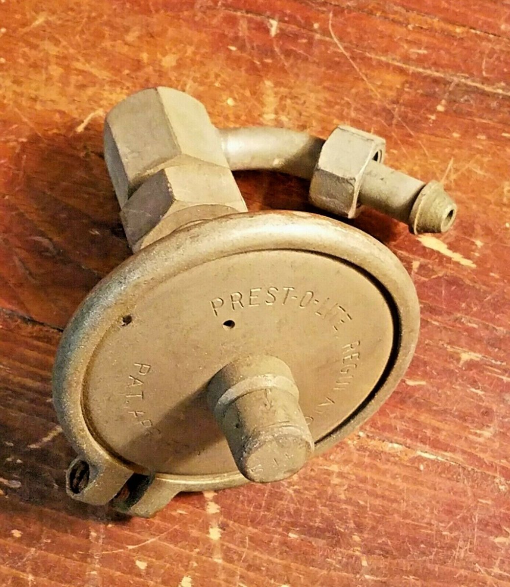

Would this work? Not sure what "5 pounds" refers to.
Bud Delong
Posts: 469
First Name: Kenneth
Last Name: DeLong
Location: Wheeler, MI
Re: Running Board Acetylene cylinder ?
Post by Bud Delong » Sun Sep 22, 2019 1:13 pm
My guess would be 5# psi permantly set which might be too much? Bud.
