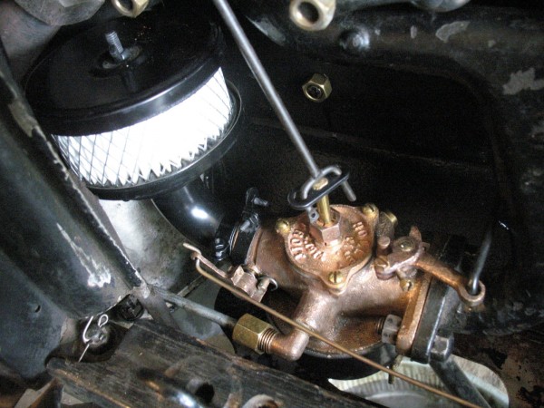

I thought I would share this. If you are not looking for originality and want to put an air filter on your T, look up..."BLACK FOAM INTAKE AIR FILTER ATV QUAD DIRT BIKE PIT BIKE 38MM BOOT on Ebay. They are only $6 plus $3 for shipping. I had to notch the clamp/rubber sleeve where the choke rod sticks out from the carb. I then re-curved the choke lever that hooks up to the pull choke rod to and, voila! Always wanted to put an air cleaner on, but thought the price was a little steep. Hope this helps you guys.
Posts: 7411
Re: Cheap air filter
Post by Steve Jelf » Wed Oct 30, 2019 2:39 pm
Mine is more expensive. About twenty bucks at O'Reilly.
It's mounted on a piece of sink drain pipe.
