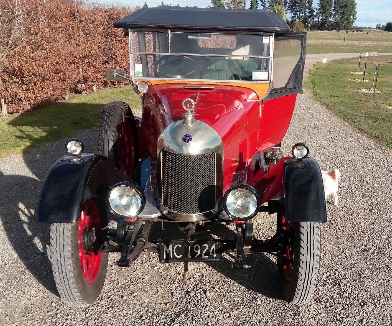

I have a regular 'rendezvous' with the nickel (and aluminium) in my 1924 Morris.
I found that metal polish works best BUT not all polishes actually work as advertised.
U.S.Brands are different to those we have in New Zealand, so naming a brand my not be helpful. It took me several attempts with 4 different polishes to find the one that works best - not all metal polishes are the same. The one for nickel barely marks the aluminium and a third one works best on brass.
Read the labels carefully and select one that particularly mentions nickel (might not help as all 4 I tried did). The one I have that works has a light blue tube - all the writing has fallen off it and I can't recall its brand name - I buy it by the colour!!
A good polish will restore even very tarnished nickel to a bright gleam, use a soft cloth. The only thing to be aware of is that depending on how thick the plating is, you may soon arrive at the copper layer or the underlying metal faster with some parts than others if it is really badly tarnished.
With a fairly 'new' component like yours that should not be a worry, but start with an area in a less visible location first.

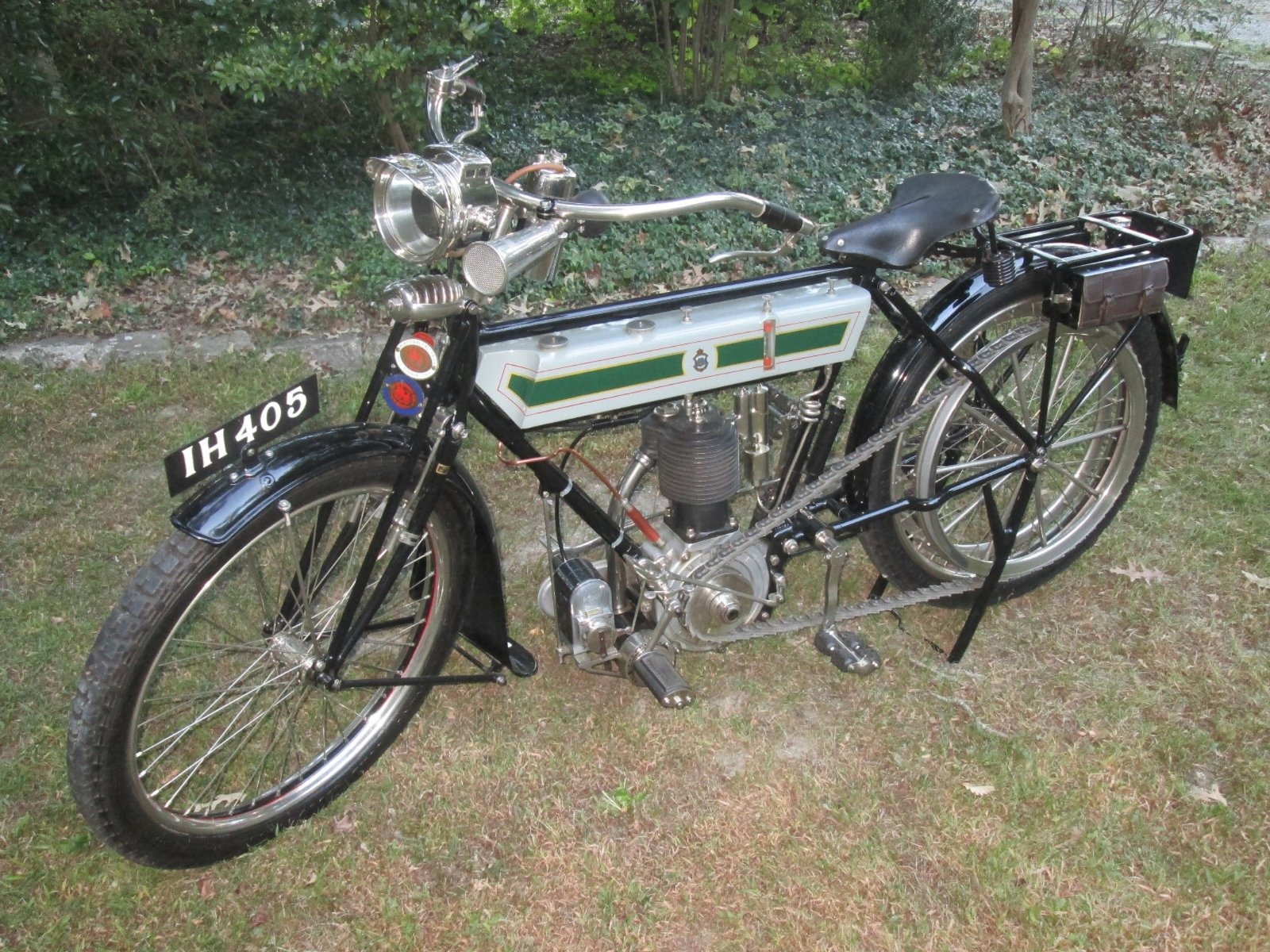

I've used nothing but SemiChrome on my 1912 Triumph motorcycle.
Terry
Terry

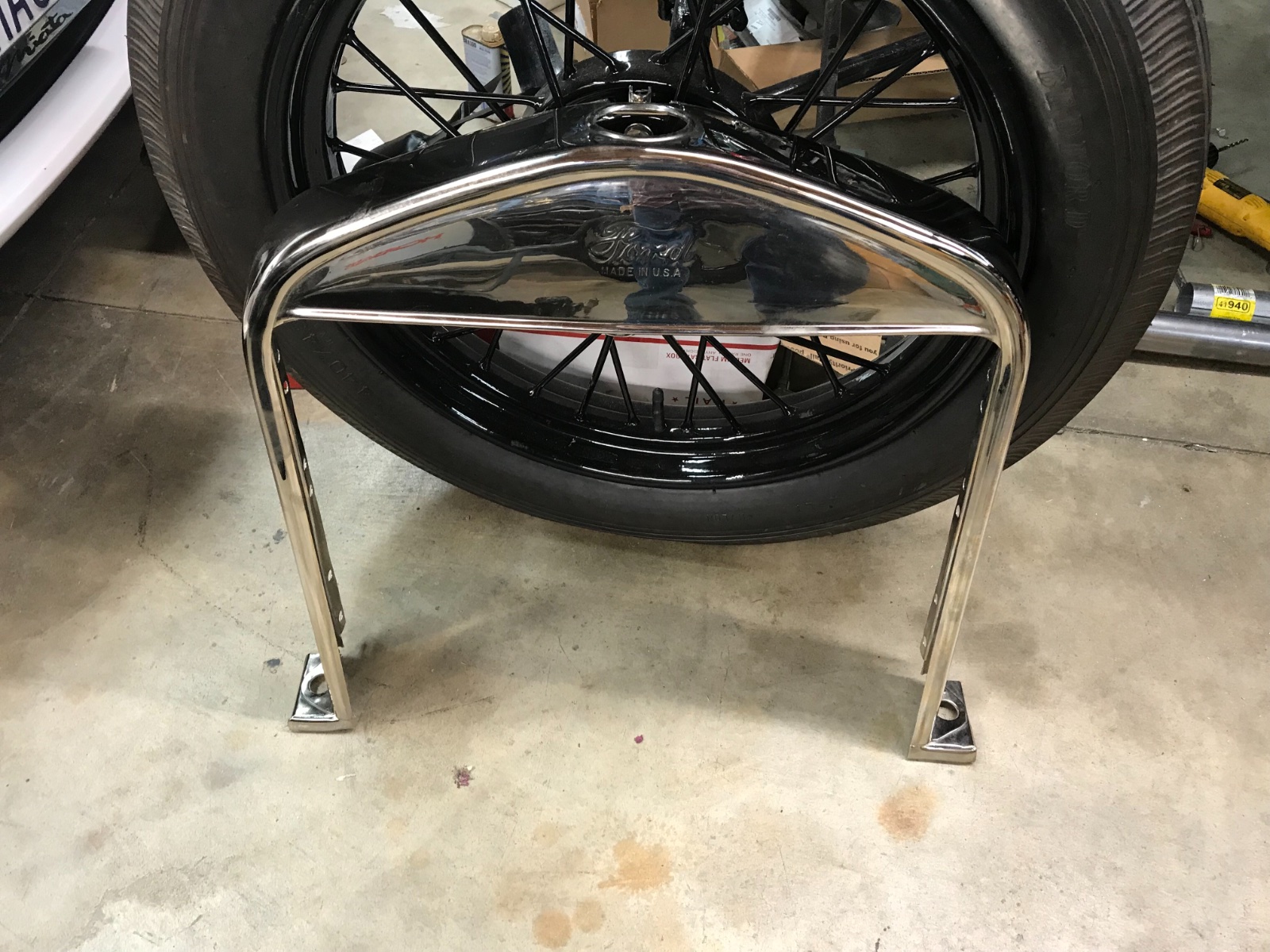

Just a follow up on stains on my nickel radiator shell from duct tape . I tried a few products but the stains remained . Then as suggested I looked for a product that mentioned Nickel in its line up of metal it would clean. I tried Flitz Metal polish an it removed all the stains in only a few minutes. The shell looks like new again. Thanks for all the suggestions.
