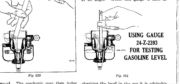

In researching Holley G float adjustment I came across these diagrams.
I wonder if anybody here can ID the source publication.

It's from the January 1st, 1920 Ford Service Bulletin

I was wondering if you are looking for the carb tools shown in the illustrations? I don't have them but If anyone has a pattern to reproduce carb tools it would be most likely of great interest. It is not my intention to tread on your thread but just saw your trip post and you had what I am going to assume poor gas mileage and the carb has become a point of interest.

There is a third diagram that goes with those two. It's a drawing of using the low speed tube clearance gauge 24-Z2390

Most of that Jan 1920 Service Bulletin, on MTFCI hompage historical document tab.

Thanks, Dan. I didn't realize all the service bulletins were online in PDF. That is great. Now I wonder if anybody has the measurements for the 24-Z-2393 tool so a body could make one. I doubt that anyone is making a repop.

Steve, the fuel.level should not change with a different float. The dry level setting will change due to differences in buoyancy of the different floats, but the fuel level spec will remain the same. Example, if the float is heavier it will ride lower in the fuel giving a higher fuel.level for the same dry setting. If it was suppose to be 1/2 inch of fuel in the well, it will still be 1/2 inch. Hope this made sense.

Also, I the correct fuel level is much less than 1/2 in and is measured in the bottom well of the fuel jet seat. If the level is a bit too high, it will dribble out the bottom through the high level overflow tube. This tube sticks about 1/16th inch above the base of the inside of the carb body. If it gets beat or ground down the carb won't run right and may leak more.
The 1/2 inch reference is more likely the starting measurement for the distance from the flow to the body flange when it is held upside down like when the NH is checked. However this is only a starting point, the level must be set per the specification as the level in the jet bowl.

Watching this closely as I have the same diagrams along with Mart's drawings but no idea where I found the diagrams...
