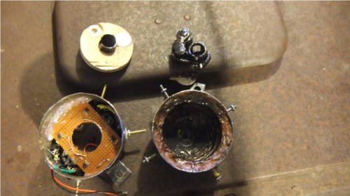

Now what would be really controversial? An E-timer!

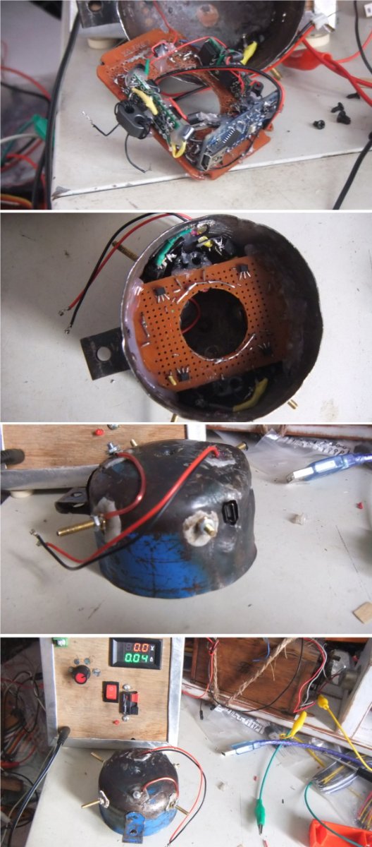

So I made my own. Just to make people mad.
It's an arduino. That they use to teach programming to children.
And a few hall effect sensors, and MOSFETs.
Timer, old versus new.JPG (34.62 KiB) Viewed 5332 times
It runs, it drives.

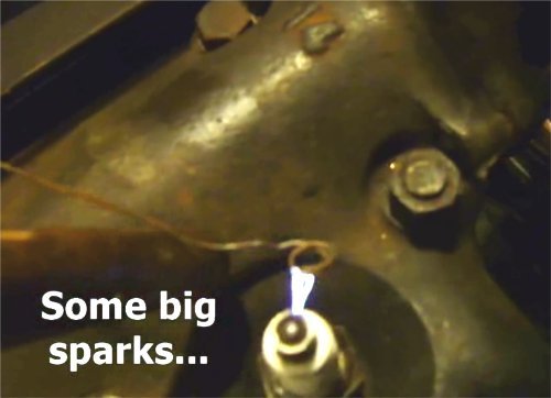

For coils I used old decaying ones that had open secondaries and no points at all. Nobody else thought they'd amount to anything. Work really well after all.
big sparks.jpg (24.7 KiB) Viewed 5332 times
Never ran so smooth.

Excellent! Just curious - why MOSFETs instead of triacs?
