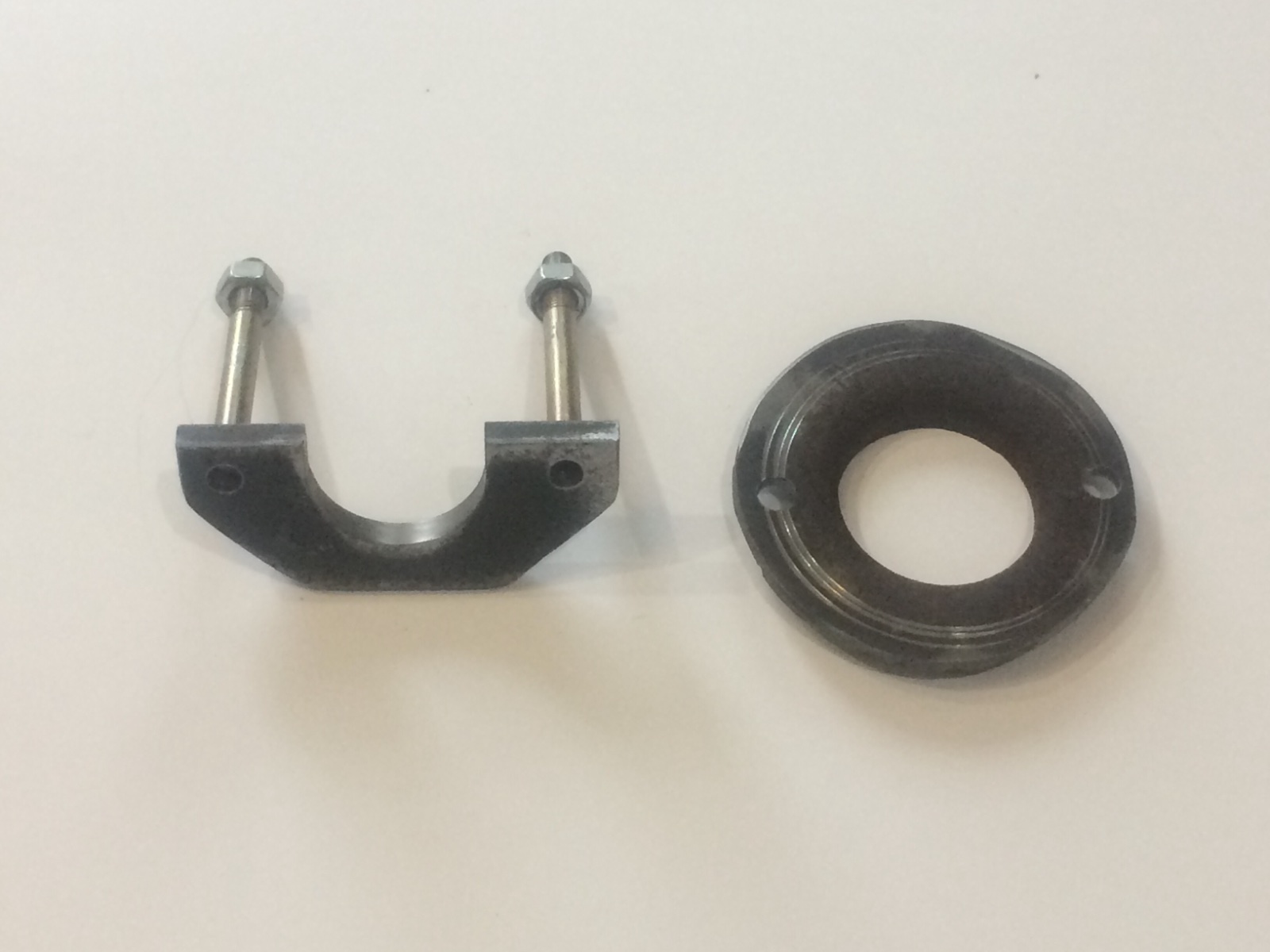

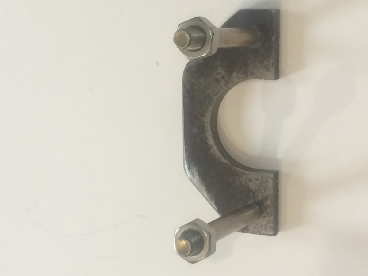

Two bolts two nuts and some scrap iron.
What does it make?

Crankshaft timing gear removal/installation jig.

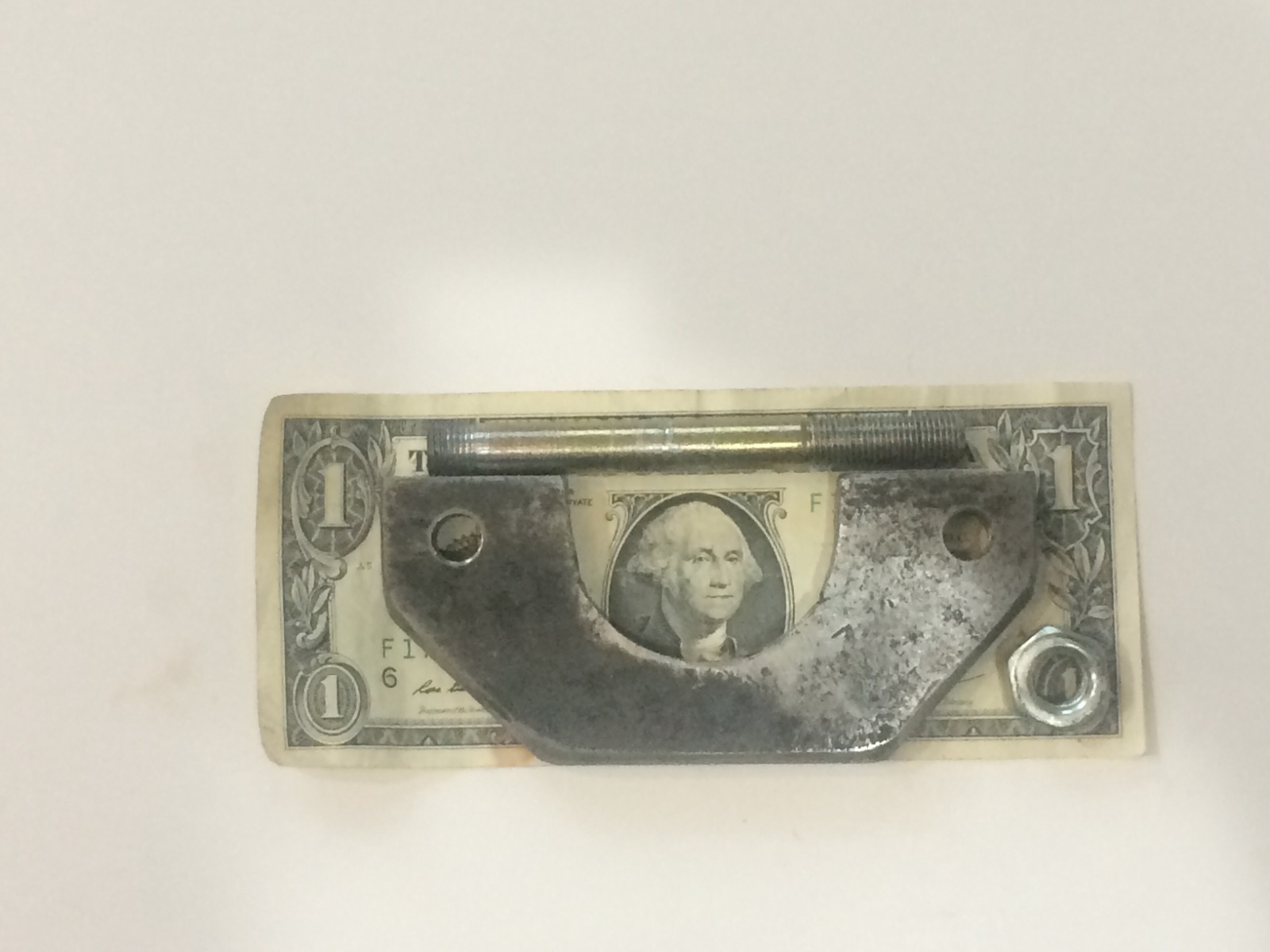

Dean,
How about a scale or some measurements?
Dom
D.Yoder
Posts: 263
Joined: Sun Jan 06, 2019 2:50 pm
First Name: DEAN
Last Name: YODER
* REQUIRED* Type and Year of Model Ts owned: 19tour,24tour,25rdpu,27rd.26coupe,TT's,& tractor conversions
Location: Iowa
Re: Scrap iron
Post by D.Yoder » Fri Sep 27, 2019 6:58 pm
Scale

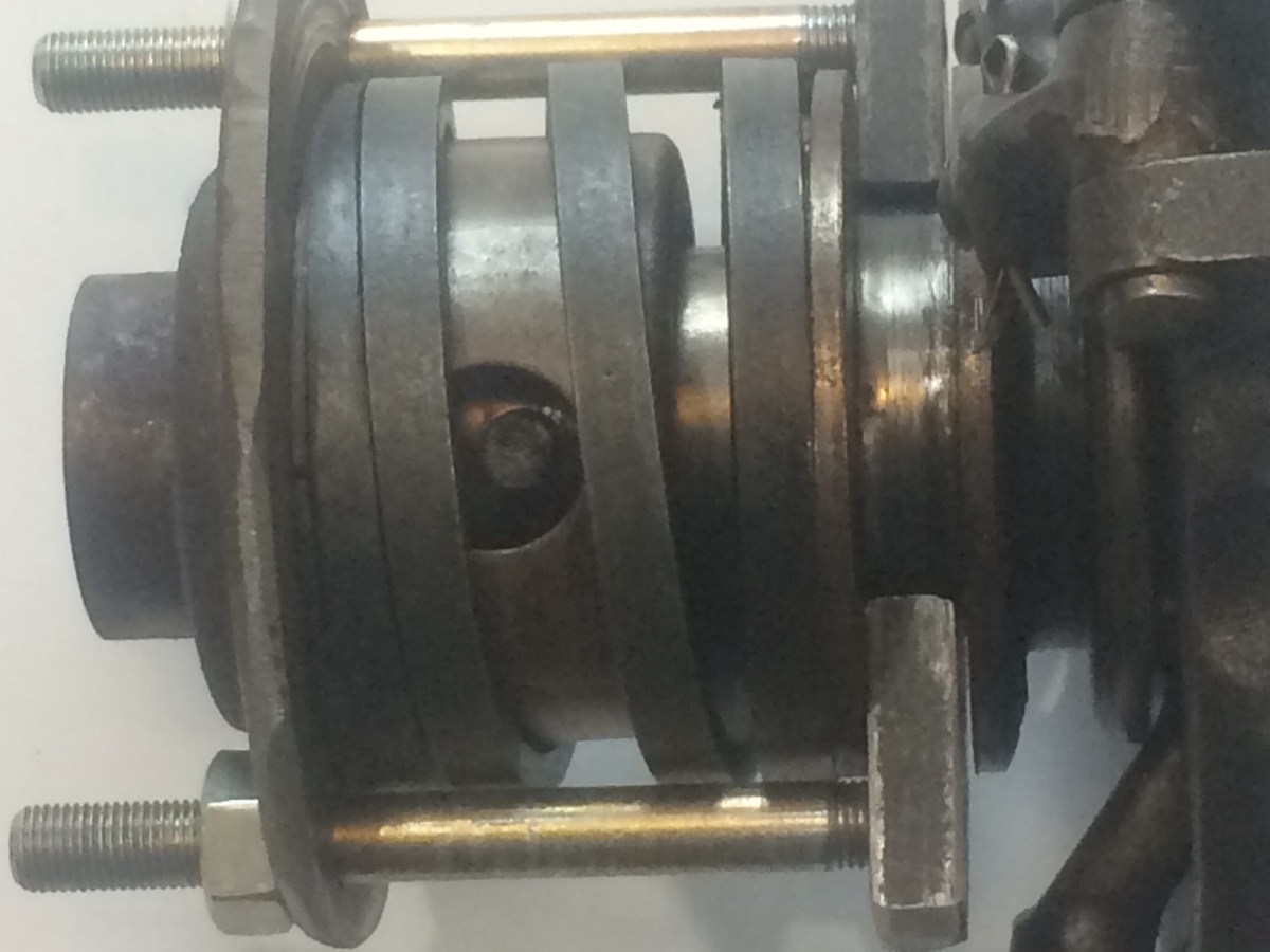

Clutch spring compressor

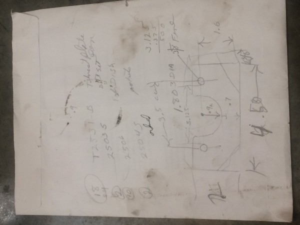

My pencil plans if you want to make one :D

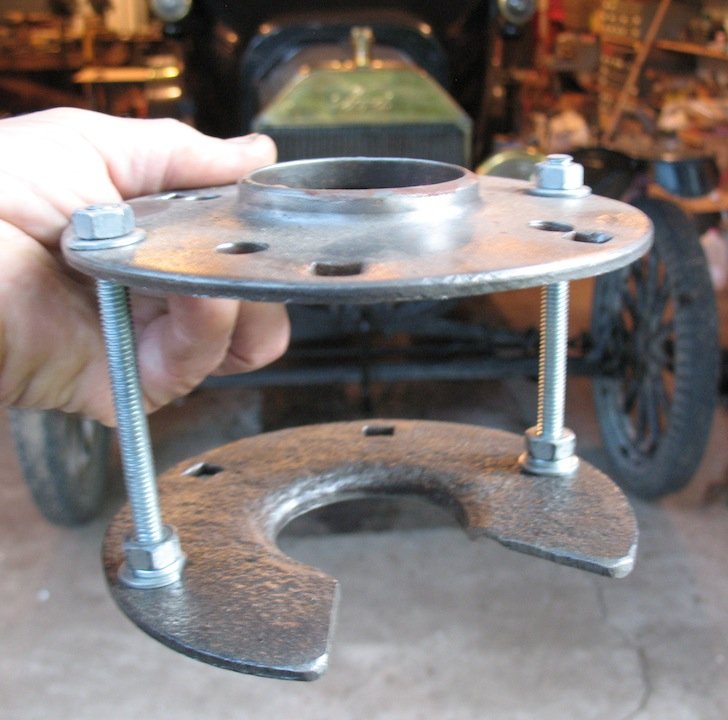

Post by Steve Jelf » Fri Sep 27, 2019 10:11 pm
Another version uses scrap hub plates.

Steve that is what inspired mine . Can’t remember where I put it. Mom said getting old isn’t for sissies! :x
